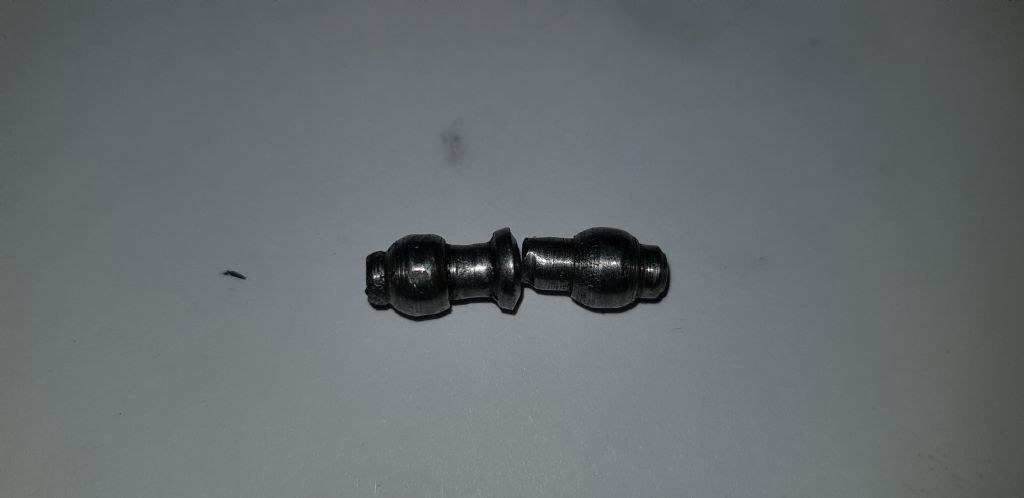

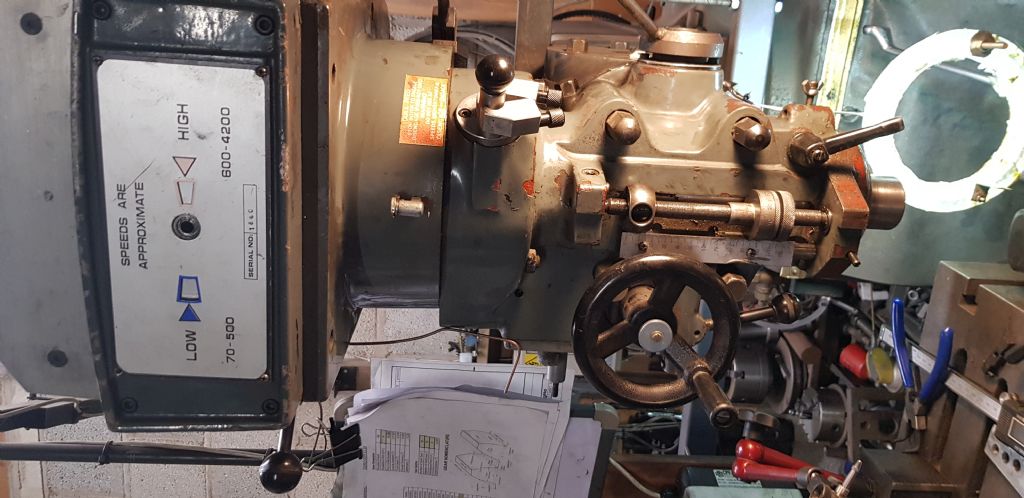

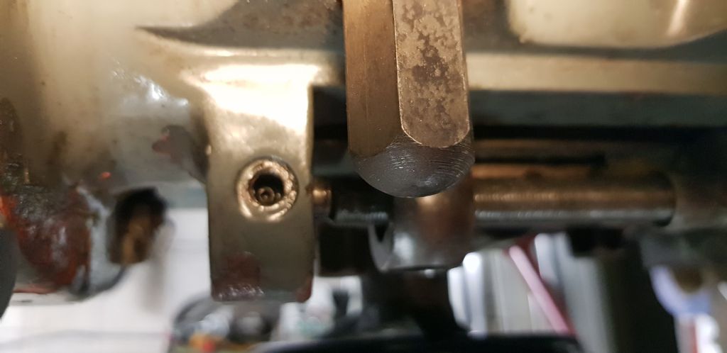

        I need to get the spindle bearing assembly out of my quill to nip up (or replace) the bearings… It's similar to a Bridgeport but always some slight differences..
        I need to remove the depth stop rod, because the socapex securing the depth stop eye into the quill also secures the top of the spindle assembly.
        I have the lever of the bottom of the depth rod easily, but can't work out what the widget is at the top? (and then how to extract it)
        Anyone ever dismantled one?

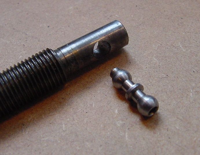

            The part at the top of the trip rod will look something like this,
            It is the reverse trip toggle. there should be a threaded hole in the end into which you screw a threaded bar to pull the toggle out.
            I am missing mine so if you take it out, can you take some measurements and post on here
            Gray

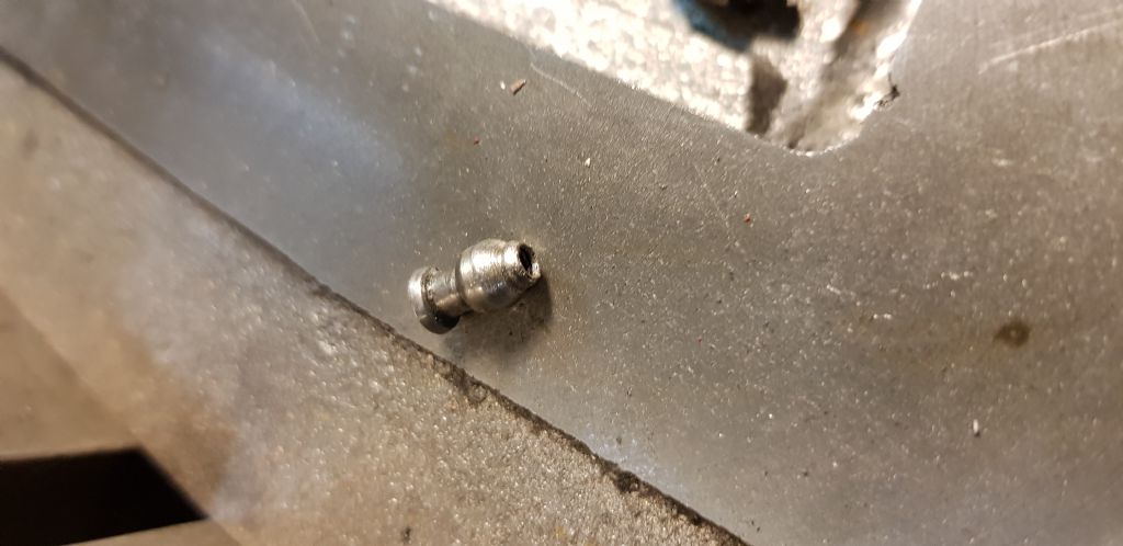

              Now I know what it's called,I've worked out what it does… It trips the feed if you drive it to the top…
              The short pin is pushed up by the eye attached to the quill, and the toggle pushes the screwed rod down to trip the feed… (it's a toggle to reverse the direction…)
              I've got about 1/2 of it out, after a lot of faffing with some ground down mosquito forceps…
              I still can't get the rod out because the last bit of the toggle still jams it, got a 4mm Neodium magnet rod coming on Monday which hopefully will get it…
              Michael, the nose piece has been butchered, prior to my ownership, and it seems was held in with araldite and the grub screw. I've built up the thread (looks like M74x1.25) with silicon bronze and will attempt to cut a new thread.
              The spindle assembly (sadly) shows no sign of movement, but will keep trying…

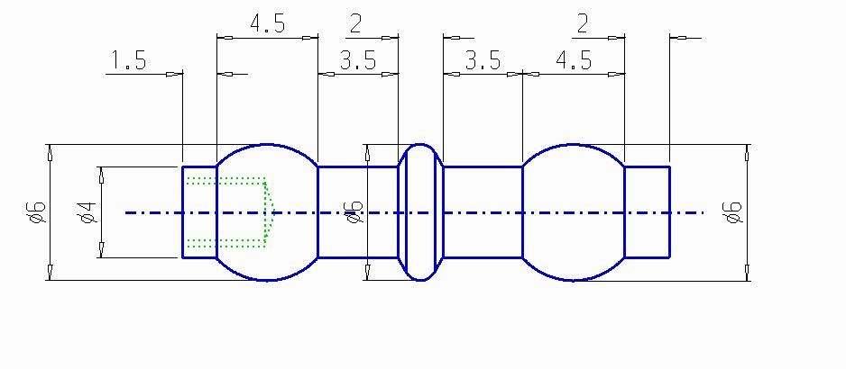

                  After considerable faffing about I got the other part of the toggle out using a 4mm dia magnet… The depth stop rod fell out and I was able to remove the eye that bolts into the quill. Photo and Sketch below… dims are approximate it's fairly mangled (not all by me!)
                  48 hours later I've got the spindle out; using Plus gas inserted through the hole in the quill and a M12 threaded rod with a tube on the bottom of the quill as a puller… It was stupidly tight, but I got it out without damaging anything… The video says " a gentle tap with a brass drift"
                  New bearings ordered and need new thread on the nose piece, more pratical now I can properly measure the thread inside the quill.
