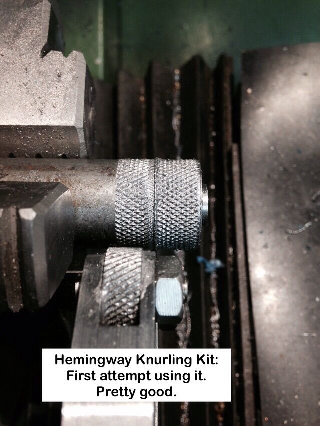

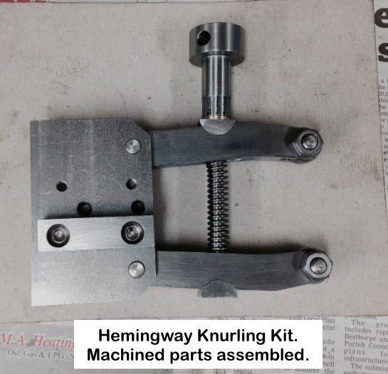

          Nick,
          Experiment on a scrap piece first as you may need to adjust my method.
          My technique using Hemingway kit I made is as follows, with lathe running:
          1) Wind Cross-slide forward until knurls are centred over workpiece, then turn the screw until they make light contact and just start revolving,
          2) Wind Cross-slide back,
          3) Give the adjusting screw 1/8-1/4 turn
          4) Slowly move Cross-slide forward forcing the knurls onto the work until centred, then another 1/4-1/2 turn
          I find that this method ensured the knurls are in sync and produce perfect knurls as evident:
          Hemingway Knurling Kit

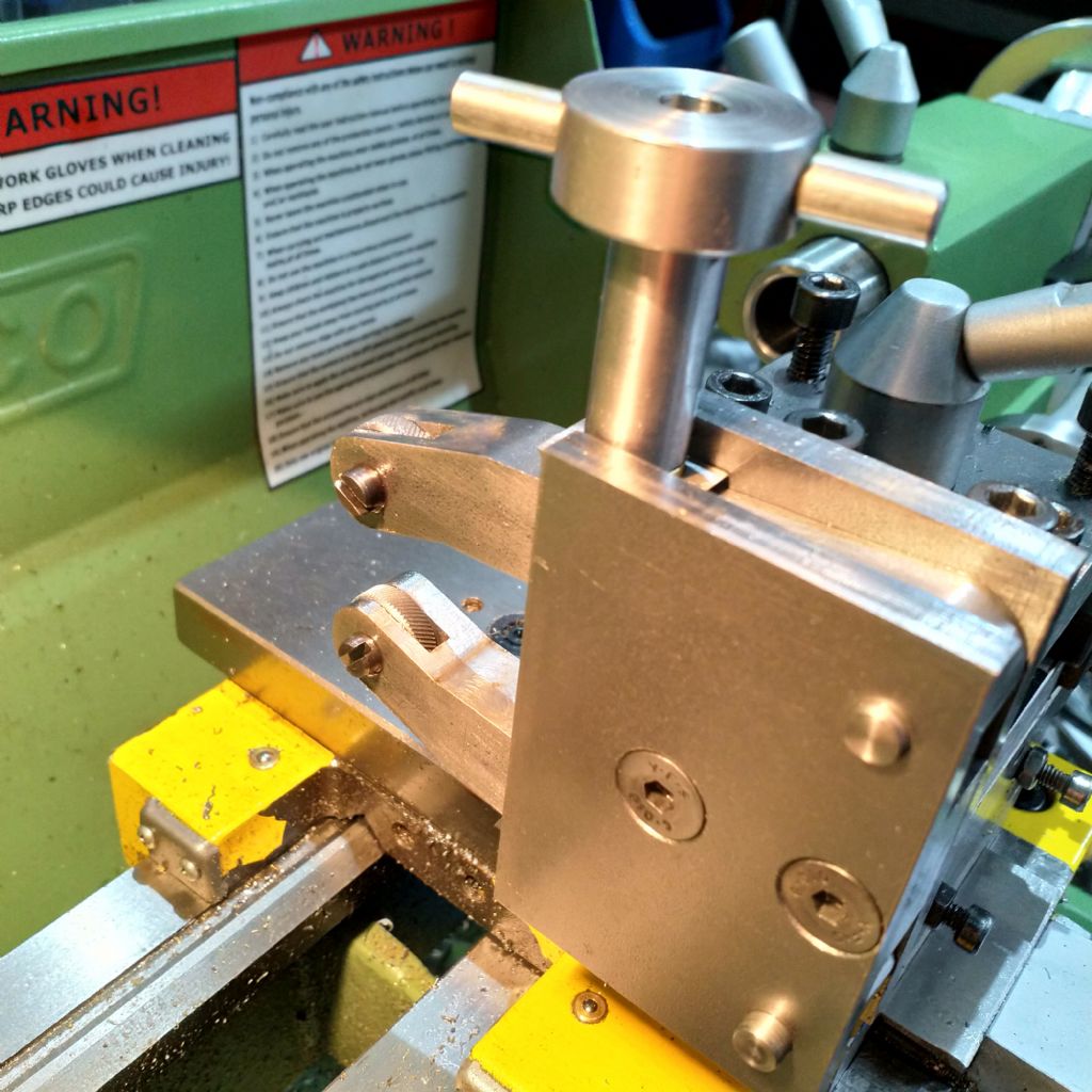

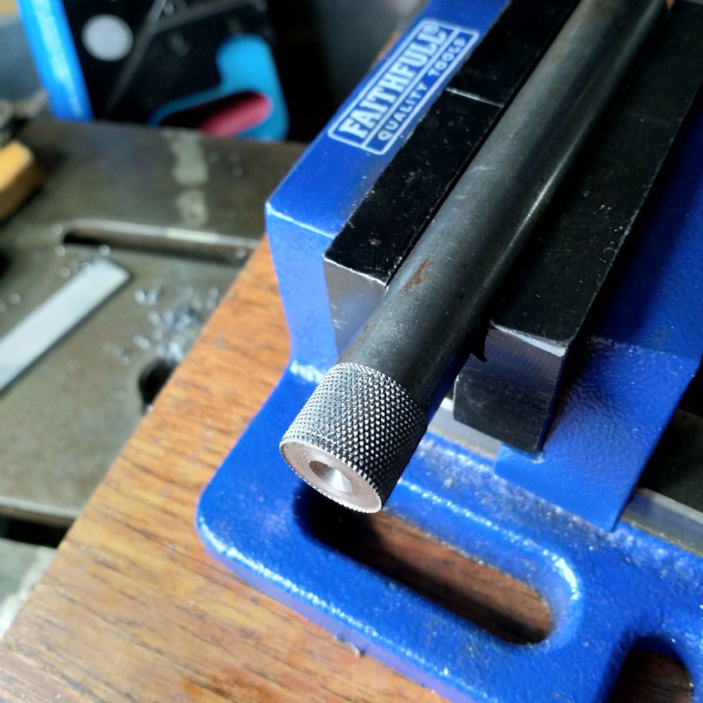

                                        Hi Nick. I'm not sure your knurling tool is assembled as per the drawings, or maybe you need it that way to fit your lathe. I have just completed one of the hemmingway kits today that I got for Christmas.
                                        Mine looks like this and I'm very pleased with how it performs. I can now move on to the rotary table kit I got at the same time

                                            #522514
                                            OuBallie
                                              @ouballie
                                              Simon,
                                              Made mine to the drawing but then wasn’t at proper height, hence having to fit the tool post mount lower, or a woopsie, but I no longer remember🤗
                                              Geoff.

                                                Simon Barr
                                                  @simonbarr48213
                                                  Posted by OuBallie on 25/01/2021 13:34:22:
                                                  Simon,
                                                  Geoff.
                                                  Geoff, as long as it works it makes no difference does it. My memory does that to me sometimes too, more frequently these days
                                                  Simon
