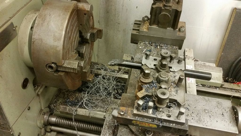

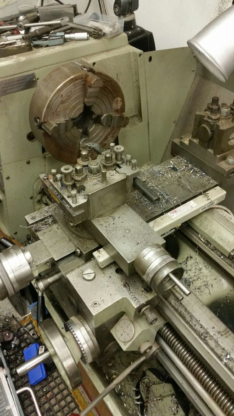

      Looking for a bit of advice on keeping the lathe and surrounding areas clean. Usually sweep and vacuum to pick up majority of swarf but there is still a lot of smaller stuff which stays stuck to various surfaces particularly if using cutting lube. I don't want to wash down with solvent/kerosene or other cleaners if possible. Although the lathe has a drip tray underneath it has no drain hole, so any liquid used to clean would need to be mopped up when finished. What do others do?

                                        Thanks for the replies. After picking up the bulky stuff i've been using an old paint brush followed by the vacuum cleaner for a final clean, but on the old lathe (1920's vintage) the coarse surface of the cast iron seems to trap a lot of the finer residue. I've been using thread-cutting lube in a pressure-pack can for turning stuff that needs lubricating, so i might try using that as a cleaning spray as well, but it's a bit expensive.
                                        Maybe i should strip the lathe down and repaint it so the unmachined surfaces are a bit smoother and less likely to collect grime. Sounds like something i could possibly do over the Christmas holidaysindecision.
