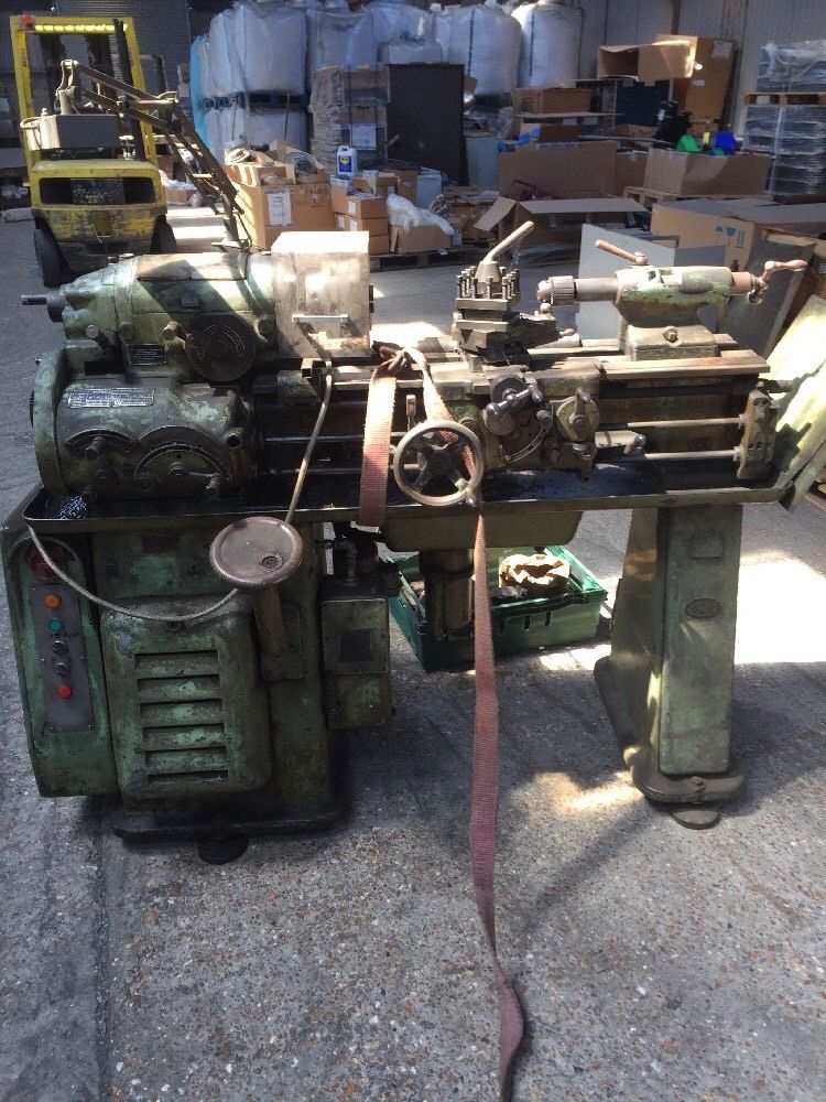

      I have a new lathe, finally obtaining a German Karger DL-1/53, tool room lathe, one of my first loves when I began looking at lathes – the only one I saw before this one was unaffordable at £1500
      These were made 1950s/'60s, to some degree sharing styling with Smart & Browns, and Holbrook C10s
      It came with lot of extras, fixed steady, almost all its change wheels, and five cam-lock chucks
      With a variable speed motor, on a mechanical selection method, its selector stalk is similar to a CVA
      I think it has a top speed in the 1100s
      It has a three phase motor, a full coolant pumping system, and an externally mounted oil tank and pump (it is the square box to right of the headstock plinth
      It needs some work, but is in basically pretty good order, under the oil and grease
      Does anybody out there own another Karger, or has owned one in the past? I am trying to set up a Karger Owners' Club
      Karger, having an umlaut over 'a', pronounces as Care-grrr
      Here she is, bought out of a warehouse in Wisbech
      With twin plinths, astonishingly, for a medium sized lathe, it has a 3 MT tailstock quill

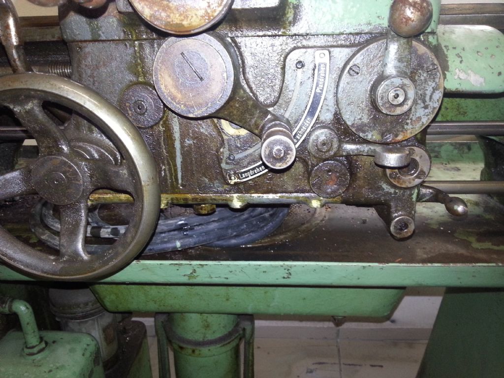

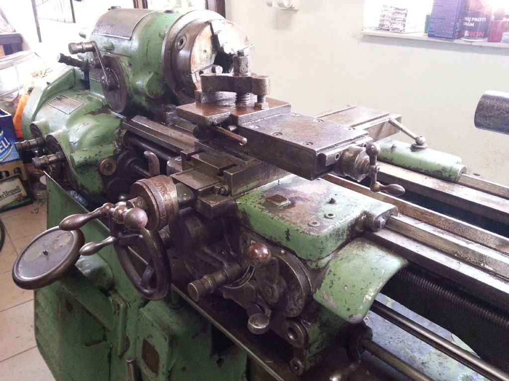

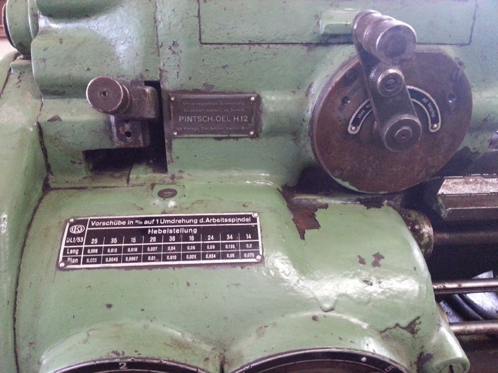

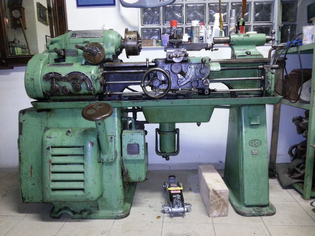

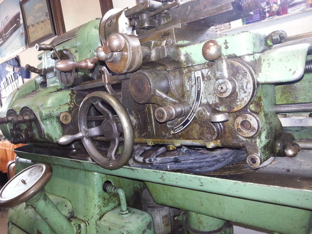

                          20161020_100552.jpg20161020_100616.jpg20161020_100606.jpg20161020_100655.jpg20161020_220439.jpgHi Chris,
                          No worries. I'm happy to see the thread is still alive.
                          I'm posting some pics of my DL1. It's a barn find, oily rag condition, however, the general condition doesn't look bad at all. The ways are a bit rusty, but it can be cleaned without any greater effort (I've already tried it). There was a mulfunction on a cog wheel in the apron which supplies torque for the power feed. I've already made a new one (I think the original bronze wasn't too strong for the wheel, hence the grinded cogs, so I used alluminium-bronze alloy instead, which is really tough; it should be good now).
                          My plan is to do a complete overhaul of the lathe, painting (returning it back to the original grey colour), change all bearings and mainly scrape the ways (I need to measure it properly first though).
                          I think every DL1 really deserves some serious TLC as it's a really beautiful, well made and very precise lathe. I really love the machine.
                          Apart from this DL1, I have also a DL3 which is a big brother of our DL1. It's a very nice machine too. Heavy and firm, pleasure to work on.
                          I definitely do not want to claim that I know a complete history of Karger company (which I really don't), but my knowledge tells me that Karger was nationalized after the II. WW, since it fell into the Russian ocupation zone and was turned into a WMW company – an Eastern Germany company. As far as I know, Karger didn't exist after the WW II anymore.
                          I really think that your Karger DL1 is a pre-war machine. Do you have any production plate on your lathe telling the year of production?
                          My DL3 is in fact a Karger DL3, but it was made after the war, in 1953 (it has the plate), but it's already full WMW product. It looks exactly the same as a pre war Karger DL3 though. They had just changed the badges, and that was it. Otherwise any respective part of the lathe is completely interchangable with the real Karger DL3's parts. It even carries a similar name: WMW DL3.
                          I can offer a Karger's production catalogue in PDF format, if you were interested. It's a catalogue from right before the war. I'd be very interested in DL1 user's manual. My catalogue describes DL1 generally (dimensions etc), but it's not a manual (no maintanance instruction etc).
                          I'm up for setting a Karger club up! Count me in!

                            Many thanks – yours is virtually identical to mine, and these, I believe, are late in the production order
                            I do not have the covering shroud to right of apron
                            My lathe's plate, too, reads "DL1/53"
                            What might be the curved cut-out at base of headstock plinth? Mine has this, too
                            There is some company material in Berlin Archives
                            Mine is in the same green, but originally cream, to which it will go back

                              Sorry, I have just noticed that our respective compound slide housing and tool posts are completely different
                              Mine has a four way tool post with a ratcheting system, which enables quick change from one side to another
                              Chris

                                The difference in our tool post is just a bit different accessory that our lathes were equipped with, based on demand. I have the old fashion, a single tool clamp because my tool post is the excetrical one which is very convenient for thread cutting. This specification didn't offer the ratcheting four position tool post, as you have. It just enables you a very quick move of the tool out of the cutting, returning back at the beginning of the thread (or anything else you're cutting) and then you engage it again. I have it pictured in the catalogue I told you about. Both our version are correct.
                                I don't know what exactly you mean by the curved cut-out … Do you mean the cut below the lever next to the Pintsch Oel schield? The lever that changes the direction of the auto-feed shaft rotation, is it what you mean?

                                  The cut out I mean is right at floor level, left hand side of front headstock plinth, there is a semicircular cut out, as if something ran through it, a pipe or cabling
                                  It seems to be a feature of Karger plinths, and I cannot imagine what they were for

                                    Now I understand the cut … To be honest with you, I have no idea what it's for. I just know that it makes it more complicated to roll the lathe on the bars when moving it . The same cut is on my DL3 on both legs, just on the outside part of them. Really don't know the reason.

                                        Perhaps the twin cutouts on the legs is to facilitate resting on axles (with wheels) to help with moving, much like machine skates?

                                          Many thanks – brilliant thinking – I am sure you have the right answer here, because there is another on the tailstock plinth, which runs in the opposite plane, so that you could wheel it around – presumably, the carrier wheels would have been castors?
                                          Perhaps, it would have been a simple cruciform shape – a cross of two scaffold poles, and three castors?
