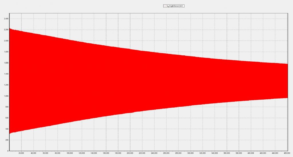

Did a few runs today and logged data to calculate Q – Not impressive, but I think definitive.
The Processor reads data from – Angle sensor (sinusoid), Angle Peak detector, and all the temperature sensors, humidity and pressure. The angle and peak detectors are sampled at 200Hz and can be logged at 200Hz, 100Hz, 50Hz, 20Hz and 10Hz. 200Hz fills large files fast…
With the pendulum running and the control loop stable, the drive voltage to the drive coil was then disconnected and the pendulum angle data logged at 50Hz.
This plot is 2-1/2 hours of data at 50Hz. The data was analysed at the points where the amplitude had fallen by:
61% – Q = 12000
50% – Q = 12400
31.8% Q = 14514

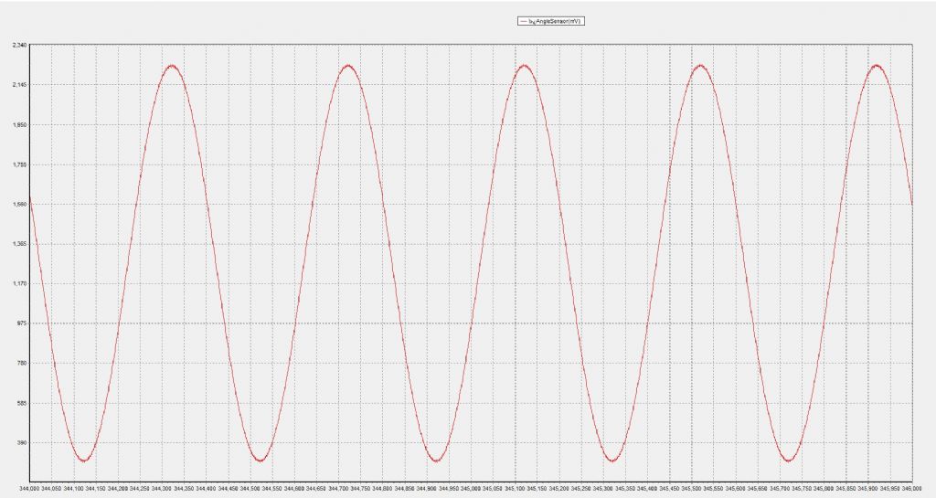

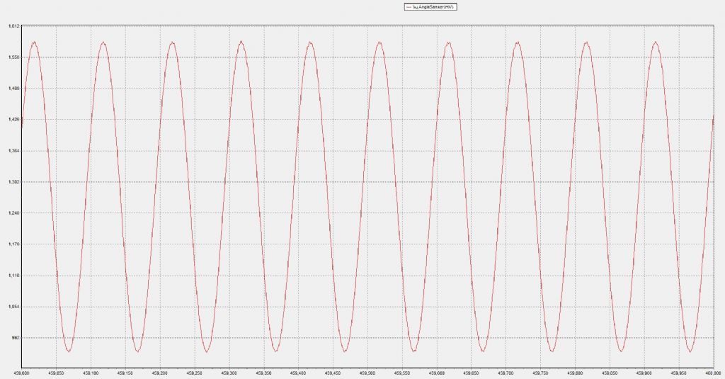

The sine wave from the angle sensor looks good, sampled at 200Hz. The sample artifacts at 50 Hz are quite clear in the posted examples below. The 200Hz sampled waveform will be used to generate the digital 90deg phase shift to the coil drive, in due course.
200Hz sampling and logging
50Hz Sampling
With the 'knife-edge' pivot and efforts I put in on the Bob format, etc, I would have thought I should achieve a better Q than it appears, although my expectations are/were biased by what others have been saying they have achieved – I will placate myself somewhat in the belief that the Q figures bandied about have been very much over-estimated in light of the recent discussions on ways to calculate Q and methods to do so.. I think the method I used is definitive and is very repeatable and should enable quantitative evaluating of the effects of modifications and alterations to the system.

That looks like ‘text book’ stuff, Jo
… you will likely be a cited reference for future investigators
Thank You, Michael.
However, I am at the limit of my bounds on this – I don't know what to do next – so putting the Pendulum to sleep for a while!
Please don’t let it sleep until you have tested with different start angles, Jo
You have a rig which obviously works and there is a wealth of information to be discovered
… just grab more data for now !!

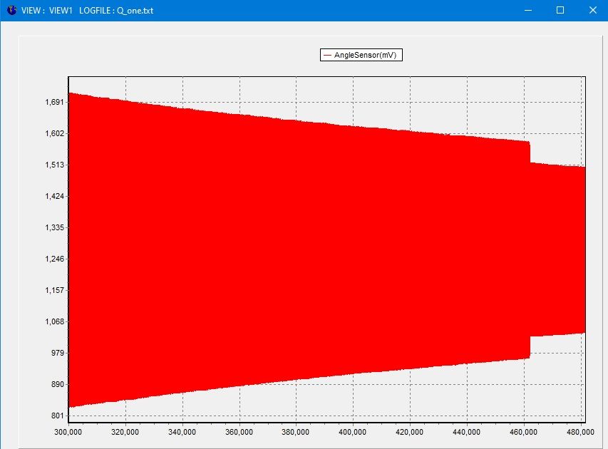

The Q's reported in the previous post have an error in the '31.8%' Q computation ( the Q of 14514)
The logged data is a large file, and during the latter portions of that log, 'someone' must have bumped the pendulum and buried in the data I found this:
That jump up in Q was to suspicious and when digging minute by minute in the file I found what had happened, so that Q computation is invalid.

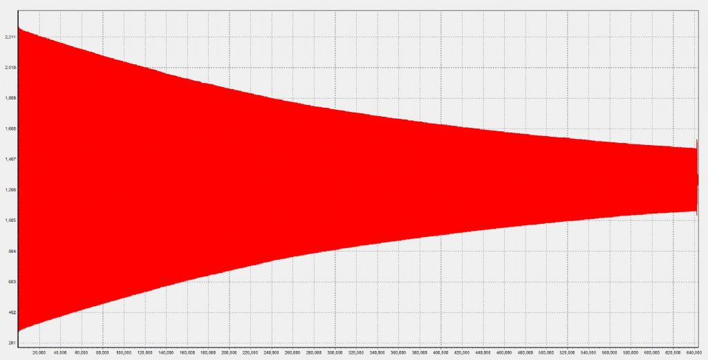

This is the plot of the last run-
It ran for 3hours 33minutes, with sample rate @ 20ms.
Q's computed :
@ 61% – 1940 beats * 2 * pi – Q = 12200
@ 50% – 2850 beats *4.5324 – Q = 12900
@ 36% – 4100 beats * pi Q = 12880
@ 21% – 6313 beats * 2.013 Q = 12714
There is a small improvement in Q from the 50% amplitude reduction onwards, and not what was indicated in the erroneous post. This is encouraging as it does indicate that the aerodynamic effects are not hugely impacting the bob, since there is little improvement at the lower amplitudes ( less moving air mass, but not a great Q improvement).
