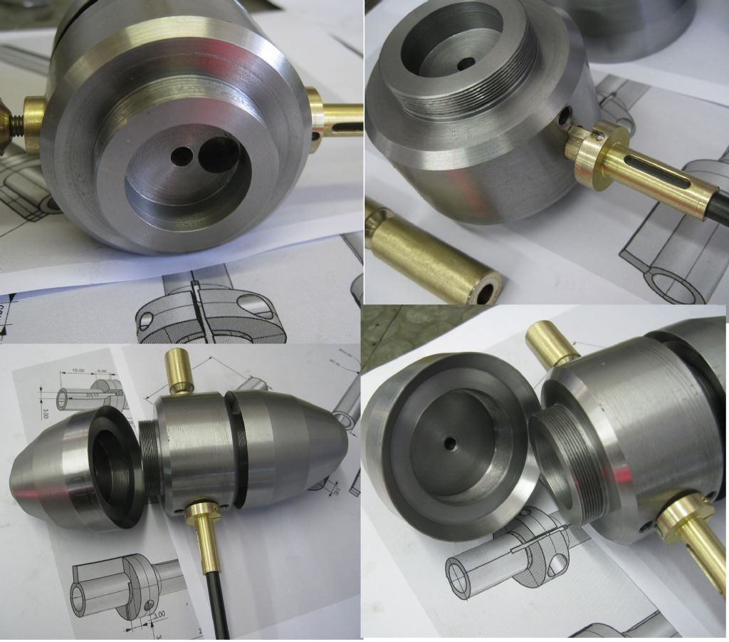

      The Pendulum so far –

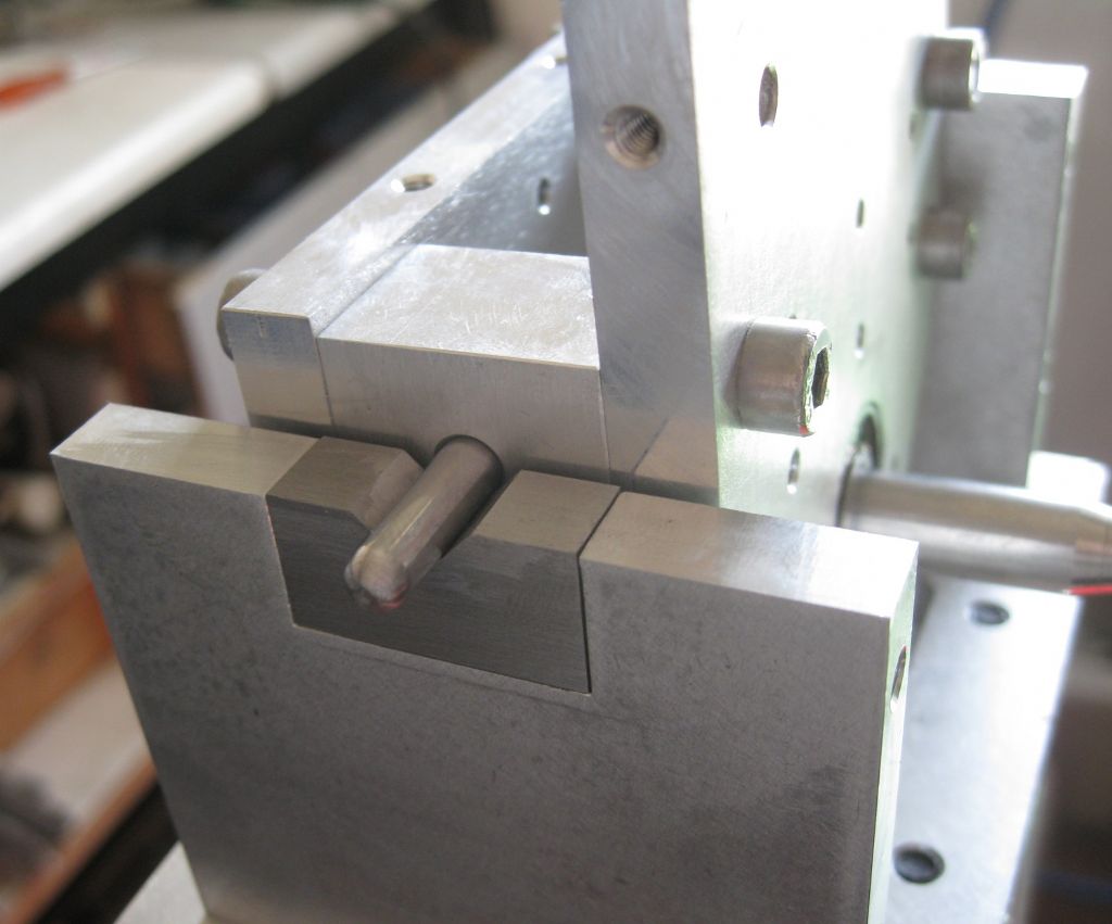

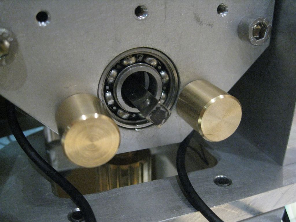

      I opted for a knife edge style pivot – 6x6mm cobalt section 100mm long as the knife, riding on the inside race of a ball bearing. The bearing was loctited into its loose fit housing, with a ground shaft fitted through both bearings to locate and align the races. once cured, loctite was added to the balls in the races, the inner race rotated to spread the loctite, and left to cure with the shaft aligning the races.
      The head assembly with knife pivot can pivot laterally on hard steel pins in two V block, on the top support assy –
      The frame is from sq tubing, with the base of 50x50mm tube, filled with lead shot, and the space between with a chunk of St-steel – 210x110x50mm (!) – base is about 15kg.

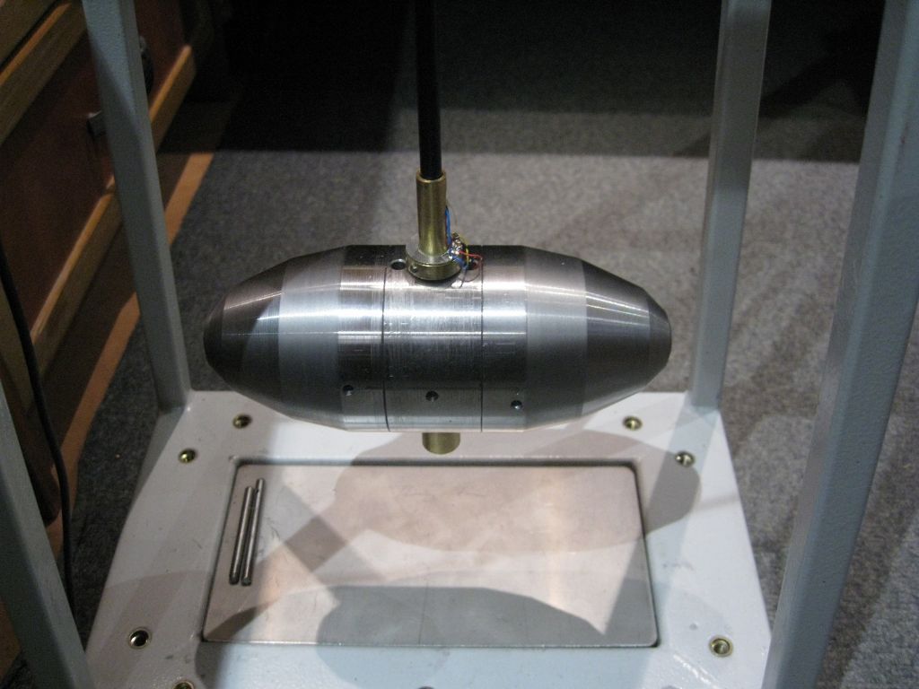

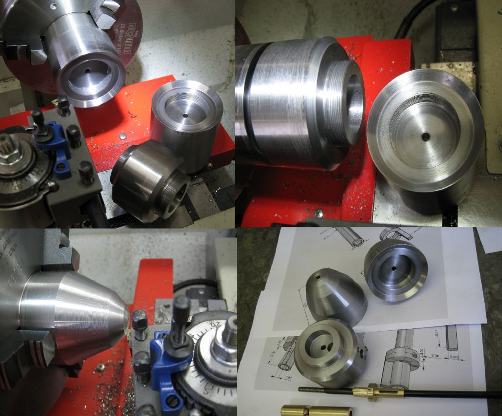

      The bob is made in three parts that screw together so I can fit electronics inside – accelerometer, temp sensor, etc

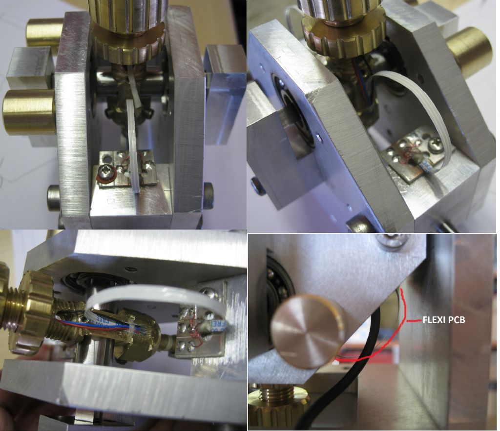

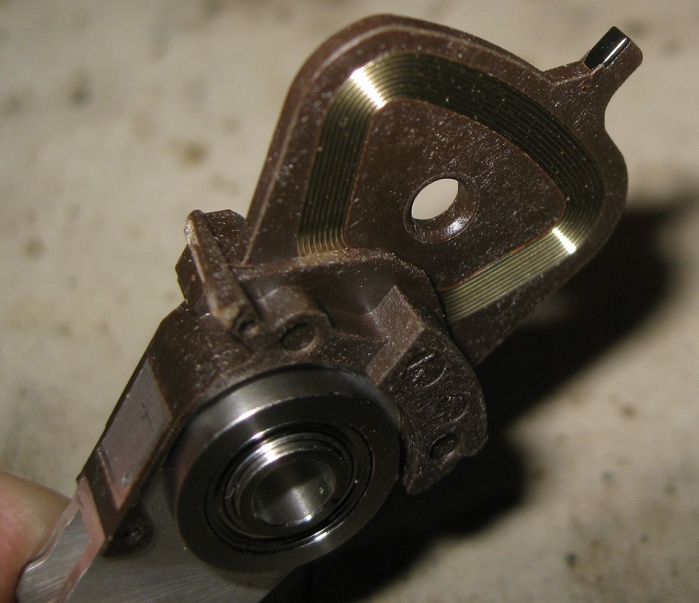

      The Pendulum rod is a carbon fibre tube, 7mm OD, 6mm ID. The wires to the bob run inside the tube and out the top at the pivot point so cable torsion is minimised. The wires come out the tube via thin (0.05mm thick) flexi PCB's.

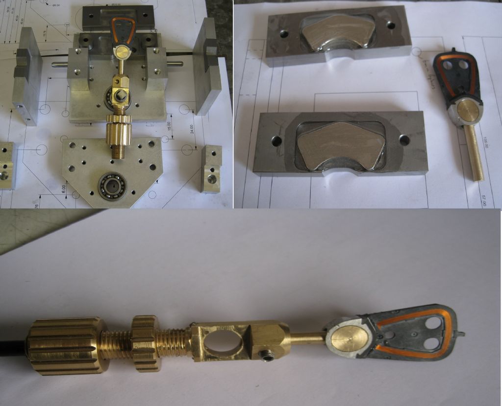

      My intention is to provide a sinusoidal drive to the pendulum coil, not impulse. This drive to be phase locked to the pendulum motion, with the amplitude of the drive tuned through a Kalman filter to provide sufficient amplitude to just keep the pendulum amplitude the same, and thereby hopefully the period constant. The idea being not really to keep the amplitude the same but rather the total mechanical energy must be kept to a constant value. I am not driving for a specific period, but for constant , fixed energy. If the period is not exactly one second, I will gear this in software to drive an external clock at 'true' 1 second.
      The drive to the pendulum is at the pivot end, not the bob end. It uses the drive coil from a small hard disc drive, and is sandwiched between the very powerful drive magnets.
      This is the head assy and the magnets in there iron concentrators can be seen here..
      Below is the pendulum tube top end, with the two screw adjustment weights – the larger weight is 15 grams, the smaller is 6 grams. The hole to the right of the small adjuster is where the knife will fit.
      The magnets in place with the sandwiched coil, and the adjusters under seen here below

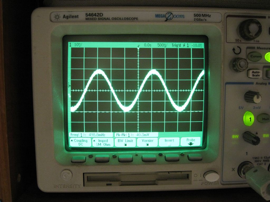

          The pendulum achieves a +- 1deg swing ( about 30mm P to P) after 9 applications of 12mA through the coil, applied one way with polarity for the swing direction. This drive will be sinusoidal in the final solution.
          So far the accelerometer is useless. The rates are to low for simple MEMS gravity type Acceleros. So I designed a capacitive angle sensor that gives 1.8V P to P for a +- 1 deg pendulum motion. This is very linear, and uses synchronous detection of ac signals to eliminate DC offsets and drift, so is very stable with temp and voltage variation.

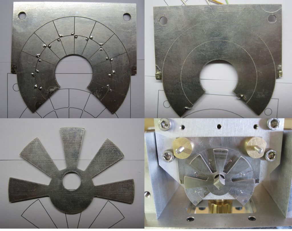

          Top left is the sensor drive plate, top right the pickup plate, bottom left the shield vane, and bottom right fitted on the head,
          All the associated electronics…
          Scope output of the sensor with a +- 5mm swing..Scope trace shows 40mv PP, but the probe is X10, so actually 400mv PP. gives 2V PP for a 35mm PP swing.
          I set the pendulum swinging 25mm total swing, with a scope showing 1380mv PP. I let it run till the scope show 36% of that – around 50mv. It ran for 2hours 30min, with a period of 2sec ( see scope – this was some minutes after the end of the run..) . According to SK's Q formulae that gives 4500 swings over 2H30m, times 2 times pi which is a Q of 28,0000.
          Sorry, not sure I believe that formula…

              On the suspension, the arrangement you have for the trunnion bearing makes it hard for the pendulum to hang truly vertical "back and forth" as there will be some friction between the bar and vees (yes, I know I use a similar arrangement!). IIRC the maximum hanging angle is something like arcsin(coefficient of friction), it's in Matthys' book. Doug Bateman simply has a flat surface on the "brackets" so the pendulum can roll to verticality. Or one could use ball bearings to reduce friction but also constrain the pendulum back-and-forth.

                    The trunnion – I followed the description in Matthys' book – the included angle is 115 deg, not his 120deg that he speaks of ( I had a cutter of 115deg..and polished the V and the hard pins. At the moment there is also a very slippery thin moly lube in the V as well. I made an impossibly finicky setup to measure the hysteresis in front rear swing – a thin wire ( cats whisker) mounted on a micrometer rail, making (just) contact to the bob. Pull the bob away 5mm and return it gently, using a piece of cotton yarn , till the yarn goes slack, and then advance the micrometer till contact is made again. Do it 10 times, and then do it from the otherside – I get a spread of 'estimated' 0.005/0.008mm – difficult to read on the micrometer. That is very small and a very small angular delta therefore. The pendulum swing across the trunnion dies out to almost nothing within 18 seconds when started with a +-10mm P to P swing.

                      No wires flapping in the rod – the rates are so low…And no friction of wires at exit there is a flexi pcb , very thin, at a 35mm radius bend, so adds no friction and no spring.
