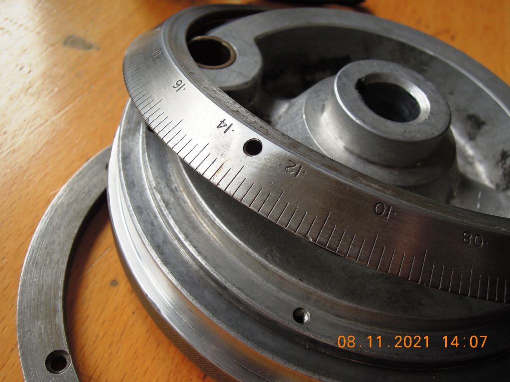

      Chaps, my 540 should have a little locking thumb-screw on the dial for the height adjustment but it seems to have gone walk-about sometime in a previous life.
      I could of course re-invent the wheel with my own design, but if anyone can send me a picture of the real thing please, or even just a length/dia/knurl-pattern/brass/steel description please if that's easier I would sleep easier at night (I'm ok on the thread size.) Thanks in advance.

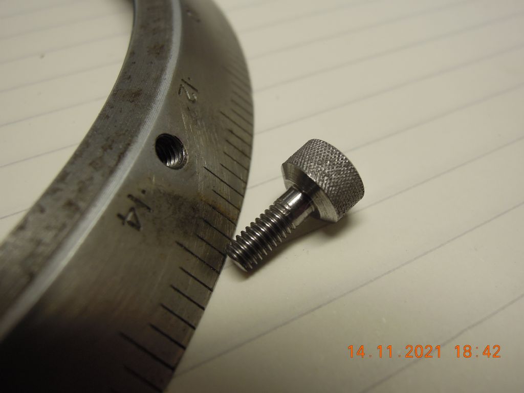

                    Sorry for the late reply.
                    I've just been using my 1976 vintage J&S 1400 grinder and took the opportunity to take the height dial locking screw off and measure it.
                    Mine is 1/8" (actually 1.205" od) X 40 tpi. The thread are 3/8" long. The head would have been 5/16" dia before knurling X 1/8" thick. This might not apply to the 540, but it's a possibility.

                    Howard Lewis
                      @howardlewis46836
                      0.125 x 40 tpi might be 5 – 40 ANC. The 60 degree thread angle would distinguish it from the 0.125 x 40 tpi 55 degree 1/8 BSW thread form that we would also call 1/8 Model Engineer.
                      Nearest BA to 0.125 would be 5BA at 0.127" x approx 43.1 tpi
                      4 BA is 0.1417" 3.6 mm ) OD x approx 38.5 tpi
                      Howard
                      #571301
                      Mark Rand
                        @markrand96270
                        It won't be ANC. All the other threads are BSW or BSF. It's 1/8" Whitworth.smiley
                        I've got metric, US, Whitworth and BA thread gauges and the only one that fit was 40tpi. I did originally wonder if it was 5BA, but the pitch is way off for that.
                        Note that BSF isn't specified below 3/16" but BSW is specified down to 1/8" in  BS84-1956. Amusingly, Meccano threads of 5/32" 32tpi aren't an 'official' standard either.

                        gerry madden
                          @gerrymadden53711
                          Thanks all for your additional thoughts.
                          I really thought I had cracked all this thread identification business, especially as I now have the benefit of my OMT complete with its oculars for thread angles. But this one gave me real trouble. After a lot of humming and haa'ing and endless perusing of tables I decided it had to be a 5BA and bought at tap and a die. When I got them I put the tap in the hole and like every other tap I tried it was a wobbly fit. Well perhaps the hole was just on the top of its tolerance range, I thought….., I therefore turned up a screw using the new die opened out to its absolute maximum hoping this would sort it. Sadly it didn't as even this was also a rubbish fit.
                          Time for drastic action. Whether it liked it or not this hole was going to become a 4BA. Somewhat surprisingly the 4BA tap didn't create a mangled mess and in fact made a nice job. I made up a screw to Chris C's dimensions but with a 4Ba shank and it fitted beautifully.
                          I'm sure some people think I'm nuts but when finally something goes just as you want it to isn't it a nice feeling ?!

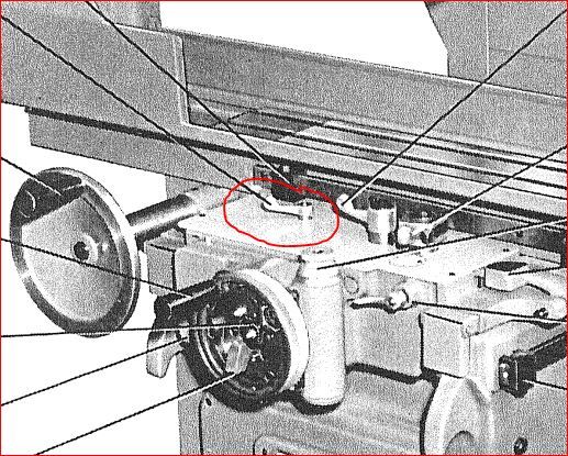

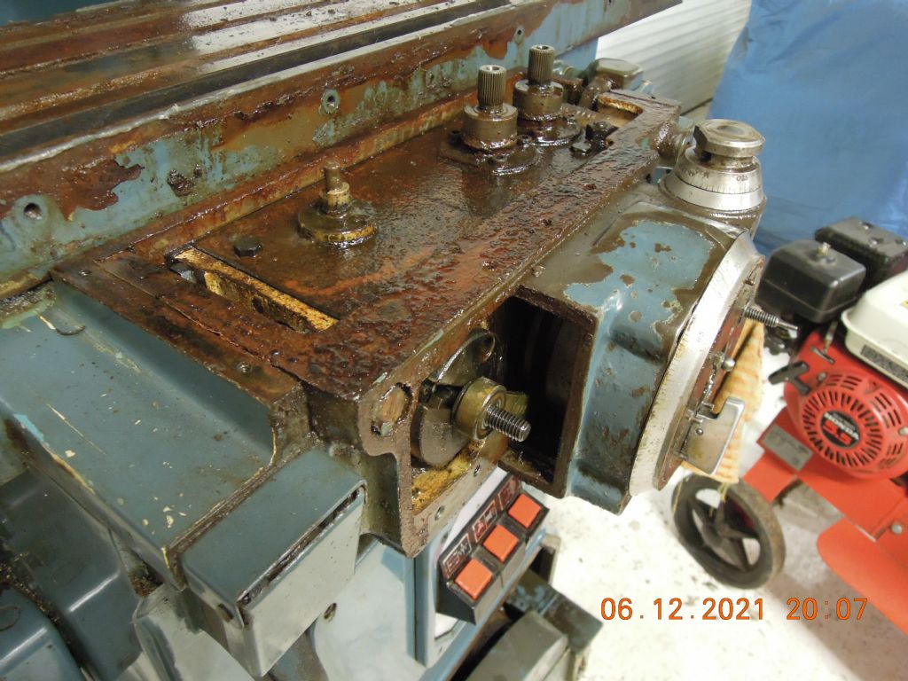

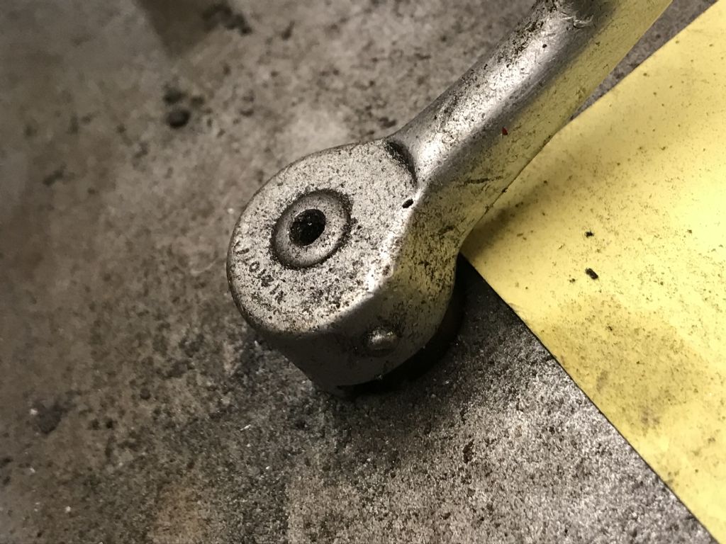

                          gerry madden
                            @gerrymadden53711
                            As I expected I'm being sucked into fast to doing a complete nut and bolt refurb of my 540. I don't mind as getting into the minutiae of machine workings in one of life's pleasure as far as I'm concerned. So last nights challenge was this control knob…..capture.jpg
                            Again a slight mangling from a previous owner has disguised the means by which the knob is fixed to the shaft. On one side it looks like a hex socket grub screw, only I can poke a 1mm pin all the way through the knob and till it pokes out the other side. If it is a grub screw (with a hole in it) I cant find a key that seems to fit. It might be a roll-pin but when tap it with a pin punch it doesn't show any willingness to budge.
                            I might need to get more brutal but before I do I thought I'd check with others on here that usually know from previous experiences. Any thoughts please ?
                            #574424
                            Dave S
                              @daves59043
                              IIRC it’s a taper pin. So will only come out one side.
                              I can have a look tonight – mine was off not very long ago.
                              #574425
                              Chris Crew
                                @chriscrew66644
                                Gerry, It's definitely a roll pin on mine. It is not a taper pin on, at least, my machine as suggested by Dave S although that is not to say all machines will be identical. I have just been out to the workshop and tapped it halfway out and back in again just to prove it for you.
                                #574450
                                Mark Rand
                                  @markrand96270
                                  Mine are held by taper pins!
                                  #574467
                                  Dave S
                                    @daves59043
                                    Taper pins on my controls, presumably so you can’t put them on 180 degrees out.
                                    Don’t know if a roll pin in a taper hole would form itself into a taper?
                                    #574502
                                    gerry madden
                                      @gerrymadden53711
                                      Thanks chaps for your help. It turned out to be a roll pin like Chris's model. Eventually with some unkind drifting it began to move and reluctantly came out, dry as a bone and clogged with dust and corrosion. After that it was just a simple matter sliding the handle off its shaft…..one hour later that was done too.
                                      It was an ugly sight under the valve cover but thankfully just cosmetic…… but its all going to come apart anyway
                                      By the way, if anyone out there is interested in me giving a summary of my refurbishment on this 540 as it goes along just let me know and I'll try to do that.
                                      Gerry

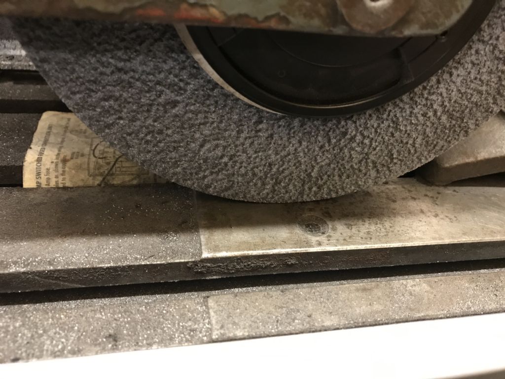

                                              #574601
                                              Dave S
                                                @daves59043
                                                My wheel will touch the table – are you sure the way covers on the column are not sticking?
                                                On my table there is a raised area of the t slots- not by much maybe an 1/8” which is clearly designed to be ground in. Do you have a similar patch?
                                                pic shows wheel on table and the raised pad:
                                                Edited By Dave S on 07/12/2021 18:18:21
                                                #574605
                                                gerry madden
                                                  @gerrymadden53711
                                                  Dave, yes my table top looks just like yours. I'm fine on the traverse and cross feed distance too.
                                                  That's a really good point about the covers. I took them all off yesterday except one which was under the head ! I was tight and I couldn't raise the head because the elevation wheel assembly was in the house following repairs and painting. Perhaps I need to temporarily re-fit the elevation wheel, remove the last cover, lower the head again and see how I stand then. Thanks for that steer.
                                                  Gerry
                                                  Edited By gerry madden on 07/12/2021 18:45:47
                                                  #574613
                                                  Mark Rand
                                                    @markrand96270
                                                    A 540 can spin an 8" wheel safely. You should be able to reach the table with that, although the guard (or the back of it, when removable) has to come off.
                                                    When mounting the chuck back on the table, use Molykote 111 compound (a heavy silicone grease). If you can't get that (it's reasonably readily available), then use several coats of zinc rich cold galvanizing paint on both surfaces. If you don't, then coolant will invariably cause the rust to come back.
                                                    #574620
                                                    gerry madden
                                                      @gerrymadden53711
                                                      Thanks Mark. I'm glad you have brought that one up ! Rust growing between my table top and the chuck had bowed my chuck upwards by 20 microns so it was on my mind to find a way to stop it from happening again. I did think of using one of these preservative wax-based compounds but a heavy grease would be easier to easier to wipe away when required after a long period.
                                                      Gerry
