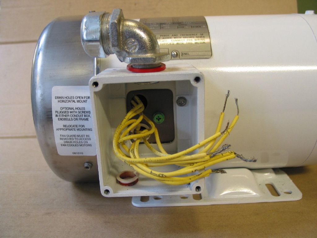

      Mark, your sketch is correct for a 230v 3 phase setup to run from a single to three phase inverter. If the motor runs the wrong way, swap any two of the wires from the inverter to the motor.

        Mark, the isolator you linked to should be OK but don't forget to connect both ends of the cable metal braid for continuity of protection, either use earthing rings with connecting conductor or take the tails into the enclosure and connect at the earthing terminal with the cpc's (g/y earth cables)

          mark smith 20
            @marksmith20
            Andy thanks for the confirmation,ill blame you if i blow myself up!!!smiley
            Emgee ,thanks for the info,ill try and follow the advice correctly.
            One question is the screw in the middle of the terminal box (middle of black area going into motor housing) on the motor the one to secure down a terminal block??
            I assume the one to the side is the earth?
