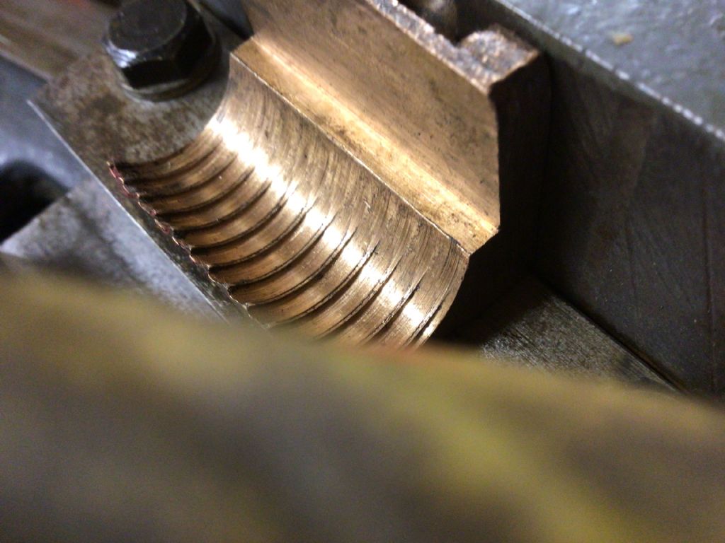

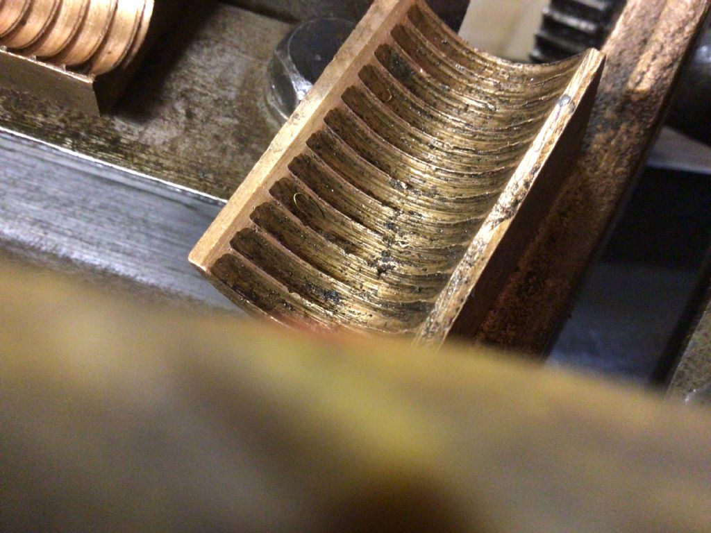

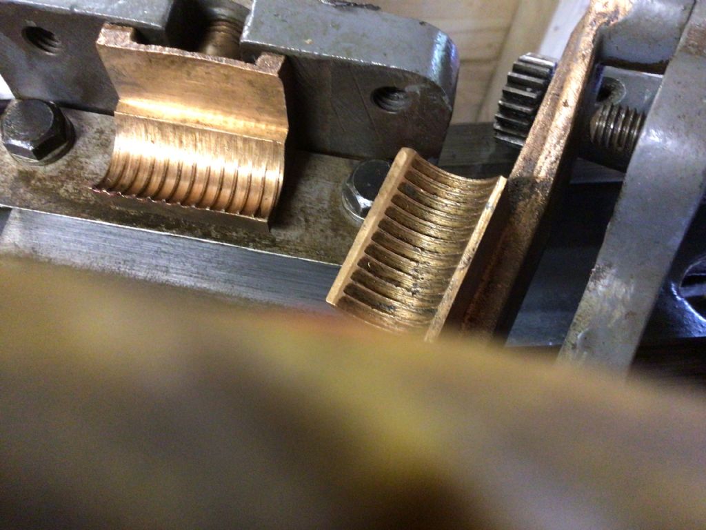

      21880805-b479-4dd4-adaa-99401a035624.jpeg8049a654-ff95-469a-9823-f961be7dfc9a.jpegHi, first off a big thank you to everyone who has helped me so far.
      new to all this,
      bought a Drummond M type in a basket……I now have it built and I know it has been attacked with a hacksaw in the past…..however it is mostly there and it will do what I want.
      I have stripped most parts and cleaned and oiled reassembled.
      I have just stripped the saddle and in doing discovered what a half nut is.
      my question is having never having seen one before :- what do folks think of it ? Worn out, o.k, or good.
      if worn out what can I do about it ?

        Half nut

        Martin Johnson 1
          @martinjohnson1
          Life expired. It will slip a thread at the most inopportune moment, so replace if you have any intention to do screwcutting.
          Awkward to make, but you might be able to silver solder new nut halves into the old remains.

            Hi Haydn,
            From your photos the half-nut looks worn, especially on the side where there is hardly any thread left.

                              I think everyone is wide of the mark here . One of those is only a pressure pad and doesn't need a thread at all the other is not too bad and in my experience with 4 Drummond restorations it will probably be OK as it is. Try it , if it works then it's ok.

                                  thanks for all the reply’s…I have now discovered that the shiny top half should in fact not have any thread, what you see is where the lead screw over time has worn into it….it’s supposed to be a pressure pad….the lower half is the only part that has a ‘half’ thread. In view of this should I smooth out the top pressure pad and adjust it down a bit..
                                  the lead screw looks to be pretty good.
                                  thanks

                                      Hi the top of the leadscrew nut should be smooth with no thread as it is just to support the thread and should be filed and or scraped this will allow the saddle to traverse with the handwheel. The top piece should be adjusted till it rests on top of the leadsrew and locked there.The bottom nut can be repaired by screw cutting a phosfor bronze full nut with a round outside. This should be cut in two go make two halves one which could be sold as a spare. The arm will need boring on a mill to take the replacement half nut and silver soldered in its place.

                                        The picture looks awful to me but lathes.co.uk supports Lee's opinion:
                                        The nut (being of the "half" type and likely to be pushed out of engagement) was assisted by an upper thrust pad – a plain, half-round bronze unit retained by a massive bronze nut against the inside face of the apron; this thrust pad often has, due to years of work, the appearance of a thread cut into it – but it should be plain and smooth.
                                        So I'd put it back together and see how well it works. Hopefully it will be fine. Spares for a lathe that went out of production in 1952 aren't easy to find and making a half-nut isn't a job for a complete beginner. Best to get a feel for metalwork generally and build up the workshop before tackling a repair like this. A new nut can be made, but not in half an hour with a few basic tools and no experience.

                                          Yes I saw what I wanted to see, a knackered nut, but it was the top half, which is an unthreaded pressure pad
                                          Your current nut looks ok for the moment, try to use the rack as much as possible to save wear and tear as you position the saddle up and down the bed, only use the nut for useful work purposes as much as possible
