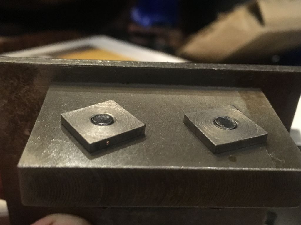

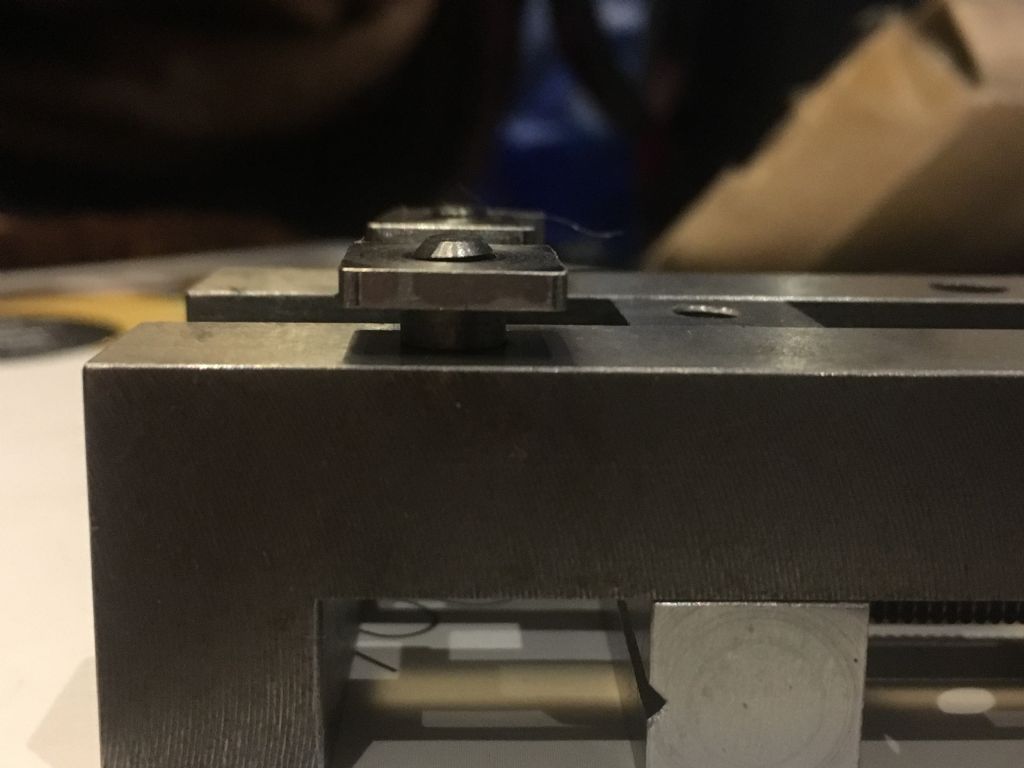

      So I purchased a new vice from Cowells to mount on the Milling slide of my ME90 (the slide is Cowells brand too) It arrive last week but it refuses to tighten up when mounted with the two T-nuts. I tighten the nuts as tight as sensibly possible but there is still a massive amount of movement in the whole vice itself at least 5mm…
      Now I have an angle plate from cowells which mounts on my milling slide perfectly and noticed the T-nuts on that actually recess into the holes on the angle itself, like so…
      angle plate
      But this is not the case with the vice…they stand proud and won't fit into the holes like so..
      vice
      Should they recess like the T-nuts on the angle plate and could this be a reason there is so much slop? or Am I overlooking something, being stupid? Maybe something else?
      I sent them an email at the weekend and am waiting for Colin at Cowells to get back to me, but thought I would try figure it out in the meantime.

        Or is it me?

          I can't quite make out from the second photo what is between the square nut and the vice's underside, but it looks suspiciously like a spacer rather than just a portion of the threaded fastener whose conical tip can seen protruding from the square nut.
          Assuming I've understood things correctly (and I know nothing about these vices or Myford milling slides), if this spacer is deeper than the distance between the two surfaces on the milling slide that the vice needs to clamp on to, then you will never get the vice to tighten down without shortening these spacers.
          I'm sure someone will be able to give you a more authoritative answer soon.

            Are the conical ends of the fasteners making contact with the bottom of the T-slots?

              They look like turned T-nuts, where the upright of the T is circular in section (my Unimat has them).
              Two things I would try, first put a nut with its screw into a T-slot in the milling slide and confirm that the cylindrical part doesn't stand proud of the surface when you pull on the screw. If it does you will need to shorten the cylindrical part of the nut or counterbore the holes in the vice (or better yet return it to Cowells for rectification, unlike cheap Chinese tools I would expect it to be right first time).
              Second, place the vice on the milling slide and push one of the bolts into it and see if it touches the bottom of the T-slot in the slide. If it does you will need to shorten the screw (or change it for a shorter one). This is the most important as if the bolt bottoms out it can jack up the T-nut and break the lip of the slot.

                Check that the trunk section of the tee nuts are below the top surface of the mill table when clamped. You have said that on the angle plate they recess into the angle. They will not clamp if they protrude and the vice base is flush with the table.
                Also as noted, check that the bolts do not touch the bottom of the Tee slot. If they do, they can break the Tee slot if over tightened.

                    It seems logical [given the small size of Cowells parts] that the circular trunk of the tee nut is intended to slide comfortably into the hole in the vice base. … It should be a simple matter to determine which component is wrong.
                    Edit: If this is not the intended arrangement then it seems that the 'trunks' on the supplied tee nuts must simply too long.
                    That said [and with either analysis]: Given Cowells' reputation for close tolerances … I am surprised surprise

                      I'd suspect over long screws, unless the t-slot lips are perilously thin.

                        Surely the T nut fits into a T slot and that "protuberance" on the underside of the nut in photo 2 is then in the narrow part of the T to align the T nut. It won't stick out above the edge of the slot, so the vice will clamp tight to whatever the T slot is in. Or perhaps Cowells have a unique way of doing things?

                            Tighten with care
                            The two parts should squash together on the upper part of the t-slot
                            If the screw s too long it will "jack up" into the upper part and crack the cross slide
                            Insert of piece of paper along the bottom to check, it must be a sliding fit or your upper t-slot is under stress

                              Thanks guys, You were spot on. It appears the supplied bolts are too long. thank goodness I didn't nip them up even tighter then and break my milling slide. Going to ring them shortly to chase up the email.

                                        Just to update.. Colin got back to me this morning and explained that the Tee slots on the vertical milling slide have varied a little and the bolts he sent were fashioned on a VM slide he had there. He has offered to send some shorter bolts to me.
