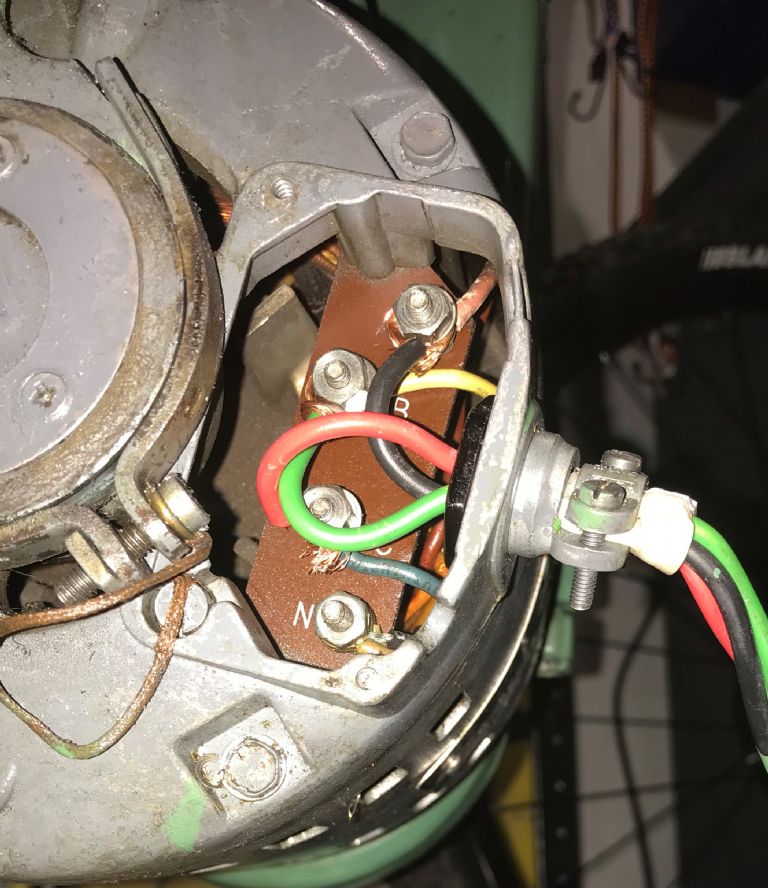

            Hello Les, i don't know sorry, i have taken a photo of the connections but they mean nothing to me, unfortunately i don't even know if it all worked before it was passed to me.

              It looks possible that the motor is star connected, it looks vaguely like there are multiple connections to the "N" terminal. It needs rewiring in delta to run off a conventional VFD as Les suggests.

                It looks like it is configured for star connection (415 volts.) Are there three wires from inside the motor connected to the "N" terminal or just one. If there are three wires it should be possible to configure it to delta (240 volts.)

                    If there are 3 wires going to the neutral point, you’re in luck, otherwise you will need to dismantle the motor and dig out the star point.
                    There are 3 seperate windings in the motor, so if you do have six wires emerging already, its fairly easy to work out which pairs go together using continuity on a multimeter or a battery and bulb.
                    Once you have the ends of the three seperate windings identified, join them as pairs i.e keep each winding seperate and connect the three phases from your inverter to the three pairs.

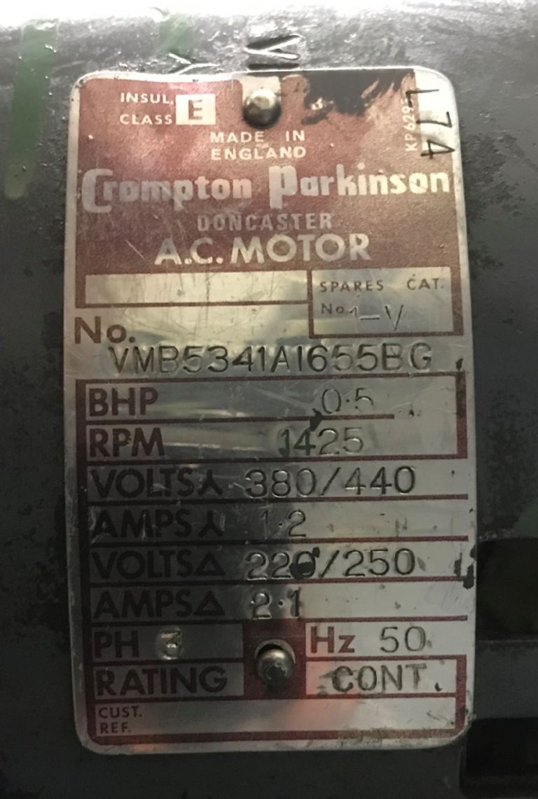

                        Looks like there was a sticker on the back of the plate but its missing, this is a photo of the main plate,
                        Cannot tell from the photo how many wires go to the N, looks like 2, but will check tomorrow.

                          According to the plate its a star /delta dual voltage motor, so should definitely have at least 6 wires emerging.

                            Data plate gives voltage and current for both star and delta connections so there will be wires that can be got at and shifted around on the back side of the terminal plate. Not much room to work in there. The backside of the plate was wired up first before fitting it to the end bell and finally assembling the motor.

                              i have just checked and there are 3 wires going to N..
                              so..
                              A = Red
                              B = Yellow
                              C = Blue
                              N = White / Brown / black

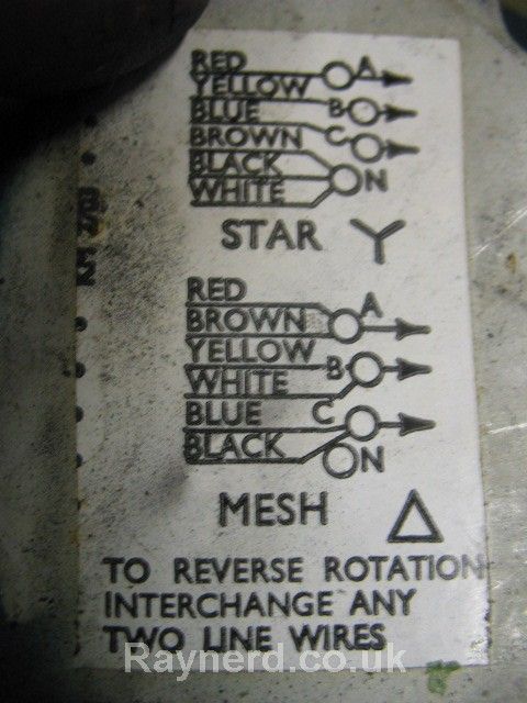

                                Looks like this has answered my qustion..if mesh is the same as delta.
                                #383457
                                Alan Waddington 2
                                  @alanwaddington2
                                  Yup mesh is what you need

                                      Posted by Brian Abbott on 02/12/2018 23:18:19:
                                      I have no idea who Raynerd are but what a badly drawn diagram they have produced!
                                      The presence of the 'N' neutral terminal in the lower diagram could easily confuse someone unknowingly as it could be construed as connected to the black wire.
                                      Ian P

                                        Chris Raynerd is a hobbyist/engineer. I don’t think a photocopy pic of a motor winding diagram from a motor has much to do with him. Standard drawing, as far as I see it. If connected to both, it would have shown a link? Modern day drawings would be better (a definite dot at each actual connection), but this is not modern.
                                          I know Chris too. this is not his drawing, just a copy from a motor label he had….

                                            This is a picture i found on the internet, i thought is was extremely useful.
                                            If I have accidentally wandered into a copyright issue then if the moderators could just please delete.
                                            Anyhow, my thanks to Chris as it was extremely useful.
                                            Thanks.

                                              I apologise to Chris Raynerd. I thought the watermark was because it was a company image and it was the originator of the image I was being critical of, rather than any individual.
                                              The image looks like a photograph of a label on a motor and I think could have been drawn more clearly to eliminate anyone misunderstanding it.
