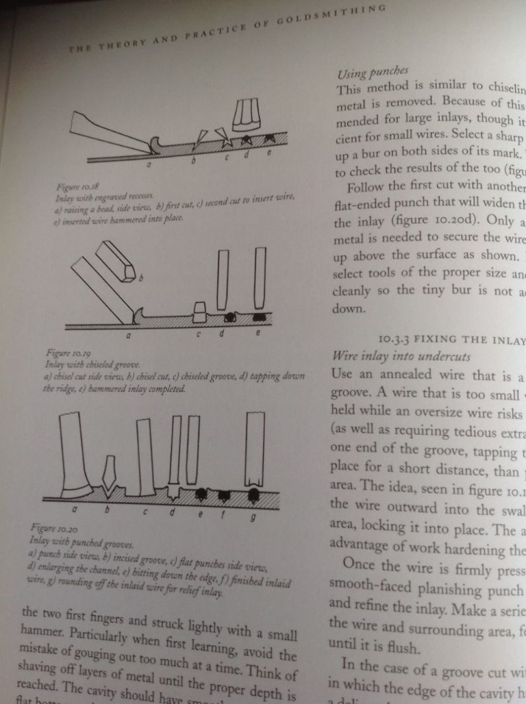

                          My understanding (and it's book knowledge only, without personal experience) is that in a/the standard technique, the edges of the undercut groove are raised a little, when the undercut is formed, then worked down again, as the inlay is applied, further securing the inlay. Fine silver seems to be standard, because of its ductility, whereas sterling silver is less ductile. I haven't come across mention of cold hammer-welding of silver, although gold does, of course.
                          Having said that, would a standard engineering approach not work? Can you roll the wire into a square-section ring? A ring 19mm dia, of nearly 2mm square section, is quite substantial. If you can make the ring truly circular, with a well-butted join, or soldered, couldn't you make it an interference fit, where the OD of the ring is a gnat's whatsit greater than the OD of the receiving groove? It wouldn't be terrifically 'strong', but you haven't indicated what this is for. If it's just for looking at, strength is a minor consideration.
                          #461490
                          Tim Stevens
                            @timstevens64731
                            Inlaying has 'always' been done by cutting a groove and hammering in a wire. Cut the groove so that the edges form a burr, and hammer the burr down onto the edges of a half-round wire. It is not 'engineering' in a modern sense, but it is certainly silvermithing. Gold inlay into silver is done just the same, as was silver into steel for posh armour.

                              PS It is useful, when hammering the wire into place, to do it on a firm solid surface, so the energy goes into the job and doesn't buckle the background. Secondly, don't use a hammer alone – use a punch with a smooth and slightly convex surface – rounded at the edges. A useful punch can be made from a coach bolt with a 'flat' filed in the middle of the dome, and then polished using emery, wet-&-dry, and finally chrome polish. If you can see your face in the surface that is shiny enough. You might need an assistant to hold the work against the support while you tap, tap, tap. Using a punch should avoid making half-moon marks around the surface.
                              And do a practice run first – copper wire will do for this.

                                Robin, if you do decide to inlay by mechanical means rather than using solder [you'll still need to solder the ring shut and size it accurately first], below is a diagram of the choices open to you.

                                  Thanks for the scan of the page from The Theory and Practice of Goldsmithing Bill. That's useful, and chimes in with replies from Tim and Kiwi Bloke -for which thanks. I'll get a copy of the book I said to myself, but 70 quid, not going to happen.
