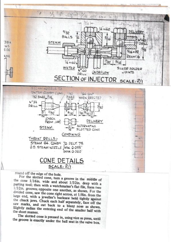

        I am under way in making one of LBSC's injectors for a 5" SPEEDY loco.
        It seemed a simpler idea once the body was made to make what was described as a "Slotted Cone" for the combining cone. as detailed in the attached drawing.
        Can someone explain what the slots in the sides of the cone do and should those slots pierce the Venturi which passes through the cone?

                    You are right: the slot of parting does cut into the cone itself. It provides the water's escape to the non-return valve that helps the injector to start.
                    The overflow valve is theoretically not needed but in practice was found very early on to make an injector self re-starting after temporary perturbations in the water flow to it. It also helps us by showing water is reaching the device at the start, and allowing running cold water through it if a slight steam leak has heated it.
                    Some full-size injectors have the combining cone split lengthways with one half hinged to act as a flap-valve, or use a sliding cone, but they do the same thing as that little ball-valve. I don't know the design Zan cites: is the overflow gap the annulus between the combining cone outlet and delivery cone inlet?
                    The drawing as shown offers alternatives: cut the cone into two parts or have two slots separated by narrow bridges that keep the cone in one piece. The latter needs that waist turning in the already very fragile cone.
                    If I was to make an injector to that design I think I would match the two slots with a shallow annular groove in the body instead, with a compensating weeny thickening on the exterior.

                      Cone dimensions and spacings look more tightly specified to me than anything else in the plans. Are injectors the most critically dimensioned part of a model locomotive?

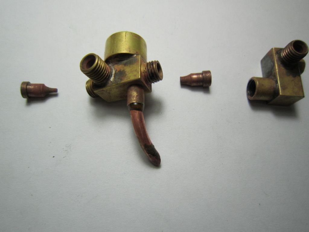

                                I made a LBSC injector when I built my first locomotive TICH in 1978. It was made following Curlys instructions in his book Shop Shed & Road. It is of the Sellers type, combining cone is in one-piece whit a slot in the middle 1/32” wide. It always picks up quickly and with such a small boiler it only needs to feed for about 15 seconds. The only drawback is that it doesn’t run dry, there is always some water coming out from the overflow, but as long as the main part goes into the boiler I can live with that.
                                Jan
                                LBSC Injector

                                              Going right back up the thread, I don't think anyone answered your second question about the overflow pipe. Apologies to anyone who did for my not spotting it.
                                              The drawing suggests 5/32" (ish) bore in 3/16" od (set by the swg thickness), but it may not be too critical as long as the wall is thick enough for a 40tpi thread. I am surprised it's not specified properly, though, even in the text.
                                              Probably best to make it from brass, as easier than copper tube to thread.
                                              The length does not matter. It is commonly a straight stub about 1/2 inch or so long, and its role is simply to direct the water as a steady stream away from the metalwork, and readily visible to the driver. It would not matter if it is longer provided the water can still fall easily out of the end.
                                              Jan B shows a neat finishing touch on his 'Tich' injector: a partial bend cut off vertically. It directs the water further from the loco and renders it more readily visible. Typically the cut end would be a touch inboard of the footplate valance, the injector itself a little deeper under cover. I think this was common practice in full-size.

                                                I have sourced a copy of DAG Brown's book, and now thinking towards making one of those, however I need to source a 7/32 reamer which will take some time to get here in France, but won't stop me making the tapered reamers etc.
                                                Back to LBSC's injector, the drawing shows a tapped hole of 5/32 x 40 for the water overflow.
                                                5/32 = 0.156"
                                                depth of thread 2 x 0.016" = 0.032
                                                core diameter 0.124 (for the 5/32 x 40 thread)
                                                assume 24 SWG( 0.022) for the tube gauge
                                                0.124 – (2 x 0.022) = 0.080 max bore diameter of water overflow.
                                                The water overflow is threaded into the injector body so that you can measure the distance between the end of the combining cone and delivery cone. I take Julian's point about the positioning of the steam cone which brings us back to "bare" dimensions !
