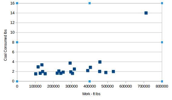

                        Posted by Neil Wyatt on 14/09/2016 11:19:04:
                        The need for the big loco to take three runs to climb the 'hill' must have affected its work done figure as well. I wonder if the distance travelled includes the retreat and the re-run up the hill? In other words is the distance from the dynamometer or from the number of completed laps?
                        I've been pondering Big Boy's excessive fuel consumption, the engine's outlier being obvious top right on a graph of work done against coal consumed.
                        Neil's query about measurements during hill restarts got me thinking. Restarts, drivers leaning on the engine, non-standard loads, and dropping passengers mid-run etc will all distort the figures. When and how the measurements are taken in these circumstances could make big differences too. Perhaps that's why Big Boy appears to be so greedy.
                        Does anyone have details of the Big Boy used at IMLEC that might explain the fuel consumption? There are too many hits on the web for 'Big Boy' for me to wade though I did find Alberto Celot's model at *LINK* . This is is a Propane burner and wouldn't be burning coal at IMLEC. However Part 7 of the Build description lists a raft of energy gobbling devices: Steam Driven Pump, Electric Pump, Air Compressor, Mechanical Lubricators, Whistle and a steam turbo-generator! Perhaps they are the cause?
                        IMLEC calculations may be a nest of vipers but I enjoyed 'Raiders of the Lost Ark' and 'Snakes on a Plane' too.

                          Following on from Neil's suggestion about number of trucks I decided to try to make some allowance. This isn't shown on the results board, so I ran the You Tube video and counted them for some of the runs. Why I didn't do all will become apparent. Whilst I'm counting trucks I might as well count passengers. Just quoting 3 off. BR Proposed reported as 16 passengers, actually 17 on 5 trucks. Duchess reported as 17 passengers, actually 16 on 4 trucks. Wild Swan reported as 12 passengers, actually 13. Can't Mancunians count? No wonder there is scatter. Note I'm working from a photo of the results board, not ME table.
                          Our club trucks weigh 50 kg, so allow these at 3/4 person, then repeat the sums and the BR Proposed and Duchess come out within 1.5% on DBLoad per person. If I could raise the energy I'd sit through and check all the other runs, but it's pretty dull running at 1/4 speed to count passing feet.
                          To answer SOD's questions, only positive DB load is recorded, but distance is incremented forward and backward. Hence BR Proposed did 8.6 laps, Duchess did 10.
                          To raise another problem, a big loco might have a grate say 30 sq.in. 1" of coal spread across this will weigh 19 oz. When the reported coal use was of the order of 30 oz, how on earth do we allow for the difference in coal on the grate at start and finish of run? 1/4" difference in level would be 4.5 oz, which is more than the difference between 1st place and 2nd.
