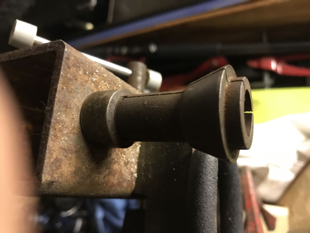

                        #389985
                        Ian Usmar
                          @ianusmar79339
                          adec6757-ec61-4499-92ef-e4bc4e6b1eff.jpeg Is anyone able to identify this collet for me ?
                          Regards
                          #389999
                            Posted by Ian Usmar on 08/01/2019 13:06:12:
                            Regards
                            Not much hope without some dimensions
                            [except to say that it looks 'dead length rather than 'draw-in]
                            #390081
                            Ian Usmar
                              @ianusmar79339
                              So measurement for my collet.
                              Overall length 2”
                              OD at the base 13/16”
                              Bore 1/2”
                              OD top of taper 1 1/8

                                #390086
                                  Ian,
                                  Feel free to browse through this Album : **LINK**
                                  https://www.model-engineer.co.uk/albums/member_album.asp?a=39260
                                  Martin Connelly kindly provided the scans, and I converted them to jpg to make them viewable here.
                                  #390087
                                  JohnF
                                    @johnf59703
                                    Regards
                                    Ian, it looks like a collet from a Marlco indexer used extensively on milling machines in the 1960's and earlier for sure. John
                                    Edit = add image address — maybe ????
                                    http://www.gandmtools.co.uk/wp-content/uploads/2017/01/DSCN7470-477×469.jpg
                                    Edited By JohnF on 08/01/2019 21:05:41
