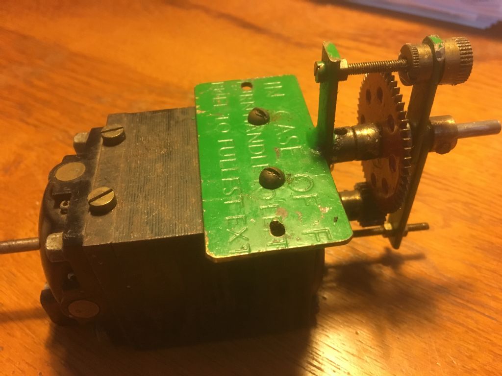

      Good afternoon all.
      I recently bought a box of Live Steam items, specifically wanted a few pieces. In amongst the bits and bobs was a vintage electric motor. I am sure this will be of some use to someone but it has no identification on it whatsoever so I am unable to offer it as I dont know what it is!
      Do any of you experts out there have a clue what this is? Thanks in anticipation.

          The gears look like Meccano ones, ( 19T and 57T, and the collar, so the shaft would be 5/32" diameter) but the motor is not an E20R or an E 20, nor is it an S E L (to my knowledge)
          It looks as if the brushes live at the end remote from the gears.
          The green plate seems to be the means of mounting it in whatever it powered.
          Howard

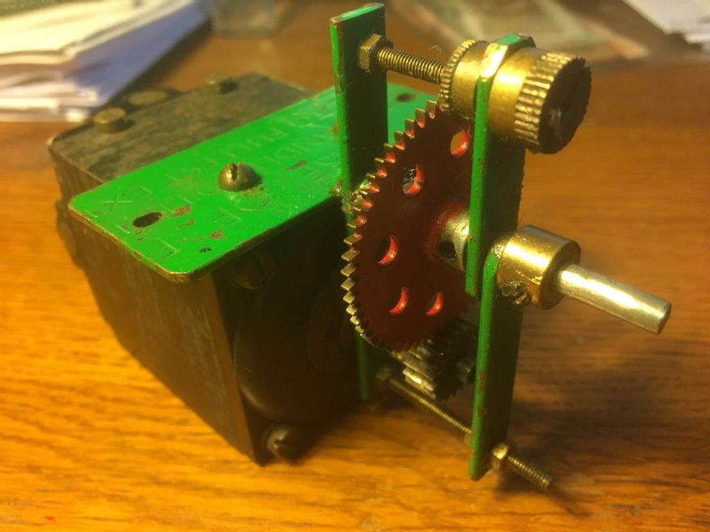

            If 55 (ish) year old memory is to be trusted it looks like the one in the monster box of Meccano that was passed down through the family until binned by the unthinking cousin who got it after me.
            Not a Meccano one as it wouldn't fit when I tried to build one or two of the models either out of the really advanced Meccano books or from Meccano Magazine.

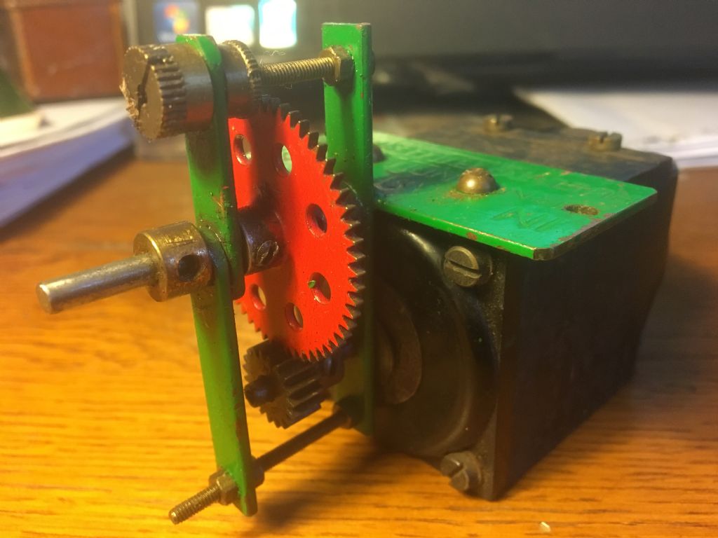

                It's very well made, not a toy originally. I suggest it was a war surplus item, probably aircraft. I don't recognise it specifically though. Anyone got any old Proops or "Service Trading Co." catalogues?

                  Mine was acquired with other things I wanted in a rummage sale – somebody suggested it came from a film camera used in reconnaissance aircraft possibly to wind on the film.

                    Very common to find motors adapted for use in a Meccano model or Meccano, especially gears, used to make something real, or for prototyping.
                    I'm pretty sure the motor isn't a Meccano item, and Frances could well be right about it being WW2 surplus.
                    The green plate has been made from a fire-extinguisher label or perhaps a fire control lever from a console. The engraved letters probably spell out:
                    IN CASE OF FIRE
                    TURN HANDLE TO LEFT AND
                    PULL TO FULLEST EXTENT
                    For some reason thie instructions remind me of aircraft engines?
                    The two knurled brass terminals on top were common electrical items and I guess got used because BA screws were handy to the maker. The lower screw also appears to be BA. They're not Meccano threads. The gears and collars are genuine Meccano as Howard says.
                    As parts have been painted Meccano Red and Green, and the two support strips ave been rounded to resemble Meccano parts, and because the output shaft is Meccano size, I think this was put together by a serious Meccano modeller to drive something big. It could have been made yesterday, but the colours and motor construction make 1955 more likely.

                        Aircraft "fire" handles are normally two motion, Pulling shuts down the engine and closes fuel, oil, hyraulic and (on jets) bleed air valves at the firewall behind the engine. Turning operates the extinguisher(s). I also thought it was a aircraft placard.

                          I can tell you exactly what the motor is! Its from a WW2 aircraft bombsight computer, there were two in it and they are 24 volt. There were also lots of gears, bellows and dials in it, Mine was a present in the early 50s and still have a few gears left from it!

                                It finally came into my possession when we got married and I can confirm that the internal fittings were all made in the USA, I found markings on parts of it that named a well known organisation, possibly Sperry based in Chicago, who I believe also made navigation gyroscopes .
                                The quality of all that material was quite superb and a world away from Binns output for Meccano
                                Shaft trunnions were dowelled to the frame for example and a lot of space was taken up with very nicely made metal bellows for altitude determination.
