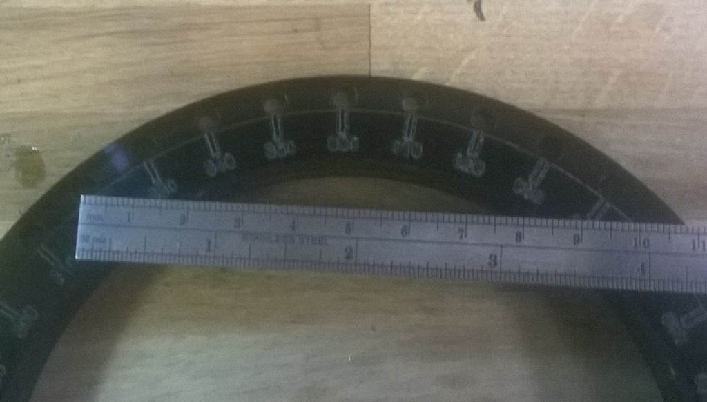

      As a part of a recent project, I have a piece of Black shiny acrylic which has been cut from a sheet on my router and engraved with small numerals as shown in the (poor) photo below:
      scale
      The numerals are engraved 0.25mm deep and although I can read them with difficulty, I would like to highlight them in some way. Am I best just trying to dribble some paint into each individual number or is there a better way? I have thought of try to do this with a "Tippex" pen that I have lurking in a drawer somewhere that has a pump action applicator.
      Edit:  Double-click the image to enlarge in order that you can see how bad my photography is.
      Edited By John Hinkley on 10/02/2023 11:32:30

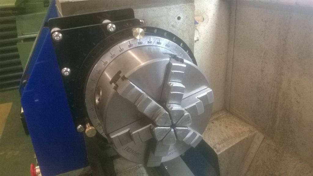

                                            I thought I'd better update this thread. I decided in the end to make a new "compass rose" from 4mm aluminium sheet and superglue it to the existing plastic one. To make the digits stand out a bit, I tried some black Turtle Wax polish I had lying around and it has worked well enough for me to put the project to bed and move on to something else.
                                            Thanks to all those who made suggestions and thus sowed the seeds of my solution.
                                            Here's a photo of what it looks like now:
                                            spindle indexer ring
