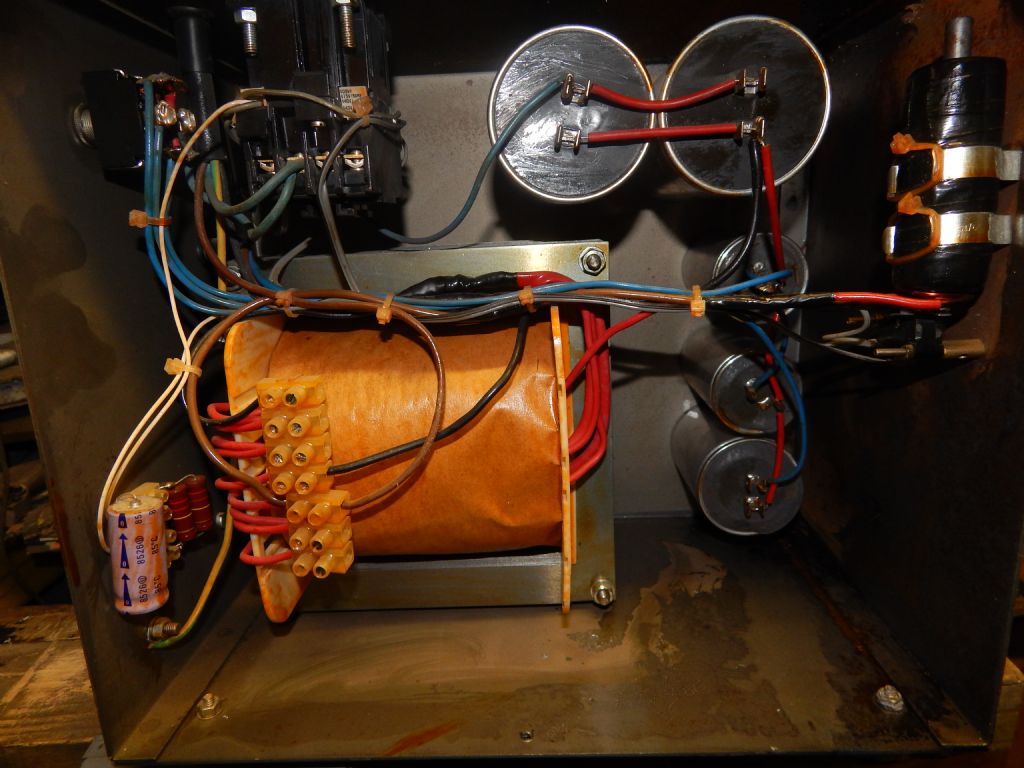

      Hi i have been given a converter and from what it seems it quite old but in good heart. Does anyone know anything about these , please?

          Had 4 HP nominal one for some years. From the transformer I guess yours is also a 240 V in 440 V out (as voltages were then) device which is handy. I have a somewhat scruffy but intelligible PDF copy of the instruction sheet. PM me if its of use to you.
          Worked OK but never really seemed to give a decent phase balance when used as a converter. Three position setting switch just gave a choice of buzzes. Perfectly functional but, having built a few in my time I'm a bit anal about such things. Eventually fitted a big pilot motor on the output, turning it into a rotary converter, which made a vast improvement. Still bit buzzy but fine provided you don't mount it, and the motor, on a shelf. Set the whole workshop buzzing when I tried that!
          Ooops!
          Important thing to remember when installed on a machine with proper, contactor, control gear is to ensure that all the control gubbins is powered off the incoming mains. If you try to use any of the generated legs there will be problems. Even when pilot motor is fitted to make it a rotary converter which theoretically should give you decent power on all three legs. Sometimes it does, sometimes it doesn't.
          Fit a proper contractor on the input. Mine just had a monster toggle switch. Obviously factory.

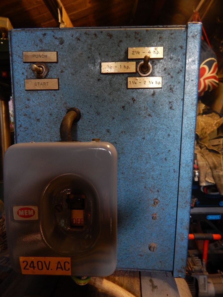

            This has a fused metal box switch on the front it runs up to 4hp through three switches .
            Am clueless what the rod does in theright back as it rides up and down. Looksa lile a solenoid in black  I havent powered it up yet as was wondering what that bit was for.

                Don't recall mine having that rod / solenoid thingy in the back. But it was a fair few years back and I never had to do any work inside. Just lifted the cover, made sure all the connections were tight, blew out the dust and put it to work.
                Its probably the automatic cut out on the starting capacitor circuit. You need extra capacitance in the circuit to get the motor up and running. Once its up to speed the extra start capacitance has to be taken out of the circuit as it upsets the running phase balance. Some professionally built converters just had a manual spring loaded switch that you held down to, temporarily, bring the extra capacitance in. Alternatively there is a simple voltage sensing solenoid operated switch system that does the deed automatically when the generated legs come up to sufficient voltage. I used such on the phase converters I built. The instruction sheet implies that the MotoRun converters are so fitted.
                If yours is like mine there will be a switch on the front with an extra start position, probably labeled "punch" which brings in even more capacitance to help get loaded motor running. Not something to use unless you have to as it really makes an unloaded motor jump!

                  Yes this has Punch and Start on one toggle and three positions on the other toggles switch 2.5h to 4hp, 1/2 to 1hp and 1/2 to 2 1/2hp

                      I'm envious. You got a proper mains switch with yours. I did have the snazzy engraved brass labels tho'. Rust flecked hammer blue paint too.
                      Sent you the PDF of the instruction sheet with a few extra notes and a re-type of the most relevant paragraph. Naturally that was the bit most obscured by the fold. I'll give it a try on the latest OCR program in the next day or two to see if a clean copy can be got. Version I had when i sold the converter couldn't cope.
                      Important thing is to make sure that the phase lines feeding the control gear contactors come straight off the transformer so there is power to the coils and switches when the converter is turned on. Should be Black and Brown wires. Third phase, Blue wire, doesn't appear until the motor is running.

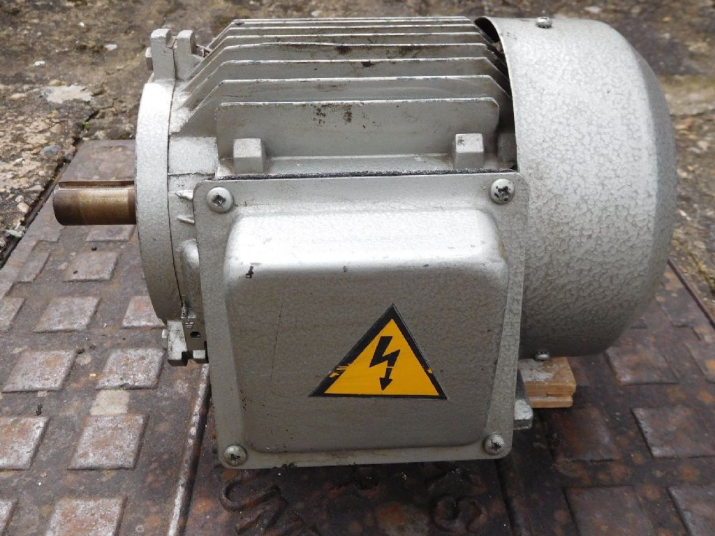

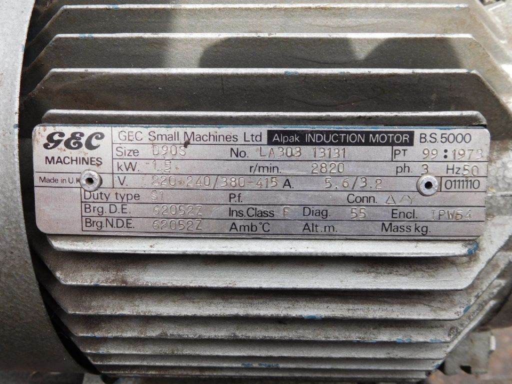

                              Am waiting for my newest adventure in a motor to turn up . Have my fingers crossed with this one

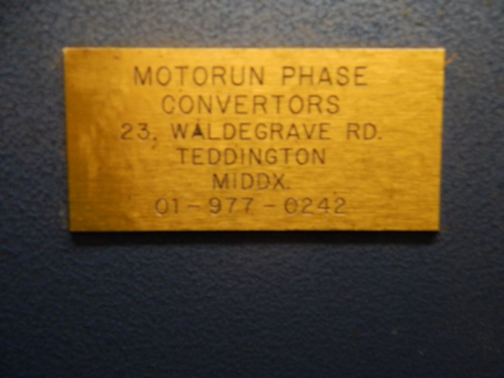

                                        An old tyre laid flat on the floor with a suitable board fixed to the top makes a pretty good poor boys vibration isolator. I imagine wheelbarrow size or similar would be about right for a converter. How effective it actually is depends how well the absorption of the tyre you happen to have matches the vibrations involved but, in my experience, it's always helped. Best if there is a reasonable weight on top. Maybe piece of redundant kitchen worktop for the board as its heavy as well as strong.
                                        Converter on a shelf rarely seems to be good idea. My MotoRun set the whole shop going when I tried that. Very unpleasant and rapidly removed. Naturally muggins put the Bridgeport and other stuff in after hefting the converter into place before testing. So it all had to come out again few days later after being judged unacceptable to make room to safely pull the converter off the shelf. Grrrr!

                                              Hi All, I have got it running with the help of Mike Pool it reverses through Dewhurst coreectly and is looking good . I have to bolt it in and get a new pulley as bore of shaft is larger at 24mm. Curiously the Motorrun Phase converter occasionally trips the shed fuse instead of the house fuse which is unlike the VFD I had.
                                              I have worked out this seems to be to do with the order it is switched on. I am happy the motor I have chosen is larger and more capable that the pathetic power motors I have been advised previously by suppliers to buy. Things are starting to come togethr finally to get it working.
