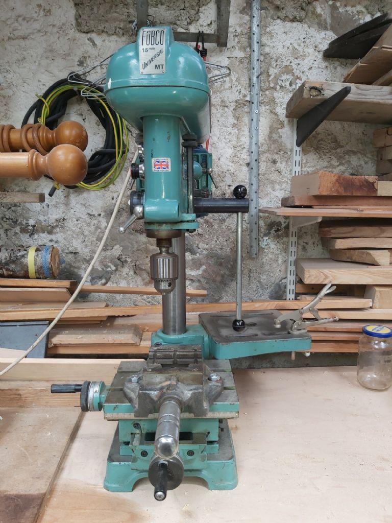

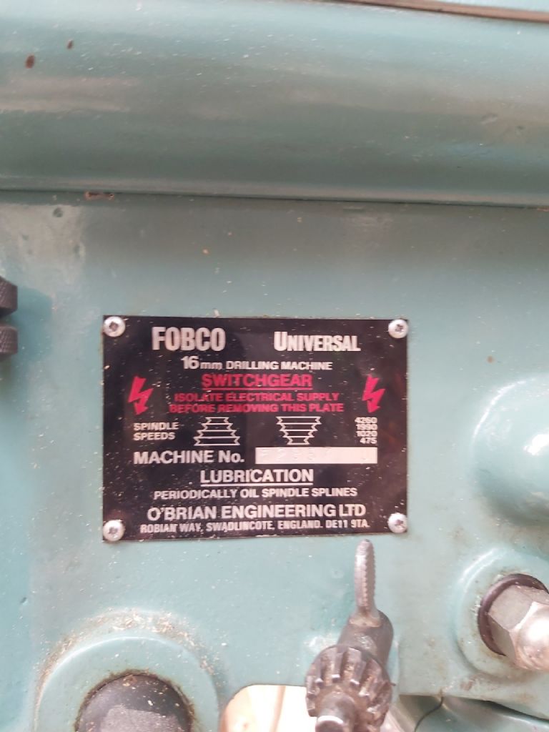

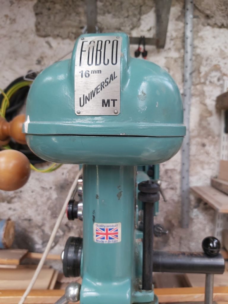

      Hi I have inherited a fobco drill from my farther. I am a total novice machinist but some of the things I have read about this machine seem to suggest it could be used for some light milling. Is this correct? If so what do i need to buy to hold the mill cutters? Could someone link me to the exact part? I believe mine has the "Type D No. 2 Morse taper spindle with a 1.125" x 12 t.p.i. "Myford" nose thread " mentioned on **LINK** . I have attached some pictures of my machine below. Thanks for reading.

          Because of the interrupted cut and side forces during milling, a drawbar is used to hold the tooling in the spindle. Drilling forces are mostly axial and a drill press is not really safe to be used for milling. If you can find adaptors for the Myford thread to hold er25 collet holders, you could probably get away with up to 3/8" cutters. It does depend on the tightness of the quill and the spindle bearings. The er25 can take up to 16mm, but they are rather big for a drill press.

              As above. You can get away with light milling (seen it done on youtube – where else can you watch rubbish practices?&#128578, but sooner or later you will ruin a part, damage something or break something. Likely even sooner if a Jacobs-like chuck is used. On top of that drills are built to withstand axial loads, not radial, so the spindle bearings may soon get trashed.

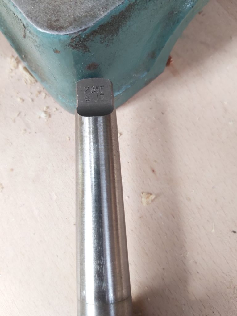

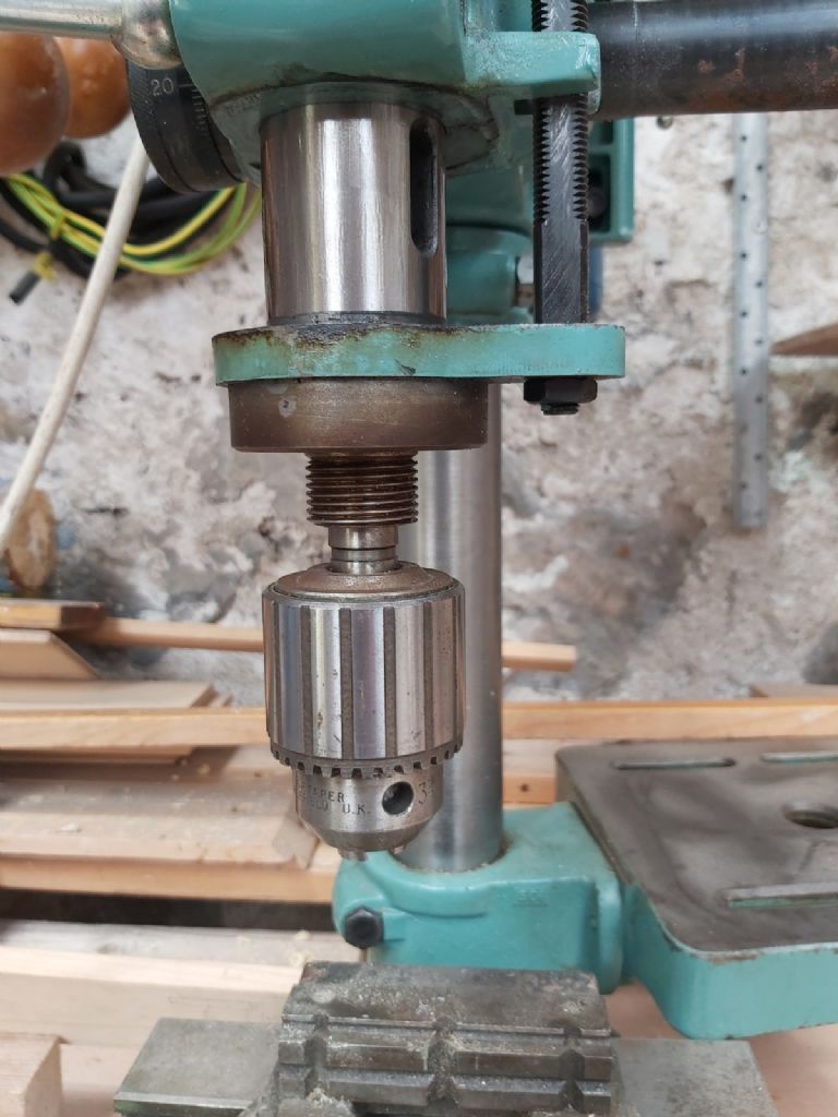

                This might work if the Myford thread on the drill is male.

                  Think i've finally managed it…

                    A nice machine and it has a tiny milling/positioning table. It will be quite safe using the threaded spindle, but as already mentioned, the bearings are not up to heavy milling, which is why I only recommended a maximum 3/8" cutter size. Always lock the quill when taking X and Y cuts. Only use the MT2 for drilling. A better 3" vise is needed, that one will not clamp securely enough.

                      I have tried using a drill for light milling jobs. The spindle nose on my drill was threaded and I happened to have a few Myford MT 2 collets, so I made a suitable nut and used the Myford collets to hold small milling cutters. Up to 6mm IIRC. It worked but when I later got a Sieg X2 Mini Mill I stopped using the drill for milling, I found that the X2 was far better at milling jobs.

                        This seems important … so I am quoting it verbatim from the lathes.co.uk page:
                        Fobco Universal
                        One interesting version of the Star was the "Universal", designed to accept an optional-extra compound T-slotted table for precision co-ordinate drilling and light milling duties. Most (but not all) versions of the model sold came with a No. 2 Morse taper spindle equipped with a nose threaded 1.125" x 12 t.p.i., a worm-and-wheel driven fine down-feed gearbox and a compound, T-slotted table. Cutters were held in collets formed with a No. 2 Morse taper on their outer surface and pressed into the spindle by a screw-on nose cap – the system being identical to that used for Myford lathes. Each collet had a groove cut around its circumference near the end and could be "snapped" into the nose cap. The Myford collet set (actually made by Crawford) had a loading and unloading tool that eliminated accidental breakage of the collet end – this consisting of a tube with a Morse taper on the inside into which you pressed the collet to close it down. Once closed the nose piece could be slipped over the end of the collet and the whole withdrawn from the loading tube – relieved of pressure, the collet expanded and gripped the inside circumference of the nose cap.

                          As I understood things the "milling" capability on the Universal MT was aimed more at surface preparation to get a clean start with a hole, minor cleaning up for bolt head / nut seats and making spanner room. Possibly gasket seatings too.
                          Light work that saves the time needed for a set-up on a proper mill before the drilling work.
                          Milling out a complete part, unless very small being a bit beyond its normal pay grade. As ever with care you can push a machine well past the prudent limits established by the maker who has to think in terms of Penelope Piecework in search of a decent bonus in this weeks pay packet.
                          The operative word being with care.

                            That machine does not have the fine feed worm drive, so it will be very difficult to set an accurate depth of cut without resorting to complicated methods.
                            As far as I know there is no means to lock the spindle either, so getting the collet nut tight will be another issue.

                                      The Myford collets that would be a direct fit are stupidly expensive and only available used I think. I have found that, if you make or buy a closing nut, you can also fit standard MT2 finger collets like these and hold them in the socket with the nut though you lose the extraction feature because you don't have the groove on the outside of the collet. Years ago there was an article in MEW on making Myford pattern collets and also the closing nut I think. Actually I see that the nut and the closing tube are still available from Myford. I have speculated that it could be possible to make an extraction groove in a standard collet, though it might have to be ground rather than turned.

                                            As Andrew says the issue with using the Fobco as a mill isn't spindle strength and cutting ability. Its downfeed control. The spindle is plenty stiff enough for small machine level modest cuts in the sizes of cutter appropriate to its speed range and collet size. Face mills and flycutters would be "optimistic" tho'.
                                            But setting depth of cut to the sort of precision needed for most milling will be very difficult. With the drill style depth stop its clearly designed for bringing surfaces to a constant level and similar duties which it will do well.

                                                The link in previous post takes you to the Myford website where they show the nut and closing tube (which by the way has a straight not tapered bore). Collets are here for example.

                                                      Personally, I would be averse to risk damaging a good machine by using it for milling, even light work.
                                                      Collets are the way to go to hold end mills, IF you must, but definitely not a drill chuck.
                                                      You can use a Mill for drilling, but not the other way round.
