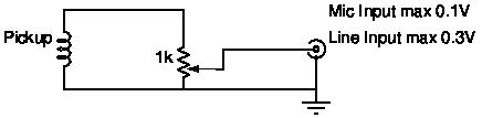

                              Obviously a proper USB oscilloscope is best but I think the sound-card protected by a pot would be OK. Something like this (assuming the pick-up is a coil):
                              The wiper is connected whatever audio input connector is available on the computer – usually a minimum of two 3.5mm stereo jack sockets for microphone input and line-out, but a third for Line-input is common too.
                              Operation: set the wiper to ground and set the wheel and magnet spinning. Use the oscilloscope software or window audio mixer to select the input and set the amplification to about 90%. Then gradually turn up the pot from zero until the signal appears.
                              The maximum input voltages I've noted on the diagram are maximum without distortion. I'd expect a sound-card to have a considerable safety factor, probably at least a volt or two, but don't push your luck!
                              Most sound-cards are AC input, but I don't think it matters for what Tim is doing. A coil will generate a wave as the magnet approaches and recedes which will be seen by the sound-card and displayed.
                              The chief risk of borrowing Robert's Pico is the temptation to keep it!

                                Posted by SillyOldDuffer on 24/09/2022 17:46:55:
                                Operation: set the wiper to ground…
                                And that is the flaw in the plan. It relies on the knob-twiddler performing his duty with 100% reliability every single time without fail after every change to the input conditions.
                                If you could show something with a kind of dead-man's control on it that absolutely cannot put anything into the sound card input without positive human action, that would be the beginning of a way forward.
                                If you can incorporate something in it that will prevent overvoltage altogether (perhaps caused by an involuntary jerk due to sneezing when adjusting the pot), that would increase the reliability of the system.

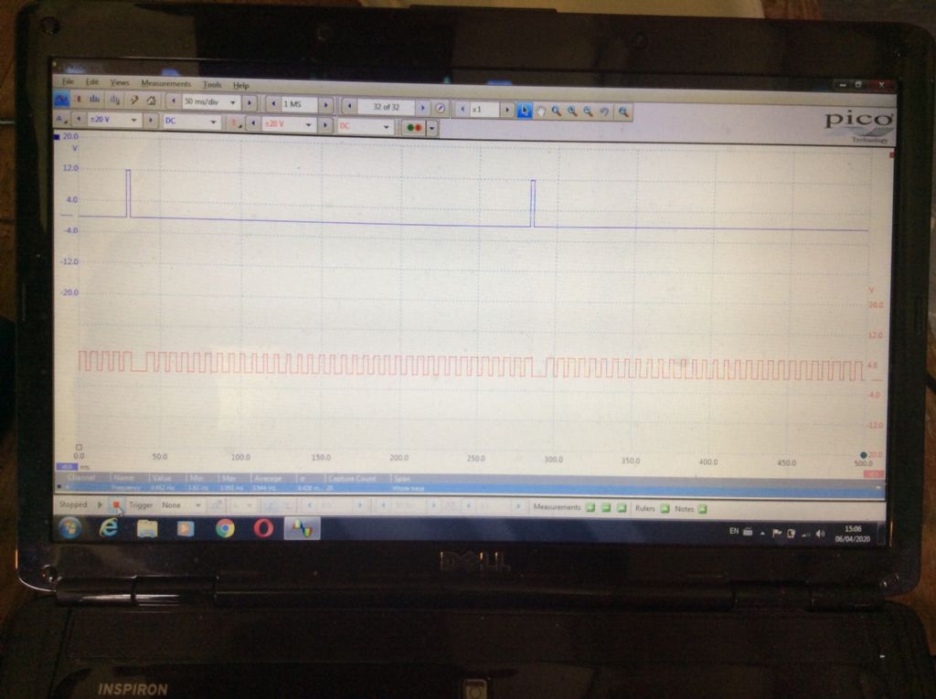

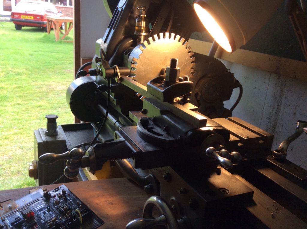

                                          b91fa641-d71d-401d-b3c9-069371669dfe.jpeg9b22cce2-3d4a-4f67-84d6-2ce1c7a1f6c2.jpegHi, I’ve used a Picoscope to show pulses from a rotating disc and a crank sensor (hall effect) , works well.
                                          Red pulses are from trigger and wheel.
                                          There are 35 pulses and 1 gap per rev.
                                          Blue pulses are from HT coil.
                                          Cheapest Picoscope is £114 at CPC
                                          Hope this helps
                                          Maurice

                                                Hi Robert, why wouldn’t the cheapest Picoscope do what Tim wants to do ?
                                                The model I’ve used is the 4225 with the Picoscope 6 software.
                                                Maurice
