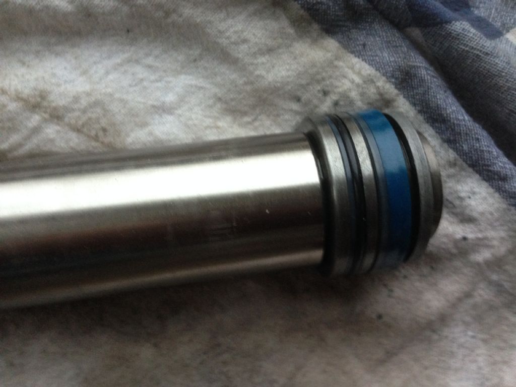

Could be the seal on the piston?
Dave W

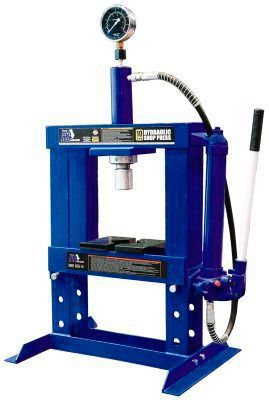

I think we have a winner.
Removed the hose at the pump. Nothing
At the piston. Nothing
Removed check valve. Nothing
Even removed the gauge.. still nothing
Took the piston off the press and over to the bench. Put it down a little to hard, piston retracts and showers me and everything else in oil.
