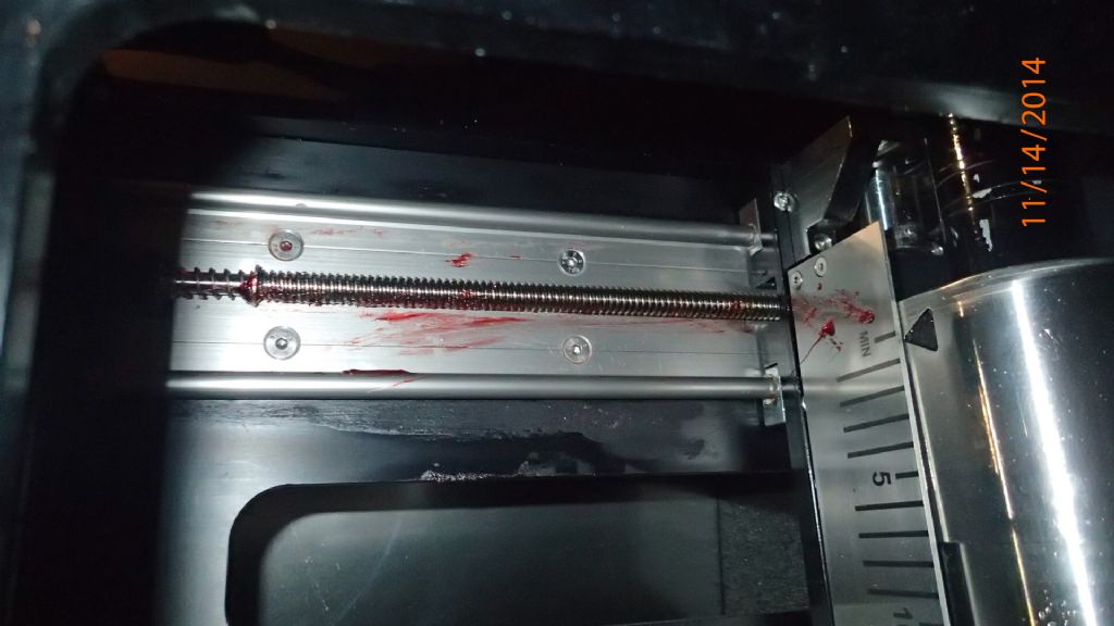

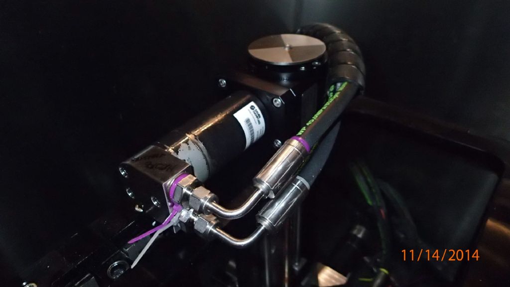

                                      If I was going to do this then I would probably use something as shown in the photographs below. This is also a good example of the type of thing I have to deal with on a regular basis. You are looking at a subsea ROV operated milling machine with hydraulic motor drive to the leadscrews for the XYZ axis and the spindle. This machine is designed for a specific task in the process of removing old spool pieces from a subsea vertical riser. So I'll be doing some milling at 1300 metres. There'll be a plentiful supply of coolant.
                                      This shows an OML series Danfoss motor driving one of the leadscrews. Other pictures show the same motors driving other leadscrews on the unit.
                                      The gearbox and hydraulic drive to the cutter.
