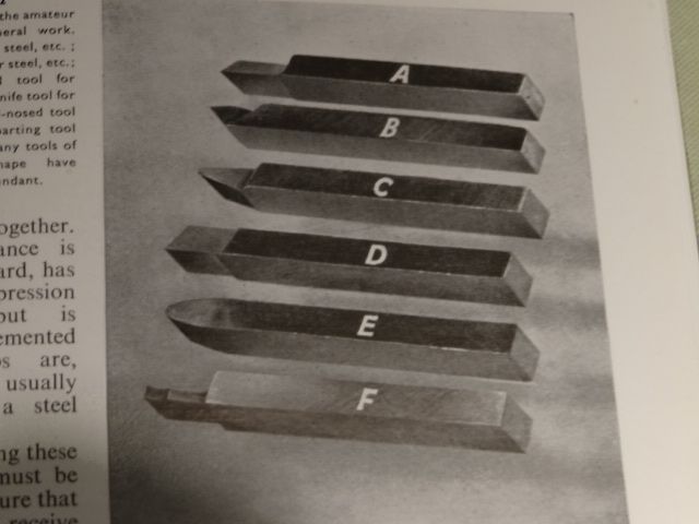

  • #522795
    GingerLathe
      @gingerlathe
      These forums and a google will yield results on suggest tool geometry for HSS lathe tools. However I'm trying to determine the validity of a "Roughing" tool vs a "Finishing" tool. The names are self explanatory but can any one offer an opinion on the use of a finishing tool? Will such geometry make a big difference? Does anyone have angles for such geometry?
      I've attached an example diagram for reference.
      Roughing vs Finishing
      #20125
      GingerLathe
        @gingerlathe
        #522807
        Emgee
          @emgee
          That RH finishing tool looks like what I thought was my LH finishing tool, depends on how it's ground I suppose.

            Mick B1
              @mickb1
              I just use a plain knife tool – with a cutting edge square to the spindle centreline, a plan trail angle of *about* 20 degrees and a point radius of about 20 thou/ half a mm. Leftmost tool in the pic.
              If I'm roughing, I might angle the toolpost to give a plan approach angle of 10 degrees or so, but as an amateur machinist I'm not often in enough of a hurry to do that.
              If I'm finishing, I quite often cock the toolpost over so as to almost eliminate the plan trail angle, and use the trailing edge of the tool almost as a shaving face – small depth of cut, low speed, bit of lube, variable feed depending on results.
              There was a traditional design of finishing tool almost like an over-wide parting tool with radiused edges, used with very low speed, very light cuts and rapid feed. In some respects I guess I'm trying to emulate that in a multipurpose tool.
              I've never really understood the 'classic' profiles reproduced above, and I didn't use them much when I was turning for pay, either.

              #522831
                May I suggest investing in a copy of Sparey's "The Amateur's Lathe"? It answers this and many other questions,
                Roughing tools are shaped to remove metal quickly without regard to finish. In the event they don't produce a decent finish, the geometry of a finishing tool should do a better job. Sparey suggests getting to within 20 thou with a roughing cutter before switching to a finishing tool for final accuracy and finish.
                Here;s what Sparey says about the GingerLathe's shapes: The orthodox round-nosed tool for steel, as usually recommended, is too broad for use on a small lathe, and "chatter" on the work takes place.
                The book gives angles for 8 different shapes covering steel, brass, and parting-off. But Sparey notes: Very rarely will the amateur be able to grind to exact angles without special grinding jigs, but experience shows that slight variations make little or no difference in general practice. Theoretically correct angles are, however, important when utmost cutting efficiency is required.
                I work mostly with inserts, switching to HSS when a form tool is needed or I have trouble getting a good finish, I almost always go for Sparey's Knife tool A, which is square section HSS, with 5° relief on the forward face and both sides, and about 55° ground off the top.
                For roughing the tool is used at right angles to the work. For finishing, the tool is angled in towards the headstock so the full length of the top edge is close to the work.
                #522846
                  I agree with SOD. In historic books there are usually far too many suggested shapes out there for HSS tools. Possibly this goes back to carbon steel tooling and foot powered lathes.
                  A selection of left hand and right knife tools with different end radiuses will meet most needs and can be angled in the toolholder for roughing.
                  (The reason for the angle is that it allows for a wider, thinner chip for a give depth of cut and rate of metal removal).
                  Other HSS shapes I regularly use are either form tools/threading tools or parting/grooving tools.
                  For general use I am a fan of inserted tooling.
                  #522859
                  Howard Lewis
                    @howardlewis46836
                    As the name suggests, a roughing tool is intended for removing larger amounts of metal. How much will, depend on the machine, its rigidity, power and the rigidity of the tool holding. You may take a 6 mm deep cut on a big lathe, but that would probably wreck a mini lathe. (The mini lathe Operator Manual says that for roughing do not exceed 0.010" (0.25 mm), although used with discretion, deeper cuts are used by many )
                    A rougher can be a plain knife tool.
                    The greater the length of the edge involved in cutting, in general, the more prone to chatter it can be.
                    Chatter can be induced by grinding the tool to the wrong clearance or rake angles for the material being machined.
                    Too large a top rake can induce dig ins or chatter because of the deflection of the tool caused by the cutting forces.. Parting tools can be particularly prone to digging in. (I use a parting tool with no top rake, in a back toolpost.. But this is not always possible with some lathes )
                    A finishing tool, will have a small radius on the cutting edge, which combined with a fine (low ) feed rate, and shallow depth of cut should produce a good surface finish. Lubricants can improve surface finish, even when the optimum speeds and feeds are being used. Ideally, the radius should be a little larger than the depth of cut and feed per revolution.
                    What was shown as a finishing tool is, in my view, a Left Hand tool, used in certain circumstances, to cut away from the Headstock.

                    #522868
                    Simon Williams 3
                      @simonwilliams3
                      Assuming we're talking HSS here, there is no such thing as a roughing tool, and of the two shapes shown in the original post the right hand one is a left hand tool. As has been said by others.
                      "No such thing as a roughing tool" is a sweeping statement, but on a small power lathe it is impossible to get enough power to the cutting edge to take advantage of shaping the tool cutting edge to cut freely and easily so as to maximise the metal removal rate. The best you can do is to remove metal efficiently, which means shearing it off the workpiece cleanly and quietly, without tearing. That's done with a finishing tool. The only difference between a roughing stage and finishing is freshly sharpening the tool, giving it a lick with a fine carborundum stone to make sure the edge is good. Putting a radius in contact with the cutting zone is generally counter productive. However you do need to take care setting the angle of the tool face so it takes a shearing cut off the remnant work (we're talking turning a cylindrical surface). Too long a shearing interface gives rise to chatter, so anything wegge shaped or cutting a chamfer is counter-productive.
                      Achieving a fine finish is partly about having something other than point contact between the cutting tool and the work, which is where the misconception about putting a radius on the tool originates. A radius on the end of the tool is there to extend the life of the tool, not to give a fine finish. It will give a better finish than a point tool (zero radius) but that is a red herring. Fine finish on a small lathe is about having a shearing action going on at the work/tool interface, and above all not letting the freshly sheared metal pressure weld either to the tool or the work piece it just left. That's partly (largely) why HSS tools like cutting lubricants.
                      For best efficiency with limited power at the cutting edge, the tool cutting force reaction should be at right angles to the tool travel. That isn't the case with a radius as the cutting interface, but it is exactly how the traditional knife edge tool operates.. If so, this has the result of no lateral force on the reduced diameter after the chip has left the work.
                      Carbide tools use a completely different process to cut metal, and by and large if you want a better surface finish change to a fresh tip, then go faster, deeper quicker till you find the sweet spot. That's because the cutting action is a hot form action away from the tip of the tool – the tip itself isn't shearing metal like a HSS tool does, it's causing a pressure zone.
                      All of this is covered in the books recommended. though Sparey (love him to bits) spends time discussing carbon steel tools, which is of his time. The recommendations he makes for those tools translate well to HSS
