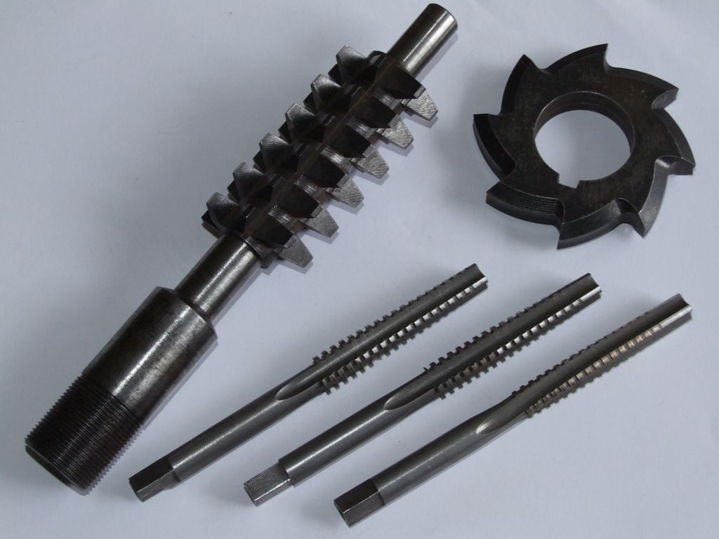

                                            Anonymous
                                              Posted by Neil Wyatt on 17/03/2015 15:17:23:
                                              You may be right, I would tend to believe a chef on how to make a souffle………..
                                              Given the number of 'save my restaurant' and 'kitchen disaster' programmes on the television, I'm not even sure I'd believe a chef on making a souffle…….
                                              Thanks for the information. It seems that there is no real scientific explanation for carbon steel taking a sharper edge. It is certainly a fairly widespread belief within the knife making community that carbon steel is better, and it may be, but I don't think it is applicable to machining. A thin knife edge isn't going to last long when cutting metal. Cutting metal is more of a shearing process, where other factors are also important such as BUE and wear on the top of the tool.
                                              While there is a correlation between tool finish and work finish it is not necessarily unity, it depends upon the purpose of the tool. Certainly for a form tool the detail surface finish of the tool will be reproduced in the work, but for something like a standard knife tool the correlation between tool finish and surface finish is less clear. When grinding HSS toolbits I normally run a diamond hone across the tool after grinding, but I do use quite a coarse grinding wheel. I would agree that the smaller the work the more important the tool finish, but I don't do small stuff! All these tools were made from carbon steel (silver steel or gauge plate):
                                              The reliefs on the taps were ground but the spline and hob cutters were used straight from machining without any honing. They cut fine on steel.
                                              I have the book on hardening and tempering by Tubal Cain, and agreed there is a lot of useful information in it. However I think he is wrong on carbon steel being harder that HSS up to a given temperature for cutting tools. A search round the internet gives a range of hardness for HSS from 63-67 Rc. I've made a rough measurement of hardness on a couple of bits of old HSS, and they are both greater than 65Rc. The datasheet for Stubs silver steel gives a maximum hardness of 66Rc; at the upper end of the range for HSS. However, once the silver steel is tempered at, say 200ºC suitable for cutting tools, the hardness drops to 60-62Rc. The data that comes with my gauge plate doesn't give a maximum hardness, but I would think it would be similar to silver steel. For tempering at 200º it gives a range of 60-61Rc. The maximum and tempered hardness figures for silver steel and gauge plate are borne out by the measurements I have made when making the cutting tools shown above. Given these numbers I don't think it is justified to say that carbon steel is harder than HSS at low temperatures. The measurement of hardness is not an exact process anyway, certainly when using the indentation method, as it depends upon how the hardness varies with depth.
                                              One last snippet, Swann Morten surgical scalpel blades can be bought either in stainless steel or carbon steel. Presumably the choice is up to the preference of the individual surgeon. My last major operation didn't involve scalpels, so there would have been no point in asking the surgeon. And I'd already niggled him by asking too many technical questions about the equipment to be used which he couldn't answer!
                                              Andrew
