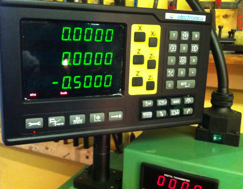

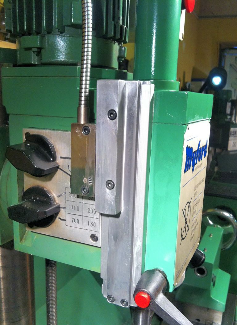

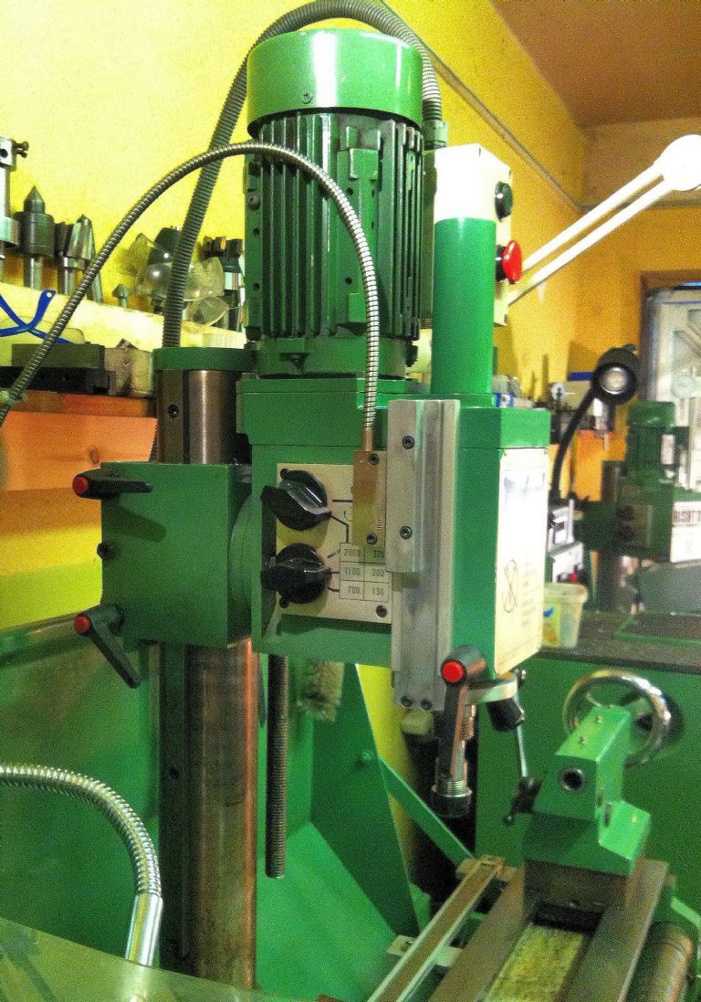

                                            ray jones 1
                                              @rayjones1
                                              Hi, I have modified my RISHTON mill, which is very similar to the ones listed
                                              It is fitted to a MYFORD 254 .
                                              I had four parts to make,
                                              1/ the clamp for the quill.
                                              2/ the base for the slide..
                                              3/ the slide itself.
                                              4/ the reader head base to hold the magnteic pickup.
                                              The reader head is then connected to a spare port on my 3 axis DRO .
                                              My DRO is accurate to 5 MICRONS, – 2 tenths of a thou..
                                              front of mill showing quill clamp
                                              side of gearbox showing slide, reader head and base holding sensor tapemill4.jpg
                                              DRO showing quill setting 0.5000.
                                              Edited By ray jones 1 on 05/04/2013 23:34:16
