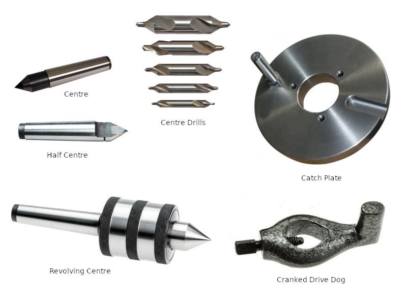

                  Journeyman
                    @journeyman
                    Posted by Steviegtr on 19/01/2020 00:22:23:
                    … Oh & that live centre in the above picture is made of butter 1st time used yesterday & the point is kna— all ready & no it was not bottomed out. Wonder where it was made. Sheffield ????
                    The centre shown in the picture could well be a "live" centre designed to go in the spindle and may therefore be soft. A centre in the tailstock is a dead centre and should be hardened and used with grease/tallow in the centre drilling. The other type of centre for the tailstock is a rotating centre.
                    So Live – spindle, dead – tailstock, rotating – tailstock.

                      Picture looks to show a rotating centre if that is the one being referred too. Appears to have a couple of round holes in a retaining ring holding bearings for a peg spanner? You need to be doing something wrong to screw the point on a rotating centre if the bearings are ok!

                        Ctr hole has been drilled too deep so that it is full diameter of the bit leaving a hard edge to mash the revolving ctr. You can see it better by clicking the image in the earlier post.

                          Good spot Jason. Revolving centre that revolves should have still gone round though despite being up against a hard edge? Maybe excessive pressure from the tailstock too? Maybe as Journeyman suggested it wasn't the revolving centre in the picture he was using, that would do it. No sign of grease or tallow though if it was.

                            I put some castrol edge on the tip & it was turning. I may have put too much pressure on it & I had no lead drill when used, have one now but used ordinary drill so wrong angle. So probably is my fault . I thought they would be made from a hard material. It files so easy so very soft. When I bought it I asked for a live centre & that's what I got. Some are saying it is not a live centre but a revolving centre. Can someone explain the difference. Surely the lathe tools sales guy would have known.??

                            Journeyman
                              @journeyman
                              Image below might help:
                              Live & dead centres are the same just that a live one can be soft whereas a dead one must be hard. The "live" bit is because it goes round as it is driven by the lathe spindle. The  revolving centre has inbuilt bearings which allow it to rotate when driven by the workpiece.
                              (Image is from my website Journeyman's Workshop might throw some light on things, there's a lathe glossary on there as well)

                                  Just to add to that the soft live ctr that goes into the headstock is soft so that it can be trued up in position for the best possible accuracy.

                                    After reading the comments it is clear to me that I should have waited until I had a centre drill instead of using a normal drill with the wrong angle. The centre was pushing against a sharp edge effectively. It was turning but was new & a little tight. I did oil it but have since put some penetrating oil in it & it turns freely now. So just re-oiled it & all good. Thanks. Also the backplate was spare & I know the wrong one really but should be ok. As some said it may go out of balance, but won't think it should be a problem run slowly. It is a make do until I find a more suitable one. Strange that of the 3 backplates that came with the lathe , that is the only one that screws on fully. I think the other 2 must be from an earlier model.
