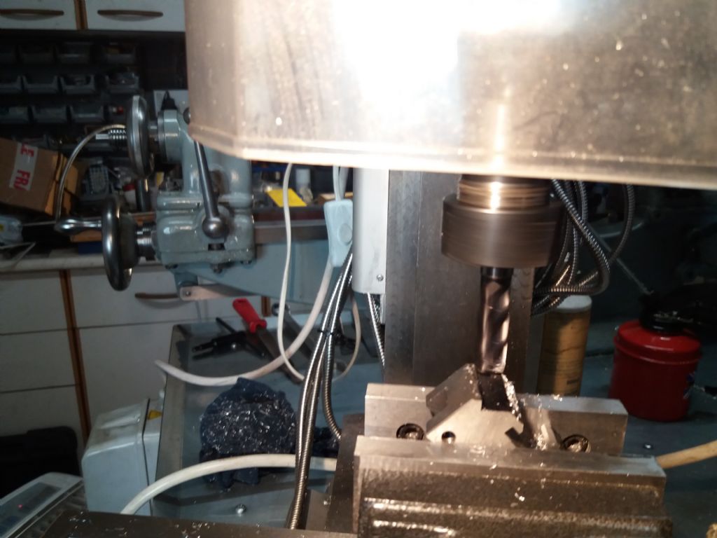

        I have purchased 4 tool posts to go on my Myford super 7B These are to fit a wedge type quick change I have ordered from the states. Being the clever twit I am I watched a few vids of people modifying the cross slide tool post bed. I had 4mm machined of mine. surface ground at an engine builders. Watched Steve Jordan doing it. The big but, is that they were all fitting the 250-000 holder . I decided to go for the beefier 250-100 which is around 3" square. Much larger than the 000. All good until the posts arrived & are much deeper than the 000. So even with the 4mm ground of the cross slide (is it called a cross slide???). So that I can fit up to 13mm tools in the slot the height is still too high. It means I need to grind/ mill or whatever 4mm from the base of each tool holder. No problem as they are very thick at the bottom so I see no problem with strength. I gave one to a friend with a huge milling machine. Not a beaver but as big. (Story. The council where he got it & his Colchester lathe said if you buy the milling tools that we have for that mill, you can have the machine free. He said how much. They said £50. He said yes. He got a huge box of every kind of milling bits you could imagine & a 3 ton machine for nowt.) I digress as usual. So my friend known as Dar of Dar's motorcycles took one of the tool posts & rang me today with bad news. He said they are too hard to mill. To take them to the crank grinders will cost a lot as they charged me dearly for the 1st job. My question to all you guys out there is can I soften the tool posts so he can machine them & then re-harden them. If the answer is yes then please tell me how to. Pretty please.
        Steve.
        #447266
        Hopper
          @hopper
          Stick with your standard toolpost until you learn a bit more about using your lathe. A QC toolpost is a luxury, not a necessity.
          Eventually if you want to soften hardened steel, it can depend on the steel and whether it's case or through hardened etc. But you heat it to cherry red and then cool it slowly overnight, in a bed of lime, insulating blanket, controlled furnace or whatever. Takes a lot of heat to get a lump like a toolpost that hot. Big propane burner and insulating brick hearth required.
          #447269
          Steviegtr
            @steviegtr
            So like cast iron put it in sand to cool slowly. I am used to softening none ferrous coins which require dipping quickly to cool. The only reason I ordered the tool post holder was so that I can set up different tools without having to constantly shim them.

              before you try to soften it think about whether you have the ability to reharden it afterwards without any distortion and what will you do about the scale that will form on the surface.
              What did your mate try to mill it with? It will probably cut with carbide just make sure the cutter or inserts are rated for harder steels say 60 plus Rockwell not 45. Should also turn with carbide too.

                If you try to soften it you will end up with a distorted & scaled part, as Jason B says use the correct hard metal milling tips.

                  20181018_091255.jpgI machined my toolholders and found that they were case hardened. It means that once I was through the hard skin it was less problem but with this type of steel is tougher than through hardened steel and less likley to fracture. The core material does harden but not as much as the skin and i found that a 10mm carbide tool machined them with little problem.

                        Unfortunately my mate has come back to me saying he cannot do the parts as they are too hard. The truth is when I gave them to him I got the feeling it was a job he didn't want. Last night I put a fine file to one corner & it filed so cannot be that hard. They are the ones from either China or India. Someone suggests they may be case hardened. Some replies are not to fit it just yet. So the softening part is a no no. Thanks for the info. If I decide to go ahead. I am left with 2 options, 1st is to set up the milling attachment that came with the lathe & buy some mill drills. Or just take them to the engine grinders as I did with the top slide.

                            Stick the toolpost in your 4-jaw chuck and try one of those brazed carbide tools that you have on it, a lot better than trying to mill it on the Myford
                                        Good idea. Probably much better than using a milling cutter. I might wait until I sort out a backplate 4 the 4 jaw. Thanks.
