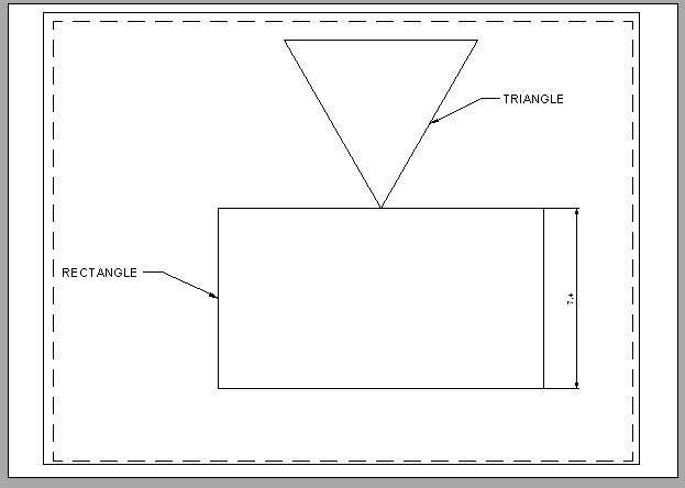

      I have drawn up a part in AutoCad 2000 complete with dimensions and various text fields and would like to be able to rotate the whole drawing through 90 degrees complete dimensions and the various text fields. Using the Rotate option and selecting the bottom LH corner as the Base Point I can successfully rotate the drawing complete with dims but the text fields remain unaltered. Can somebody please explain where i am going wrong.

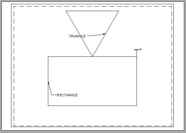

                  Hi – IMG_0732IMG_0733I have attached copies of the piece part as drawn in the vertical position and another showing the same drawing being selected and then rotated through 90 deg with the bottom LH corner of the border chosen as the base point. As can be seen, the piece part and its dimensions have been successfully rotated but the text fields and the outer border have not.

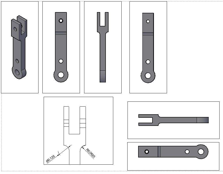

                      You should do the drawing in model space and then go to paper space, create a viewport for the part then add the dimensions in paper space not in model space. This way the dimensions are sized and oriented to the paper you are going to print on regardless of the orientation or scaling of the model. If you put the viewport outline on the defpoints layer (automatically added the first time a dimension is done) it will not print but will show in paper space.
                      This is what I found when checking if AutoCad 2000 had these features:
                      For newcomers to CAD, AutoCAD 2000 is a general-purpose 2D drafting and 3D modelling program. You can mix 2D and 3D objects in the design workspace (Model Space), and can use a separate workspace (Paper Space) for documentation features such as dimensions, annotations and the title-block.
                      Martin C
                      I will just add that viewports can be rotated in paper space and the model will remain in the original orientation but be rotated on the layout.

                          Looking at Greensand’s two examples, seems to me AutoCAD has rotated the drawing and text correctly in the sense computer graphics understand rotation.
                          Possibly Greensands is expecting a mix of rotations and moves, that AutoCAD can’t do in one step.  I suspect he wants the graphics to rotate, whilst text is moved as a human would move it to look good.    If so, that’s a mix of two different transforms, move and rotate, and AutoCAD doesn’t know what the result should be.
                          What should the result look like?   Comparing it to the original would show if the the job can be done simply by rotating the whole drawing, or if the text can be fixed with a second tool, or if the text has to be repositioned manually.

                            This is why you should be using a viewport in paper space on a layout tab. All notes, dimensions and frames (outer border) or details should be done in paper space. You can rotate the viewport and the view of the model will rotate with it. You will find that multi-leader notes will not rotate but will need tweaking to reposition them better. Dimensions will get a bit a confused but can be deleted and replaced with new ones that are correctly positioned on the paper. Drawing everything in model space is what old hands used to drawing boards often did if they had never been shown CAD best practice.
                            There are plenty of AutoCad video tutorials on creating and using viewports available online.

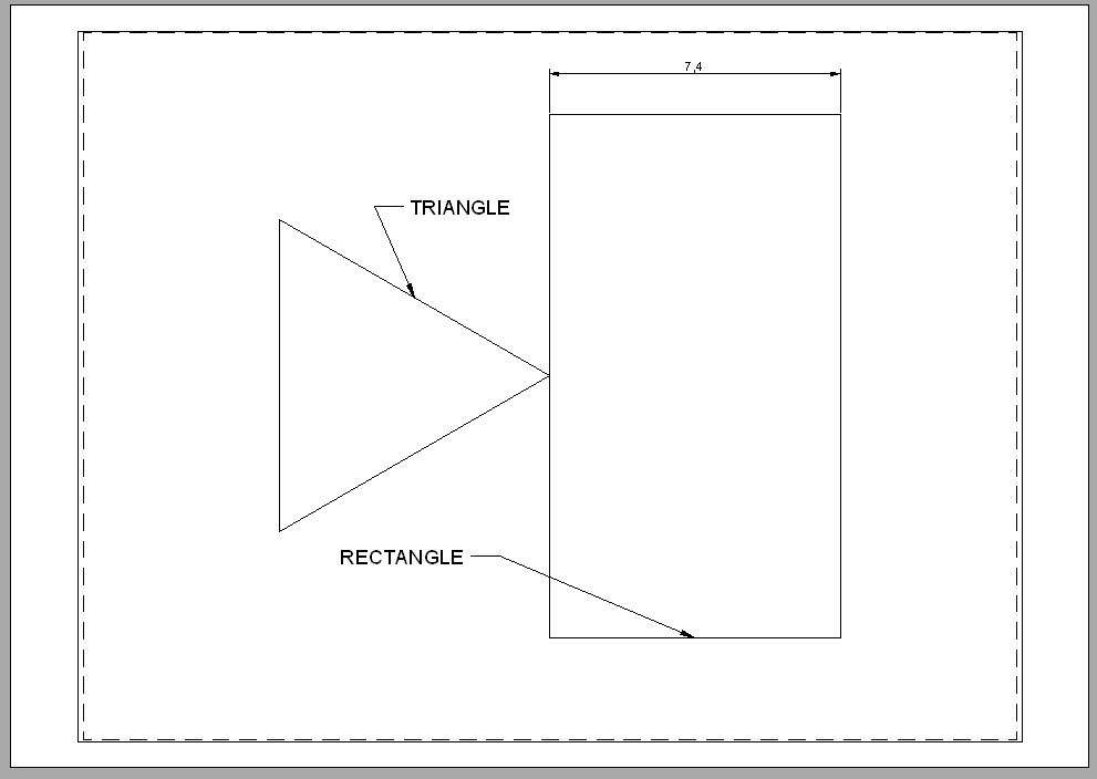

                            Autocad 1
                            Simple model in model space.
                            Autocad 2
                            In paper space on a layout tab, create a viewport and rotate it 90°. Add multi-leader and dimensions.
                            autocad 3
                            Return the viewport back to unrotated orientation, dimension needs redoing and the multi-leader notes need repositioning.

                                I have done a 3D model of this and put a number of viewports on a layout. There is only one model with multiple viewports.
                                autocad link
                                I can’t put a DWG file in the forum but if you want a copy of the drawing file in AutoCad 2000 format to play with then message me with an email address.
