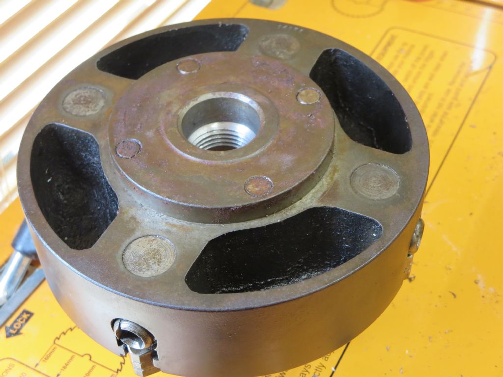

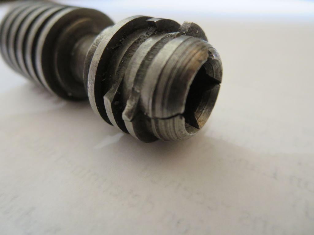

      Folks,
      I hope to repair the jaw screws in a four jaw independent chuck.
      It came with a job lot of tools for a Myford M type lathe, and like them was covered in chicken poop and diesel exhaust carbon deposits. This must be some sort of unrecognised preservative; underneath the metalwork is in pretty fair nick.
      This chuck however was the exception; all four jaw screws have some bits of the thread broken off and a couple have split sockets. The intention is to make a new set, but first I have to get the original ones out.

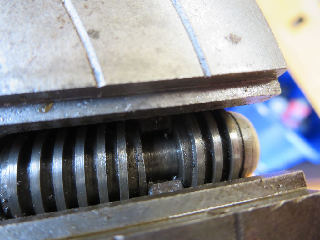

      However on removing a jaw the screw just sits there, it's not free to move laterally and is firmly retained as per the pic below. About 2/3 of the circumference lies around the screw, so it's impossible to shift.img_0087.jpg
      Another shot of a screw showing the yoke which also looks to wrap around the screw by better than half the circumference.
      The chuck body is a single casting, it's not in two parts. The backplate bolts right through.There's nothing to be seen from the front face, but on the back are four blank plugs with no apparent means of removal. See below.
      Any clues? Thanks in advance.

          The clue is under the four blanking plates. Try tapping them out from the front, they are probably a press fit,
          #357664
          stevetee
            @stevetee
            I'm thinking that those circular plugs at the rear of the chuck have some sort of forked section which locates in a groove in the screw holding the screw from moving along its axis. Maybe tap the plugs to take a length of screwed rod and then with a nut washer and a short length of pipe slowly extract the plug.
            #357666
            Trevor Crossman 1
              @trevorcrossman1
              Hi Eugene, make a 'forked' punch from a suitable piece of bar that will fit in between the guide rails of the jaws and bear on the two top faces of the yoke and be clear of the screw, and then with the back of the chuck supported clear of the bench, drive the yoke out to the rear., the dust cover will come out first. I have several similar chucks, mine are old English 'Crown' make, and I mark each yoke to match its original hole.
              Trevor.

                Thanks lads,
                vintagengineeer …. there's no way to tap them out from the front. The screw sits in the way.
                stevelee …. I'd thought of tapping and threading the plugs and using a hot air gun and something like a hub extractor to pull them out too, but I wondered if anyone if the forum had any experience doing it.
                It's really aggronoying; I've serviced another four jaw and it was dead easy, remove the jaws and the screws just fall out.

                    Trevor's is the only way to get the yokes out and remove the screws. They will be a tight fit so as you say a good soaking in Plus Gas is a good idea. It can sometimes help to give the reverse side a tap to break the seal which will have formed. A little heat is usually a good idea.
                    They usually come out eventually. I have dismantled lots, and only had to give up on one which just wouldn't be shifted crook

                                  In those chucks of this type I have worked on, the plugs and 'fingers' that surround the waist of the screw are hardened and I believe they are pressed in. I have knocked them out using a punch from the inside, but it is hard work and can swell the fingers.
                                  Hillclimber's trick of heating the body in the oven to start with is not one I have tried and it might make all the difference.
                                  Regards Brian

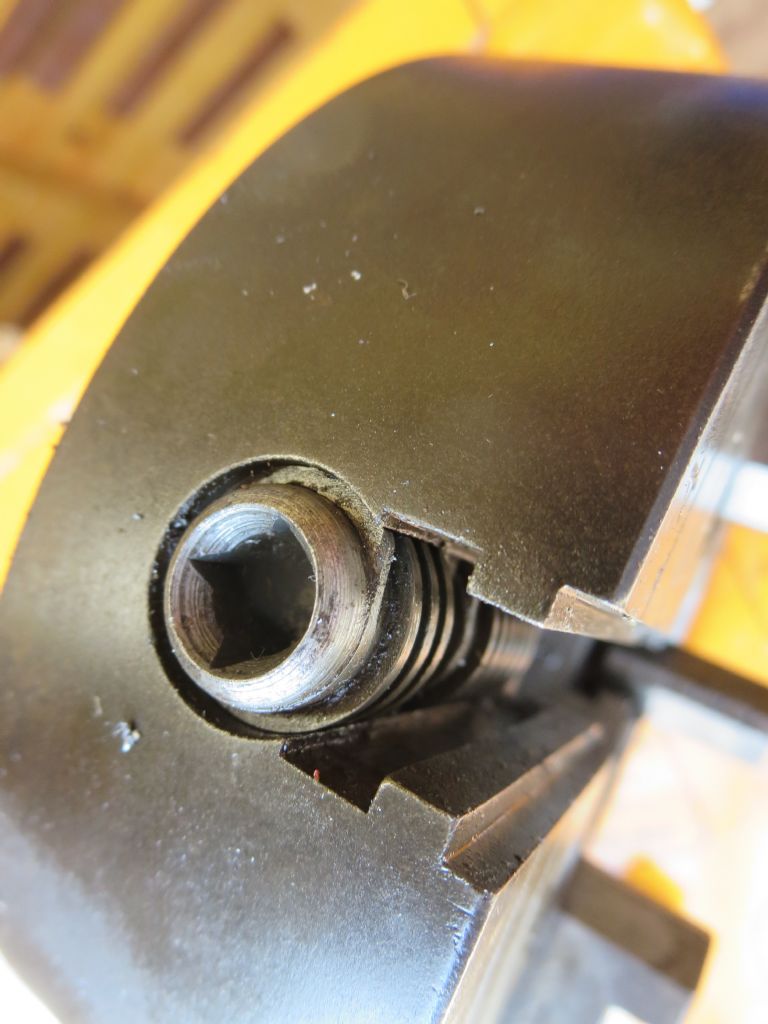

                                        Well, it was easier and quicker than I imagined.
                                        Twenty minutes with the heat gun followed by a good soaking in penetrating oil overnight and number three jaw came out as sweet as a nut; I've no doubt the others will do the same.
                                        It's a bit weird to feel sorry for inanimate objects, but I think we'd all have some sympathy for number three, as below.
                                        There's other chunks missing at the far end on the obscured side. As the late, great, Spike had it "Seen better days but not taken part in them".
                                        A point of interest ….. the yoke horns each had the distinct imprint of a punch mark; not me M'Lud, I used a piece of turned down silver steel with a flat face. Also there was no debris from the broken threads, and some of the flakes would be a bit big to find their own way out. My conclusion is that whoever savaged the chuck disassembled it and removed the rubbish, then put it back together with the screws as is. Shining.

                                          The jaw screws are usually soft so you can make a matching square form screw,, they are not ACME form, drill a hole in the end to suit the A/F size of the chuck key and cut out the corners with a triangular notching tool laid on it's side, working as a keyway cutter.
                                          Check the square form screw with the jaw to be sure they fit snugly before finally turning the 'waist' to fit the fork in the holding plug
                                          I would though use decent steel for the screw, something that you can harden to light blue temper at the square socket end to resist splitting out of the corners in use, don't make it so hard it is brittle.

                                            I've just checked with a mini hacksaw blade; the core dia. under the yoke is soft, and the socket end is hard and won't take a cut.
                                            Again, the part under the yoke has a punch mark in it; I guess it was reassembled too tightly and the guy relieved it by knocking it back a bit. Fair enough if you use something soft, but pretty crude work with a hardened punch.

                                              Tricky bit on re-assembly is to get the forks exactly 90° to the jaw guides. The forks on mine were about 20 thou narrower than the jaw guides so it could be assembled from the front. Slipping the screw into the fork and eying up against the jaw guides before things were too far home worked well enough to get it all lined up using a spanner to turn the forks.
                                              If yours is the same as the similar small one I did a fair few years back the forks will need to go in from the back so alignment is much harder. I made a screwdriver thing with a blade a nice fit in the forks and worked by eye twisting as required with the forks only just far enough in the body to be secure. Got there in the end but if I ever do another one I shall make up a guide with a similar blade on a part circle extension narrow enough to be nice sliding fit between the jaw guides. Jaw guide end probably needs to be rather wider to give nice long flat for good alignment. Needs to be made long enough so the forks can be slid well onto the blade before they start to go into the body.
                                              With the forks mechanically aligned you can concentrate on getting them to go dead straight into the body. Its a knack. Odds are they will be determined to go bit off square. Naturally you will get the hang of it for the fourth one!

                                                Like a twit I thought I could push the yoke / plug out to the point that the screw would come free, and then just knock it back in without worrying about alignment. That's actually the exact point where the plug comes totally adrift, drops on the floor and rolls under the table saw. It's not over stiff in the bore, just very scratchy; I tapped it out with a light pin hammer.
                                                The state of the bore surprised me, it is very roughly machined; a bit of work with 800 emery on a dowel took some of the high spots down a touch and things are much smoother. Still a press fit but civilised and no longer graunchy. On reflection, it might be the bore is galled from fitting the plugs dry, with no lube; that would chime with the other abuse.
                                                On reassembly I plan on using the heat gun on the main casting to make wiggling the yoke around that much easier. Maybe even put the screw in the freezer for a while. I'll do a few dummy runs with the existing parts by way of experiment.
