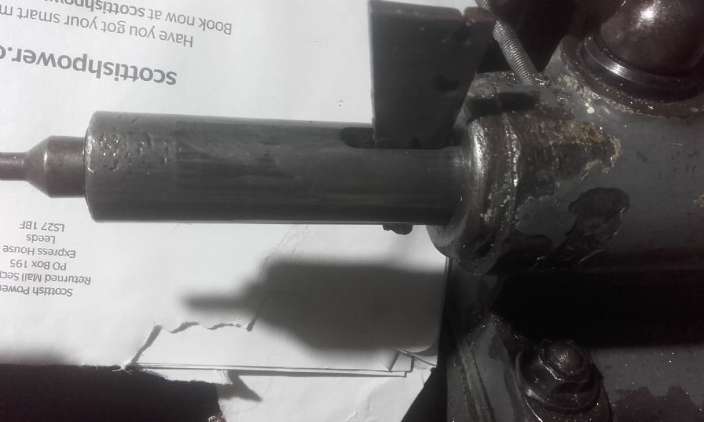

      How do I release the tailstock MT1 chuck or centre from my Portass PD5 lathe?
      Thank you – Rowan

          Hi Rowan, if the tailstock barrel is the hollow type, a piece of steel bar, probably 3/8" diameter long enough to reach the Moorse tapper, and then hit the end of the bar with a hammer.

            As Nicholas says the tailstock poppet barrel is hollow. Either a gentle tap with a hammer on a suitable drift as Nicholas suggests or make up a slide hammer style knocker by using a longer drift with a handle on the end. Spare file handle perhaps or just a simple graspable size lump of metal.

                Users of the Myford lever-operated tailstock can simply unclamp the lever and use that as a drift; to facilitate this my clamp has a ball handle. I mostly use a drawbar, however, and this is loosened a couple of turns and tapped to release the taper tool (the copper hammer is in a terry clip!).

                  It would lessen the impact forces on the threads and nut if the quill was locked before removing the tooling.

                      I got fed up of banging mine out with a hammer and drift and made a 6mm slot like the big drills have
                      Sometimes they can get pretty tight
                      Tap the taper release drift to shove it out, its a roundbar welded to the back of a triangular flatbar
                      And always remember to lock the tailstock and tailstock spindle before assaulting it by whatever means you employ
