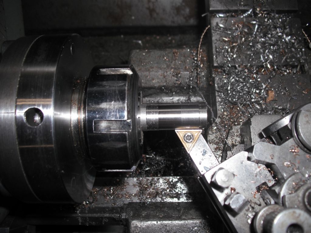

      #202684
      Muzzer
        @muzzer
        This is 0.45% carbon steel (1045) with an unground (yellow) CMMT insert . Even without a ground insert you can get a decent finish.
        1045 steel
        The skill is often to make sure you take a decent final cut rather than tickling it. This requires confidence in the use of your dials or DRO (if you have one – I don't). And use higher speeds rather than lower. This is often the opposite of what you might do with a HSS tool which may be why people struggle to get a good result with indexable tools.

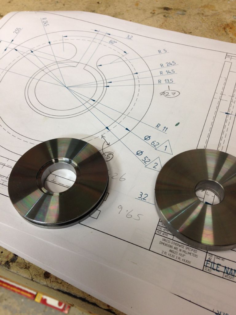

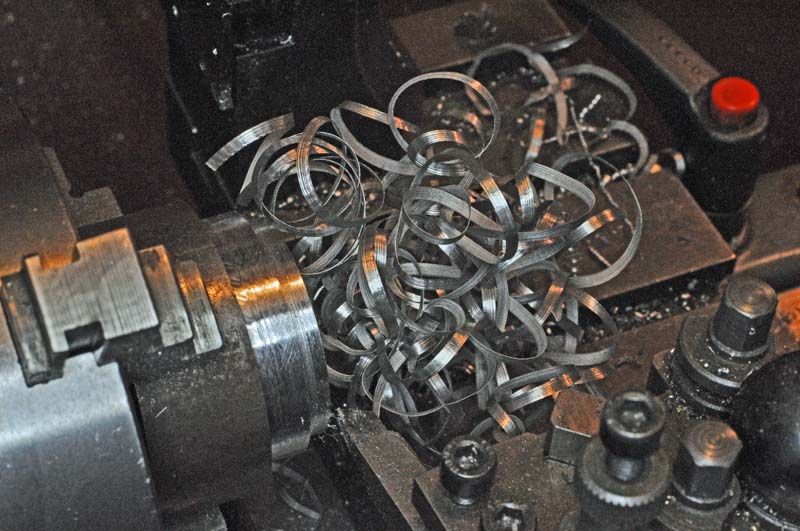

              #202730
              Muzzer
                @muzzer
                I got lucky with that stuff. I found a 15" length of it in the offcut bin and bought it for peanuts. The guy behind the counter had to check with his supervisor that it as OK to sell it at scrap value. He was obviously in a good mood that day. In fact it was a ground finish, so already cleaned up for me.
                These were parted off and the groove was done with an (indexable) grooving / parting tool, so will have been oily as I part off with feed and coolant. But the final facing and counterboring will have been done fast and dry with a decent depth of cut – carbide needs the metal to get filthy hot for it to work properly.
                As Jon says, every machine (and operator) is different. I experimented with feeds and speeds on my Bantam with these tools, turning the speed up and down with the VFD to see how the finish was affected. There are some combinations of feed and speed (and depth of cut) that give good finishes – and many that give a torn, matt finish or chattering.
                One of the benefits of carbide is not having to keep honing the cutting edges. And when roughing out, you can shift metal in a way that would challenge HSS.
