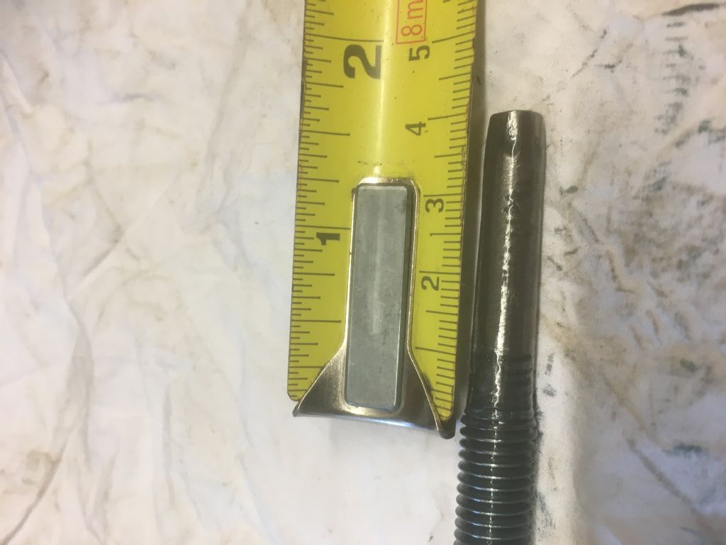

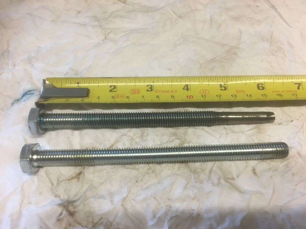

      For anyone who wants to see this part here is the short version of the link **LINK**
      Looking at the picture online I think it looks like the reduced section of the bolt has been made with a grinder. It only has to go down a hole so minimum required for cheapest cost is probably a bench grinder and an unskilled worker.

        How do I attach the pics?
        I know I could grind down the bolt but as I have the lathe I'd like to do the job properly

              Had it been a bolt then my fixed steady suggestion would have been ideal as you would have had the fingerts running on the plain shank of the bolt, your image shows a screw so as Nigel said best not to run on the threaded surface
              Will he hex head fit down your lathe's spindle? If so drill and tap say a 20mm length of scrap, put a length ways saw cut in it then screw onto the hex head screw so 45mm sticks out. Now hold by the split bush you just made and turn to end down to dia

                            For the proportions shown in the picture, I'd think that the screw could be held with the 3-jaw chuck gripping on the threaded secction and the hexagon head beyond the back of the jaws somewhere in the morse taper of the lathe spindle Leave enough sticking out of the chuck for turning down the diameter.

                                Another way: get a 20 cm bolt, chuck up 4cm thread, turn down end near chuck, part off. All sorts of things would work as it looks like accuracy isn't required. I might just spin it in a drill against a grinder to take the thread off.

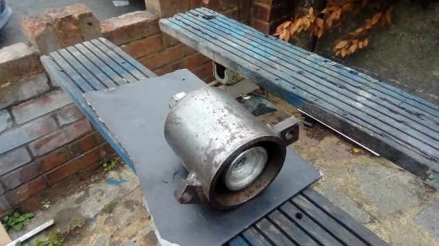

                                          Another thing to consider is that the forcing screw for a puller should be considered a consumable, as it's very easy to bend them or bugger up the ends. So making them from readily available threaded rod, with a nut welded on one end and a foot of some kind on the other or ground down like your pictured example, is more likely to be of use than spending ages worrying about turning a fancy finish.
                                          As an example here's a car hub extractor fabricobbled out of scrapbinium, welded together on the car with no measuring at all:
                                          It looks even uglier in the metal as the whole thing took about ten minutes for my own wheel bearing, but has paid back handsomely doing the same job for several other people.
