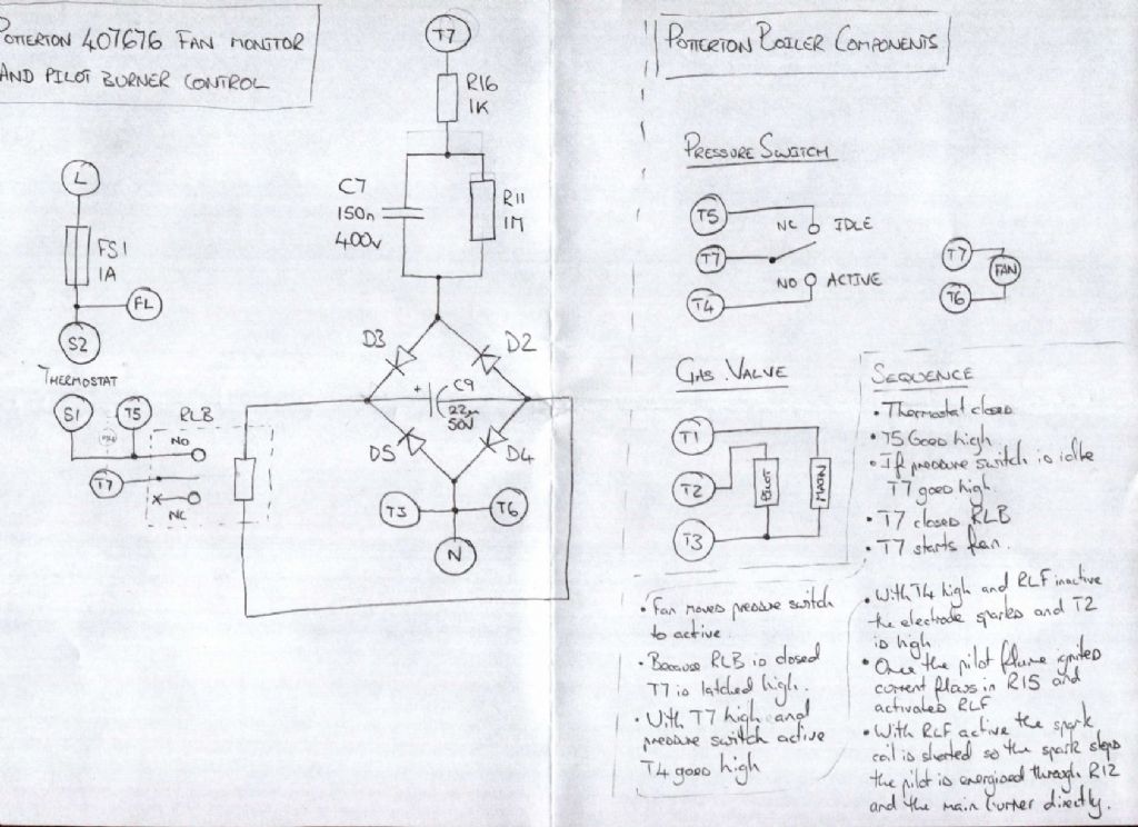

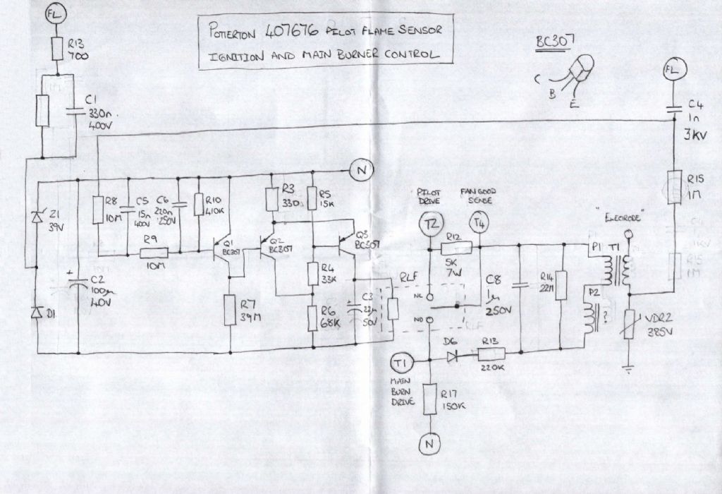

I have a Potterton Netaheat that I have been "nurturing" for three decades, and I can confidently say that the boiler control lasts for fifteen years before it needs fixing. I conducted the fix twice in the same way, and it worked both times. I do now have a spare controller which I swap in when it fails so I have time to fix the old one and keep the newer one at "low hours".
Like John I reverse engineered the controller, and made all those discoveries. I've included the schematic I extracted below. I never thought anyone else might benefit from it, so I never posted it.
The main problem is that C2, which is an electrolytic capacitor, dries out. The flame sensor circuit is very sensitive, and it depends on a smooth DC rail from the mains to work properly. When the capacitor dries out, the supply has too much ripple and the circuit can't see the tiny (around 1nA) flame current.
The world is going to the wall, unfortunately, as we all know. I've been looked at getting my trusty boiler working from a battery and an inverter. As we know security of power provision is looking a little feeble over the coming few years.
With this boiler control the flame sensor depends on an earth connection and it needs significant capacity. If you run the boiler from an inverter you will find that the flame sensor fails even though the pilot is alight. To resolve this issue when using a battery inverter you will need to do two things.
1) Ensure that the boiler earth is connected to the physical earth for your property.
2) Connect the inverter neutral output to the earth that goes to the boiler.
If you do these two things, then a Potterton Netaheat can operate from a battery inverter, even when there is no electrical supply to your home. In these circumstances, the law may not need to get in the way of your probable need for basic hygiene.

Andy, that is a brilliant and very nicely drawn circuit diagram ! Much better than my spidery and confused efforts !
I could have done with yours about 6 weeks ago to fix my own system, but nobody will allow that information, even though it is just electronics, and not touching the gas side at all.
I don't quite understand where Q1, Q2, Q3, get their other supply rail from? The mains neutral feed is one side and presumably 39V is created across C2 by Z1, but the circuit seems one legged to me ? Where is the current return path from the collector's side ? I think that is where I got confused with the circuit and was forced to give up.
I think your inductor, labelled (?), in series with the spark transformer primary is actually a spark gap. I think C8 charges up until it can jump the spark gap which sends a pulse through the transformer.

The supply to the transistors is is via diode D1. They are running from a negative supply with respect to ground. The mains neutral (connected to PNP transistor emitters) is connected to earth at the mains supply.
Robert.
Ah, sorry, me being dim. I assumed "FL" meant flame probe. It means fused live. Makes perfect sense now.

Resistor R10 is presented as two parallel components as is Zener Z1.
My board is version 3 and it would be interesting to know if earlier versions incorporated this.
My assessment is that failure of R10 could lead to detection of a flame when there isn’t one resulting in the main burner being engaged.
In my case, the fault is with the spark ignition resulting in the pilot valve being open but the pilot not ignited.
There is no designed protection against this case (timeout, duplicate circuit etc).
I assume that the resultant gas escape is not considered unsafe because the fan is running and forcing the limited unburnt fuel out of the boiler.
By extension, it can therefore be assumed that the ignition circuit is not a safely critical area and thus can be worked on by DIY ‘specialists’.
