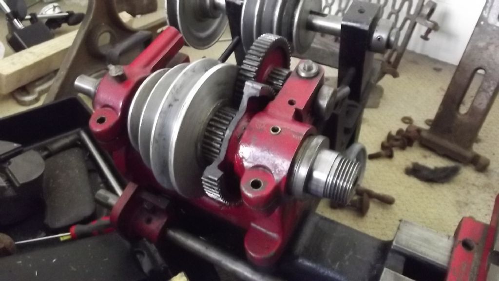

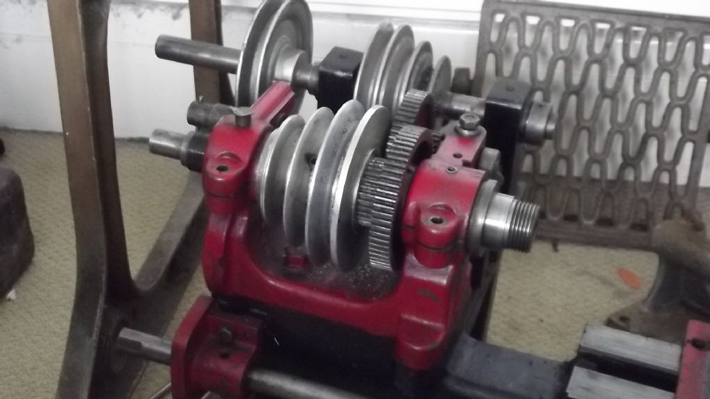

      Need to thread a belt around my pulleys and I can't say I am entirely sure how the get the spindle out. My wizard and adept all you had to do was loosen the screw in the pulley and the shaft would slide out.
      Taking the screw out of the bull gear doesnt seem to loosen it and I'm not sure how to move the backgear out of the way and generally speaking I have no idea what I'm doing. Unhelpful is the fact that googling "Removing ML1 lathe spindle" comes up with only ML10.
      Anyone got advice?

          Just a suggestion, if you've taken the grub screws out of the pulley and back gear – have a look down the hole to see if there's another grub screw lurking underneath, I believe it's a fairly common trick to use 2 grub screws down the same hole as a form of locking to prevent accidental loosening.

              The original belt on this lathe fell off when I bought it because it had become rock hard over the pulleys so I can see the advantages of a link belt but damn they are pricy. When I get a Pultra of Super 7 I might splash the cash on premium belts but for a ratty old Myford clone it seems overkill.
              Also I checked and I can't see any secondary screws. The secondary purpose of getting the spindle off is also because the pulley doesn't move completly free so Im guessing there is some gunk in there that needs cleaning to let me use the back gear later.
              If I take the grub screws out would it be safe to hit the rear of the spindle with a rubber mallet to push it out?

                a rubber mallet will only tiggle it, use a good sized copper mallet with a piece of ali to protect the shaft end, you don't want to mushroom it. I presume it hasn't got removeable bearing caps

                  Your spindle looks as it it has a similar set up to my Southbend lathe, probably about the same vintage. No bearings, just a shaft running in cast iron. Mine did not even have a grub screw, just a key and an interference fit with the pulley and shaft. Removed mine by holding a piece of hardwood on the end of the shaft and then giving the wood a decent whack with a big hammer. One it starts to move it should come off with lighter hits.
                  Paul.

                      On a pinch-bearing lathe a spindle may be quite hard to remove

                        Well I ended up hitting it with a hammer and an ash plank. Got it 3mm out very fast and now its not budging. Will see how continued hammering helps.

                            Think I would try a hot air gun on the pulleys before striking the shaft further……..
                            Cant you place a length of thread rod down the shaft bore and draw the shaft out against the bearing block?

                                        If it went one way and then stuck I would look very carefully for more grub screws. There will be something that allows the back gear to work – when that's in the pulley spins freely on the spindle and the drive is through the gears so the gear on the spindle will be located on the spindle some how. There will be a grubs screw or something or the other locking the pulley to the spindle for when the back gear isn't in use.
                                        So for instance they might key the gear to the spindle and have a slot through the pulley and it's gear (Usually one piece some how) to allow it to be part knocked out that way to allow the gear and it's key to be removed. (Remember that if you ever do get a Pulta – something has to be aligned to get the spindle out. They provide marks )
                                        From comments elsewhere I suspect the grub screw in the pulley is just used to lock it to the spindle. The way the gear right next to the pulley and effectively part of it is attached varies but it's probably a steel sleeve to provide a bearing for when the back gear is in and the spindle runs at a different speed. Might even be bronze.

                                          Pulled a grubscrew out of the pulley and one out of the back gear. As I pushed it through I kept checking with a light at the area between the front bearing and gear to see if a key would appear but non did. I would have thought it would appear by now.
                                          The smaller back gear gear on the spindle probably does just share a common sleeve with the pulley.
                                          The gear didn't actually break from being stuck to the shaft as far as I can tell. It just sort of lost the will to live.

                                            Ouch.
                                            The small gear is fixed to the pulleys.
                                            In normal use the small gear is locked to the spindle by the grub screw and the bull gear is disengaged using the lever.
                                            to use back gear the pulleys are disengaged from the shaft and the gears swung into mesh… but not now.
                                            You might get someone very skilled to either stitch that gear back together or weld it with special CI sticks.
                                            No more hitting with hammers, you might break a bearing next.
