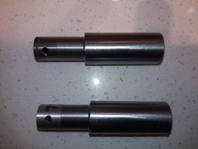

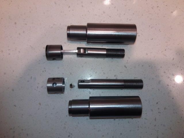

      Here are my piston mandrels MK2 , 1 for pistons with 13.6mm skirt diameter pistons and the other for 13.5mm diameter skirt pistons.
      Then there are 2 threaded pins, 1 for trimming just pistons, and the other for trimming pistons or reworking pistons that still have the rods assembled.
