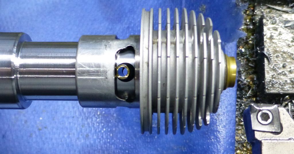

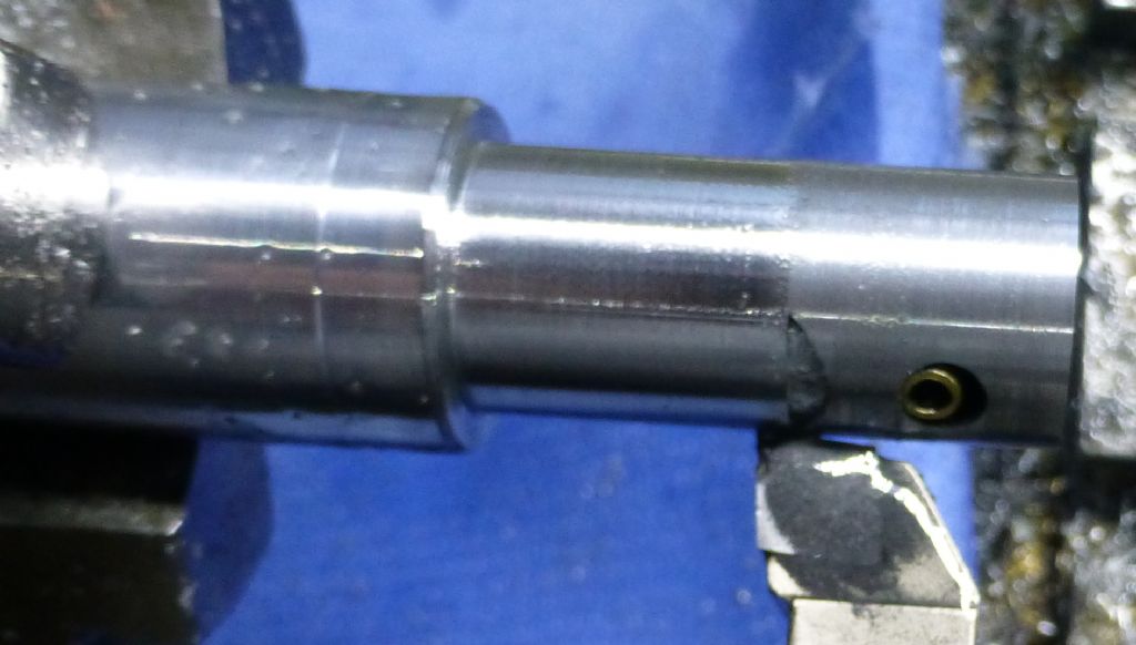

                                            Neil Lickfold
                                              @neillickfold44316
                                              Here is a piston I am trimming for a friends model diesel engine, 2.5cc
                                              I set the compound over to about 0.75 deg, it is actually at an angle so that
                                              every 0.04mm that the compound moves backwards is 0.001mm diameter cut.
                                              With a dti it is set at 0.05mm per 40 mm travel.
                                              One picture shows the colour change with a 0.003mm diameter cut and the other shows the liner at it's
                                              fitted position and the oil colour change for the amount taken off to fit the piston 0.5 mm more up the bore.
                                              The bore taper is about 0.00061mm per 1mm of travel, so about Ø 0.0012 per 1mm travel.
                                              Measured taper is Ø 0.012 for 10mm

                                                  i am using these inserts Sumitomo CCGT 09T304 NAG-H1 Carbide Insert (Non-Ferrous) but am not able to get the very small cuts that you manage to achieve. For the next pistons I am going to lap them to final size. I know I will loose some rpm but I won't scrap so many Pistons during machining.

                                                    Old School, This is the RSA-444 piston material, 30% silicon. With these hypereutectic alloys with high silicon, carbide will not take fine cuts on this material. I finish the end face/ piston crown and rough the outside to about 0.1mm diameter. I then change to the PCD, insert is NP CCMH060204 MD220 , it is a 0.4mm radius and is positive cutting. I chose this small size because of the positive cutting geometry which I could not see in the larger 9mm insert . image here ,http://www.mitsubishicarbide.net/mmc/ja/turning_inserts/no_srs/20043582 I used RiceBran oil in a spray can, usualy us canola oil but ran out, so grab what was in the kitchen. Now have to buy another, she won't use it because I had it in the shed.My win. Anyway, I learnt something new in trimming these pistons. Normally, I have to clean the piston and liner with contact cleaner to get the oil off to work out the dry fit height of the piston. But with the rice bran oil, if I just blew the piston off with compressed air, made sure it was clean and tried the fit. I could get the same fit if I cleaned it all with brake clean or if I just blew off the micro turnings.The diamond insert is expensive, but well worth it. I run my myford at about 500-600 rpm, top speed in the low main pulley. The cut is put on by winding backwards the compound slide. On my one, each division is 0.04mm of pitch, so the slide is set at 0.05mm in 40 mm of travel of the compound slide. I turn the main diameter to about 0.02mm of size, then do not touch the cross slide until it is finished.The cross slide centre gib screw is tightened slightly to not make the axis so free on the hand wheel. I keep oiling the saddle slide quite often as well. after the cut, I wind the compound handle exactly 1 turn forward to bring the tool away from the work piece. I hand feed the saddle at a rate of about 30 seconds to cover the 14 mm or so distance. Measure or try piston and then take another pass. The tool is set as close as I can get it to centreline. Neil
                                                    #213265
                                                    Neil Lickfold
                                                      @neillickfold44316
                                                      Edit, It should read 0.5mm per 40mm, not 0.05mm. Not sure how to edit the post to correct the wrong data.Neil
