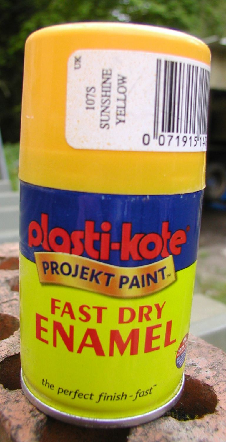

                                      But I do have another question about what you’ve done – which plasti-kote paint did you use, and how did you get on with it?
                                      #67854
                                      Nicholas Farr
                                        @nicholasfarr14254
                                        Hi Steve, it is No: 107S Sunshine Yellow in the 100ml spray cans at about £2.49 each when I bought them. Not sure if they were on offer at the time, but it took almost four of these. They weren’t to bad to use, but they don’t like the cold too much, so I stood them on my oil filled radiater for a while before use, as it was just a little before Chrismas time when I did It, however I did prime the Ally with Hammerite Special Metal Primer first, which I allready had, and the saddle and tailstock had a coat of grey Plasti-Kote primer which I also already had. No real effort was made as it was only intended to be a tidy up job, I’m no painting expert.
                                        The colour match wasn’t exact, but it looked pretty close and good enough for me.
                                        Regards Nick.

                                            Neither am I – and I certainly have quite a bit to do on various refurbishment projects, so I’m very interested in how people get on with the various painty substances they use, so thanks for the info.
                                            As far as the Hobbymat is concerned, I have to repaint the tailstock from scratch. The top of it got somewhat ‘abused’ in its previous situation (heaven knows why), so I’ve cleaned it up and linished the abuse away, but I reckon that the chances of an exact match are minimal – hence having to do the whole thing.
