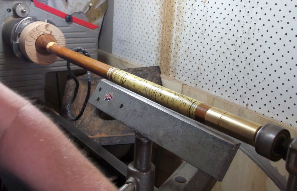

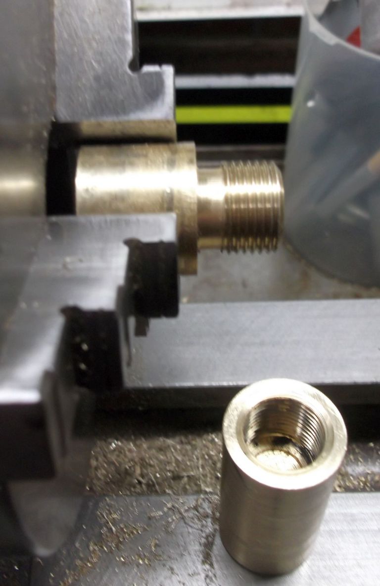

        dscf8213.jpgdscf8204.jpgI put my hand up to attempt to make a screw type joiner for New Zealand Hiking Poles for a fellow I know. They were cut in half to bring home from NZ to AU when on their honey moon some years ago. These Poles are not cheap some $120 each they have a coin in the top of the handle.
        The drawing and plan was for 24tpi but a mate rang to say his boss offered me use of 16tpi tap and die so I jumped at it. I have not cut threads on a lathe for over 40 yrs. I got to dry fit stage today and turned the Pole to suit they are not true round one being very oval indeed.
        Not sure why photos and text stuffed up order. Maybe me and my stuffy head sinus worst this year.

                    Don't worry. Drain rods have a far courser thread, more like 6 tpi. You might want to thnk of a way to stiffen the thread so it doesn't undo from the jarring of hitting the ground in use, yet not jamming up. I suggest graphite lubrication from a smokey candle flame as it isn't slippery like vaseline (you wouldn't use oil on a domestic product I hope) yet prevents cold welding. You might consider putting (metric for long term availability) spanner flats on the joint or they will be tempted to get the mole grips out. Show then the old trick of patiently tapping a brass joint to loosen it if jammed.

                        Had been considered by the owner and other willing to do the job but as I pointed out the stress after boring and weakening the strength of the wood centre it would split, shatter break. The use of an outer sheath strengthens even tho I have removed 1/8th to allow reasonable mating of timber and brass.
                        Link
                        I had a similar joiner as an example to show the owner,
                          Bazyle having used the 16tpiUNF its tight and all that would be required once it wears is thread tape or a locking screw through to the relief area above the thread. Even that could undo.
                          I had considered a Bayonet type fitting with a lock screw but for my level of expertise in machining my limited machines and as job is a FREEBIE I opted for the quickest, stable option that the owner was more than happy with.
