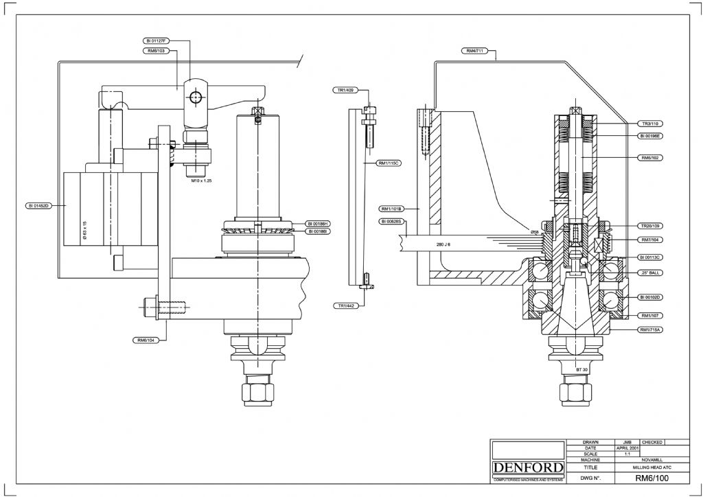

      If we need the high-speed spindle to fit within a 12mm diameter drawbar, then the top bearing is going to be small.
      MR117 looked promising : **LINK**
      http://www.aotengbearing.com/p/nsk-miniature-bearings-mr117zz-p42898.html
      … but may not leave enough wall thickness.
      idea It would be better if we could make use of the 'Counterbore' … is it concentric ?

        Posted by Michael Gilligan on 27/01/2017 16:51:01:
        RM6_100 suggests that it must be …

            The original speed multiplier on the drawing used an A5 magneto bearing at the top and an A13 at the bottom of the collet spindle.

            David Jupp
              @davidjupp51506
              MichaelG – the counterbore at top end is only to house disc springs, so hardly a precision requirement. I don't have a part drawing for the spindle, so can't say for certain, but I'd be surprised if Denford spent special effort to ensure counterbore concentric with the BT30 socket. That bore may not even be tightly controlled on diameter.
              If tackling this problem, I'd try to design to cope with the possible tolerances.
              #280711
                Thanks, David
                Wishful thinking on my part blush
