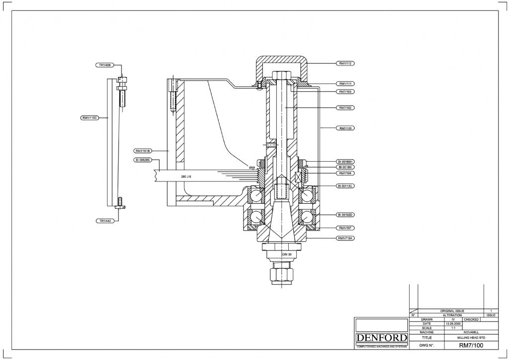

                        I have a Novamill, I know there is poly V drive from motor to spindle – not sure about pulley sizes though.
                        From a drawing I have, there isn't much chance to reduce pulley size on spindle, but maybe increase pulley size on existing motor and use a longer belt? (If only using small cutters).
                        Judging from size of bearings on spindle (7208) I'd be surprised if you can get the speed up to the sort of figures mentioned above. Information on bearing manufacturer's web sites should help identify max speed with grease and with oil lube.

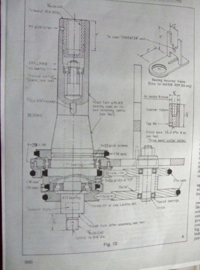

                              I believe the Novamill has an R8, BT30 or 35 spindle, if so there was an article in ME 21 April 1989 showing details to build a speed multiplier, with that you would get 5k to 20k from your 5k spindle.
                              I planned to build one using an ER 11 collet chuck on a 12mm spindle to keep rotating mass as low as possible. You may loose a little height to table but no more than if you use the Coventry quick tool changer chuck.
                              Picture of drawing attached, if it breaches copyright perhaps Neil will remove it.
                              Emgee

                                Yes it's a BT30 spindle. One problem with this sort of gadget is that the machine has little enough headroom as it is. That's why I don't use the Coventry system very much and I'm also trying to work out how to make a very short collet chuck as it's hard to find an er16 chuck with less than ~50 mm projection. I have wondered if one could put a motor on top of the head with a shaft through a BT30 arbor.

                                      Drawing RM7_100 from this zipped collection available from Denford shows the arrangement of the spindle for the Novamill.
                                      **LINK**
                                      Apologies – I can't make head nor tail of how to get a meaningful title to appear as the link after submission.

                                        David, I've got those drawings, you wouldn't offhand know which one it is would you please?
                                        #280561
                                          Thanks to a bit of juggling on my iPad … here is RM7_100 from David's link, as a jpeg angel
                                          Edit: We could roughly scale it from the bearing dimensions, but it would be useful to know the actual diameter of the drawbar.
                                          Edited By Michael Gilligan on 27/01/2017 13:07:57

                                            RM6_100 is also pretty interesting. Shows the spindle in section including pullstud mechanism, which is presumably a build option.

                                                The drawbar is a long M12 bolt so one has limited room to manoeuvre. Max shaft diameter is probably 8mm to leave room for the threads.

                                                  MichaelG – Drawbar is nominal 12mm dia – see drawing RM6/102 for the drawbar from the ATC version. ATC and Manual change version use the same spindle. No doubt the spindle bore is a touch larger than 12mm.
