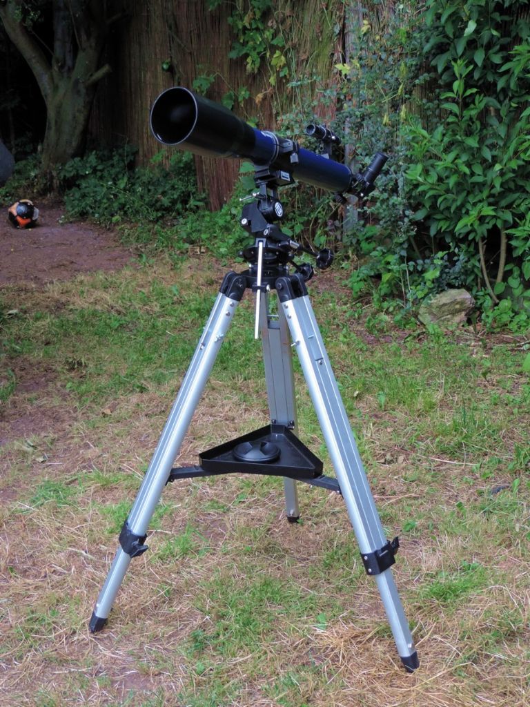

          Hello Paul,
          Sounds like an interesting project.
          You might be interested in this – it's a Bresser 'EQ1' type mount fitted to an EQ3 tripod. I drilled out the holes and made acetal spacers. I also had to swap the latitude clamp for a plain clamp and sand away some of the tops of the plastic pivots.
          With screwed bracing rods fitted to the top of the legs it's a good setup for visual use.
          We have an 'other hobbies' topic where you can mention astronomy in relative safety
