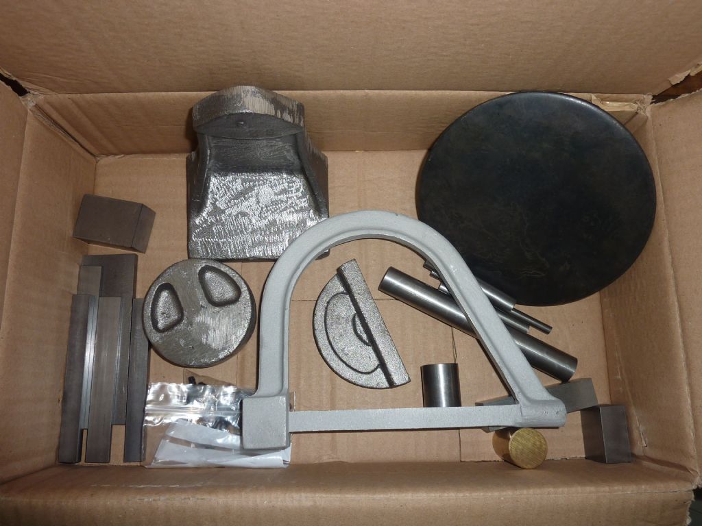

      I thought I would post a few pics and some info on the Filing Machine from Hemingway Kits.
      This is what you get plus some build notes and good drawings.

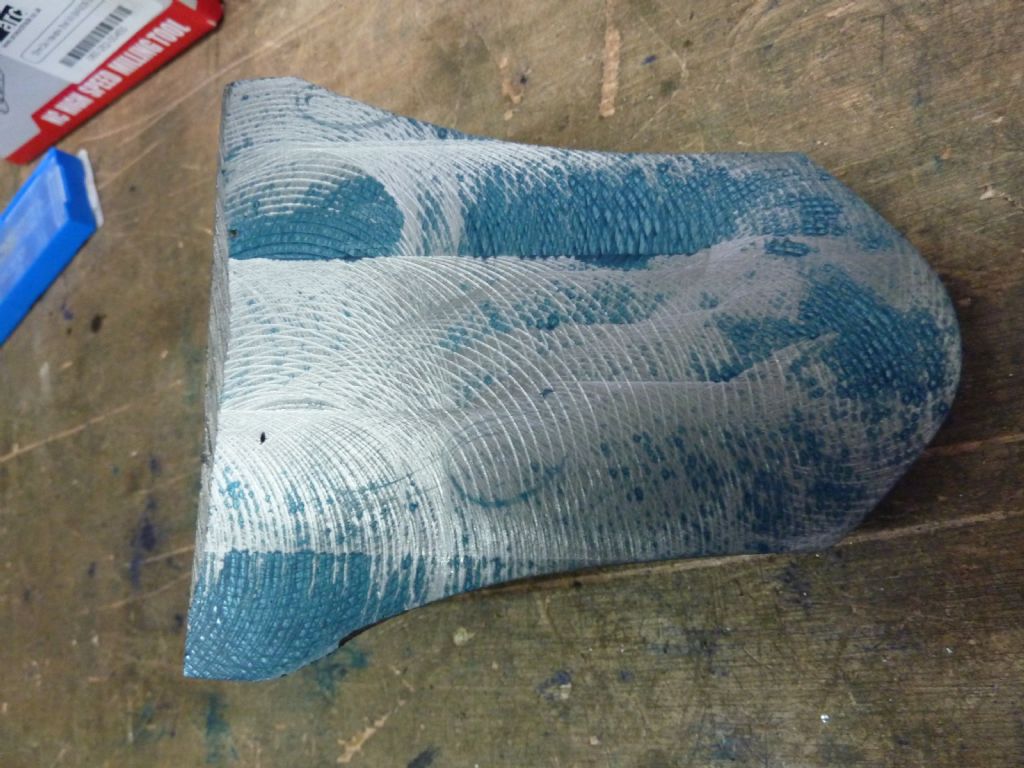

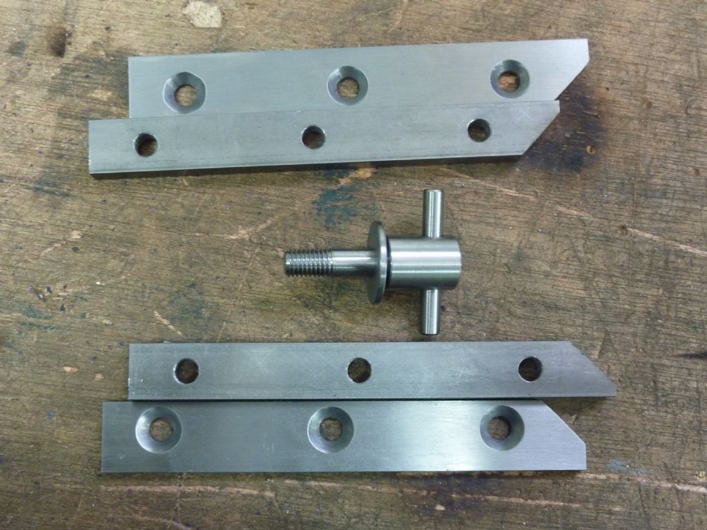

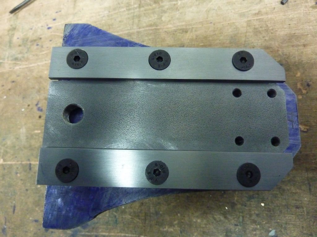

            So I got some work done on the machine this weekend.

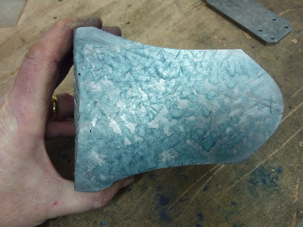

            The piece below is the bit that goes up and down sliding on the main casting. It is supported and guided by the bits above. I rubbed it on the surface plate and as you can see there is very little contact.
            After about half an hour with a carbide paint scraper blade that has been soldered to a length of steel rod it looked like this, which is looking much better.
            This is the main casting that was cut with a 5 tooth carbide shell mill from Arc
            #513298
            Buffer
              @buffer

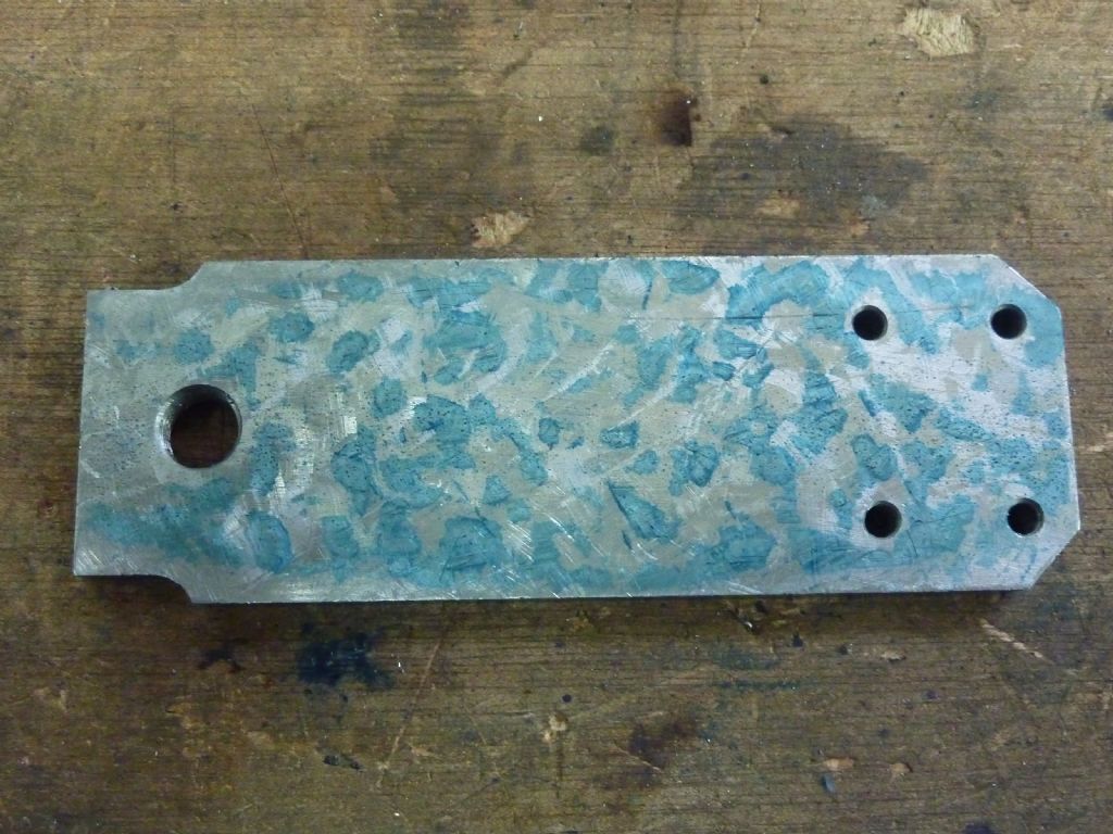

              The 5 tooth shell mill actually gives a very nice finish when you want it too but I knew I was going to scrape this bit so I didn't hang about with it.
              This is the casting after about an hour with the home made scraper

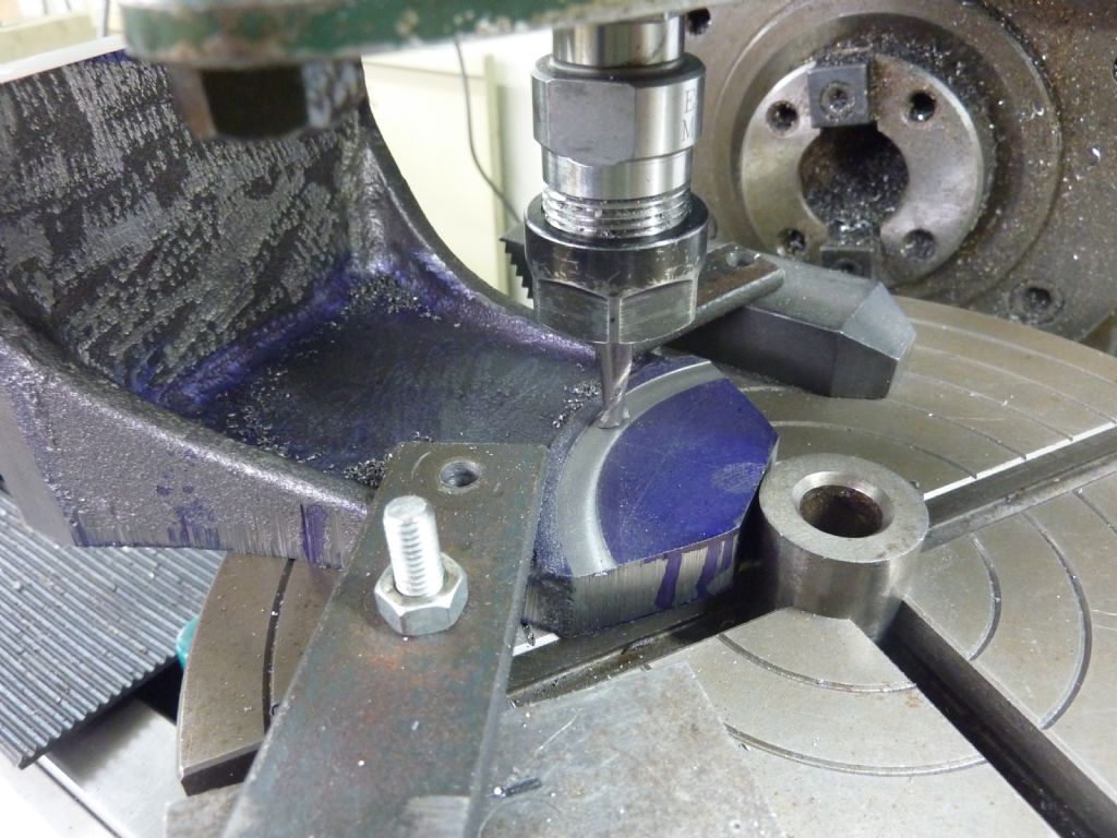

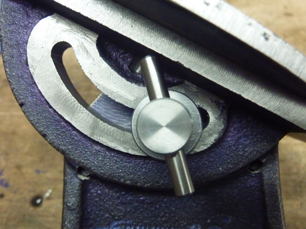

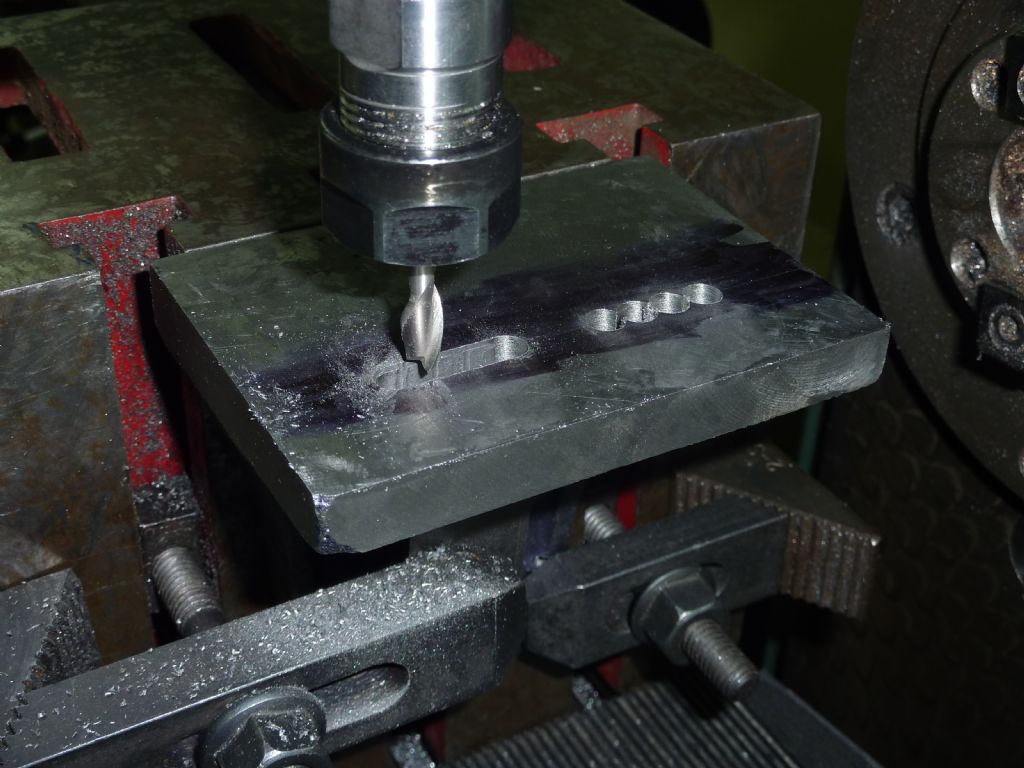

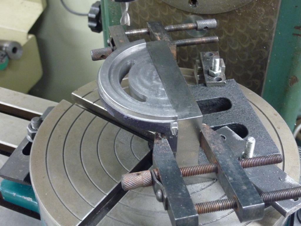

                The main casting needs a curved slot with its centre 1/2 an inch off the casting in the fresh air. So I took a little bit off the top of the casting to get it to the exact length and then pushed it up to a 1 inch cylinder that was in the middle of a rotary table. I centred the table using the Osbourne manoeuvre. This works really well and I only had to do it 3 times and it was bang on as far as I could tell.
                I then flipped it over and fixed it to an angle plate squared it all up and drilled the holes to hold the guide bars. I was really pleased when this came out spot on as I didn't mark out any of the locations just used the dro.
                So that's it for now, back to work tomorrow but hopefully I will get a little bit more progress in the week.

                    I got a bit more done last night. It wasn't the easiest to set up as the centre of the arc is off the casting by 3/16th of an inch. With hindsight it would have been a lot easier to just slip a piece of 316th steel between the casting and the angle plate but I only thought of that this morning. Anyway I got a good piece that fits very nicely to the main casting.

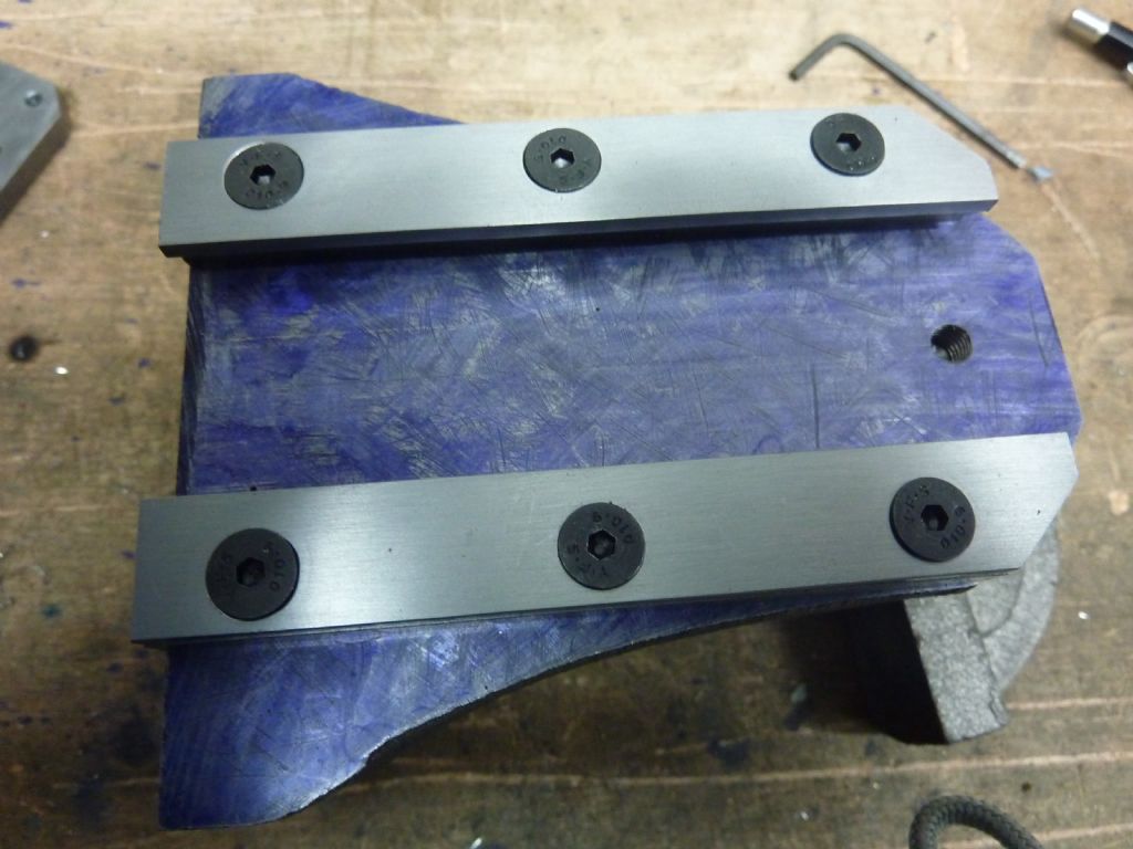

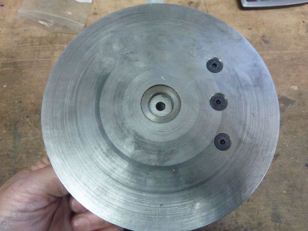

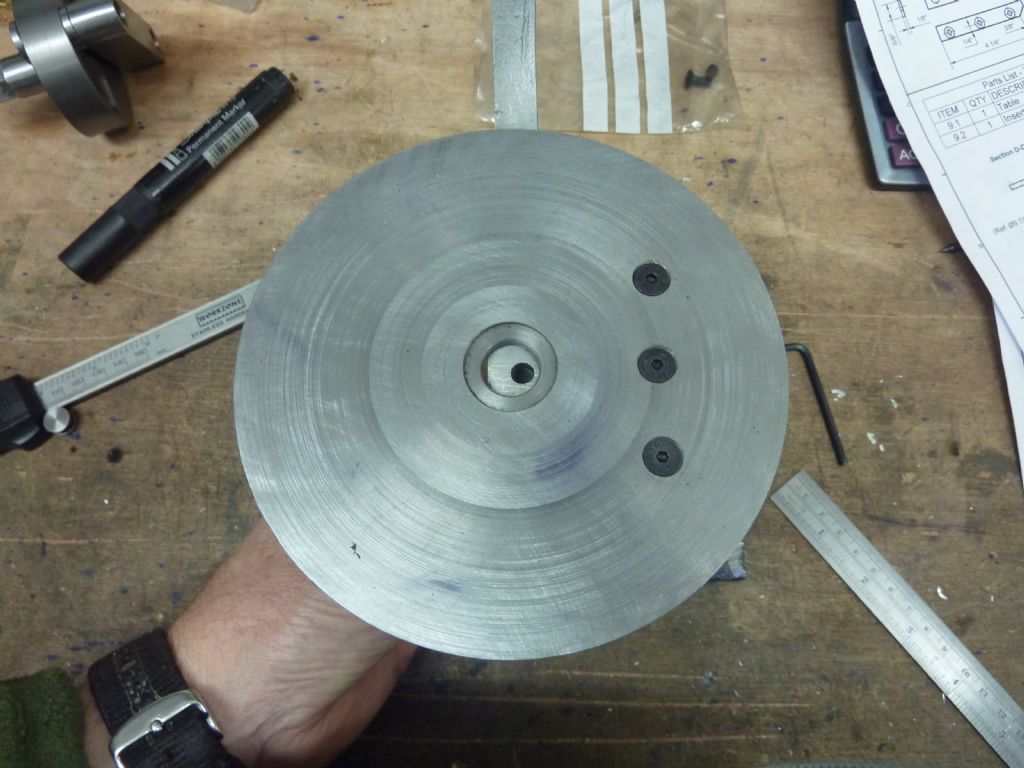

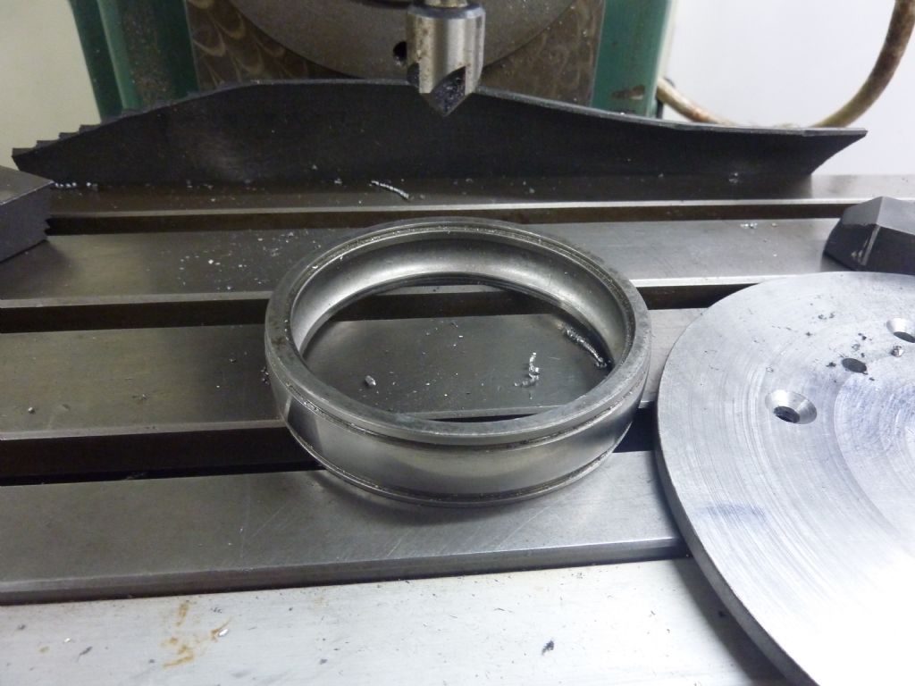

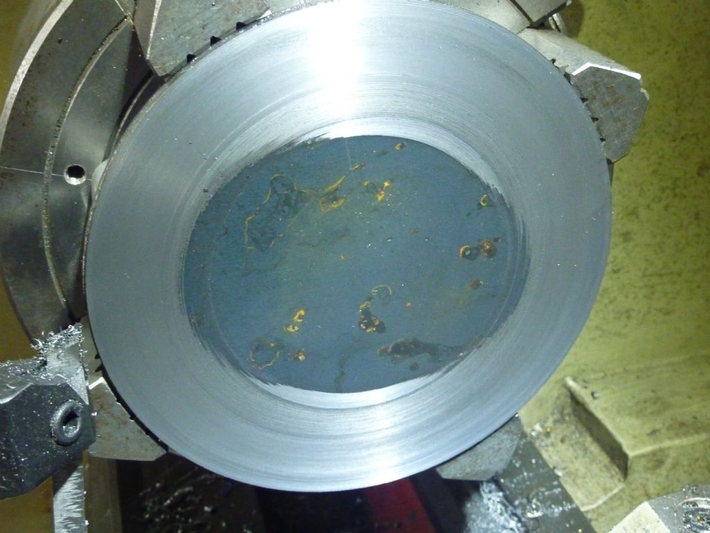

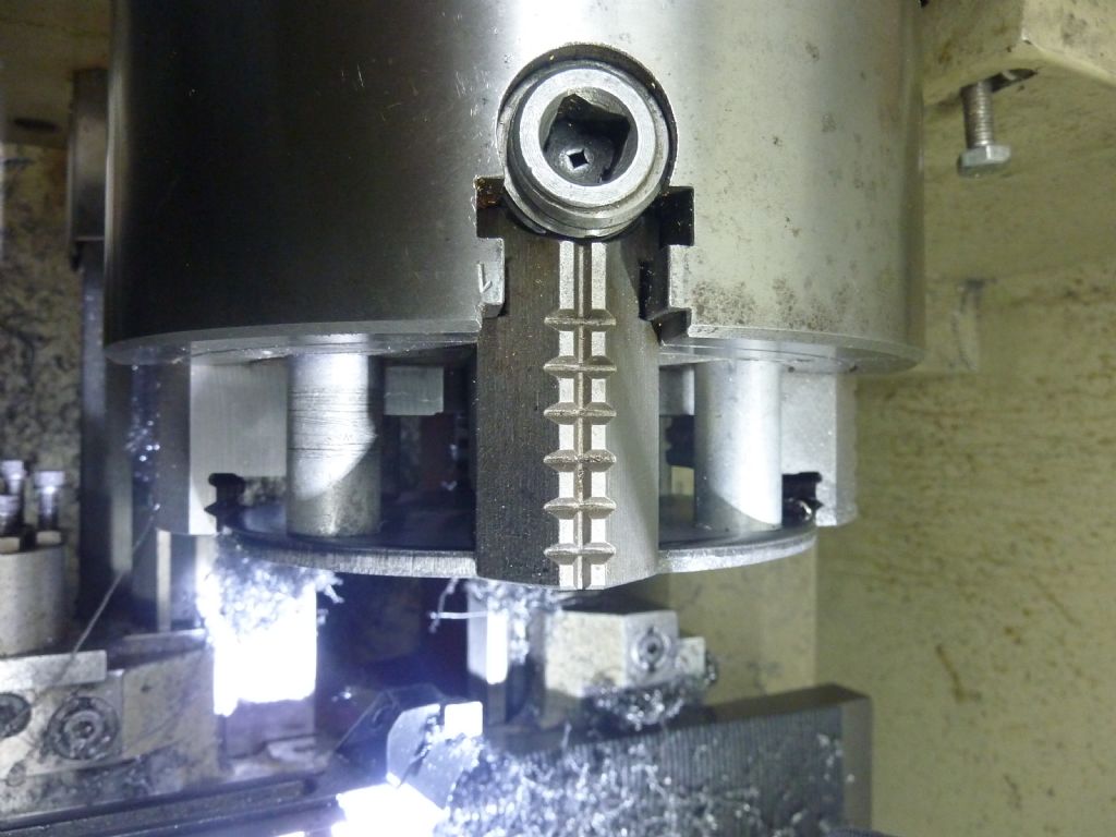

                          Well Wifey went to work today and the kids seemed happy scrapping with each other so I sneaked out to get another bit knocked off.
                          Now the instructions do say that you should give the table a skim over to get it flat. The piece is punched out so it has clearly taken on a bit of a curve. It's not obvious by looking at it so I wouldn't worry if your 4 jaw can't cope but mine can so I gave it a long going over. You can clearly see here that the middle is a bit lower than the edge. It's not a lot though probably less than 1/2 a mm.
                          This is the other side and its pretty obvious but the middle is now being cut before the edge. I only cut enough to get a flat surface for the casting to bolt to it.
                          A while back while I was making the smoke box for a loco I did what some might see as vandalism. I drilled into my best four jaw chuck so I could mount posts on it. I know I could have used soft jaws and I do have a bearing mounted on a tool post but I did it anyway and it has been very useful.
                          I used an old bearing outer as a parallel whilst drilling the mounting holes. I could of used normal parallels just as easily but there is an agricultural engineering business behind where I live and they always chuck big bearing in the skip so why not.

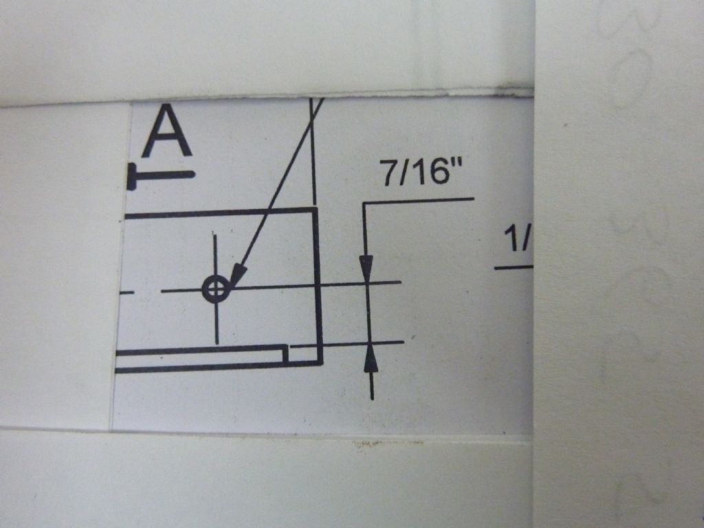

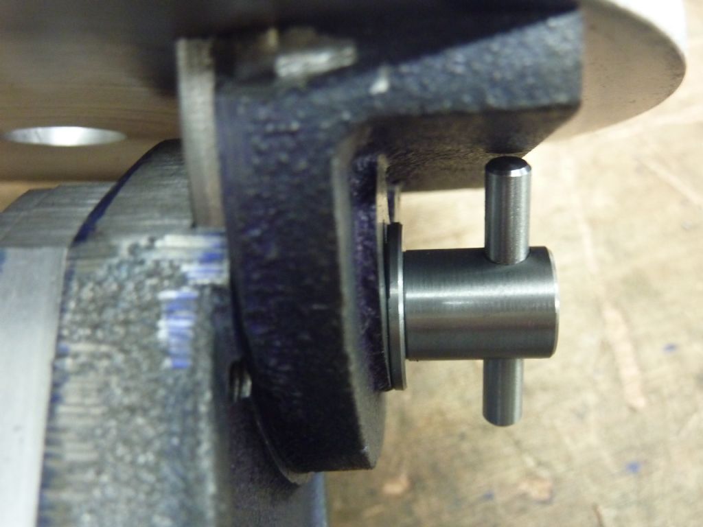

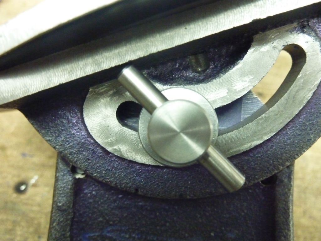

                            Well it seems there might be a little error in the drawings.
                            The screw that clamps the swivel up tight impacts with the the casting. I might be trying to tilt the table more than it is designed to do but made to the drawing it does hit the casting. It's not a problem yet as I think most of my filing will be done at ninety degrees. But if you want to tip the table over a a fair bit then make the thumb screw longer or make the tommy bar loose like you would find on a vice.

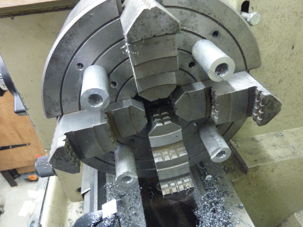

                              Shaft hole next. Stop. Think. Examine drawing.. Opened up hole in stages; all tools directly in the R8 collets due to the lost head-room. Added further clamps as the drilling showed the tower of metal was not very rigid.
                              Next, the boring-head; a nice bit of kit, unknown make but labelled "Made in France for Gamet", and metric feed. I bored through all three for the bush with the smallest (by only a few thou) diameter mounting-shoulder; reducing the other two bushes later on a temporary mandrel.
                              Phew! Finally, I transferred the chuck / jig / plates assembly to the lathe to clean the edges.

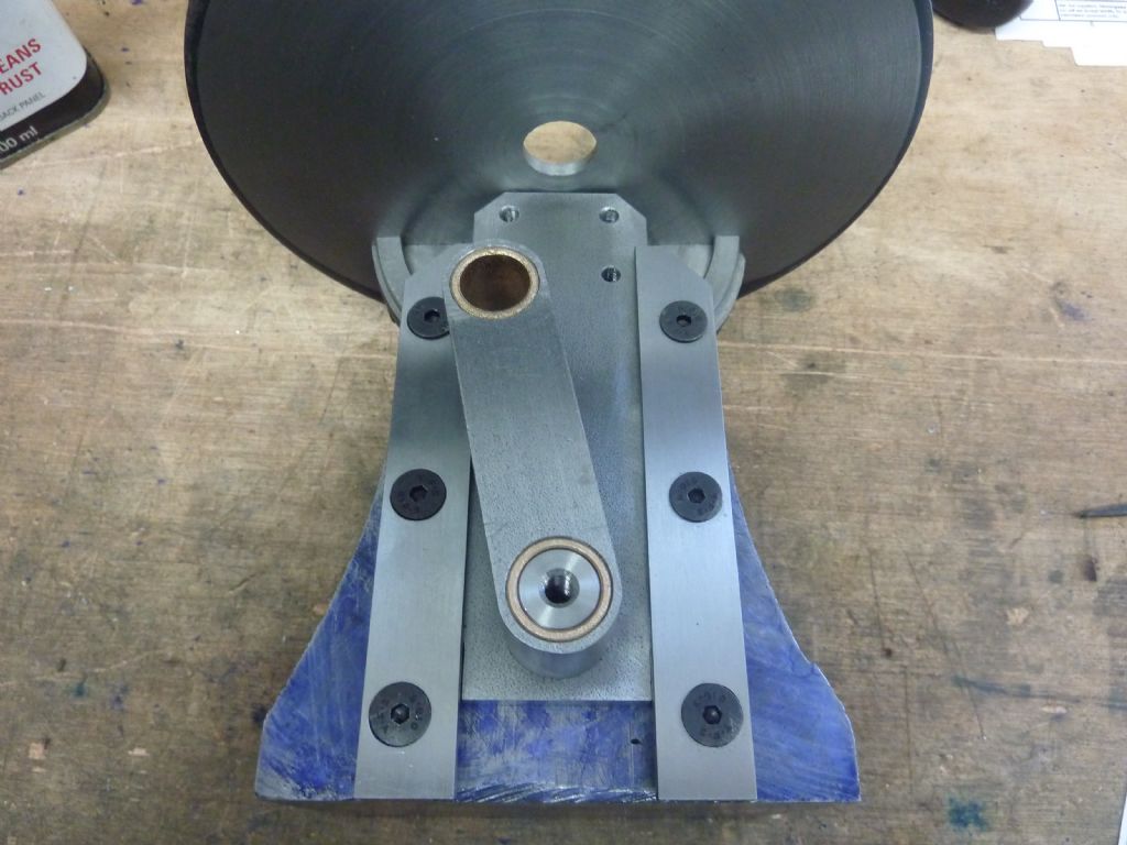

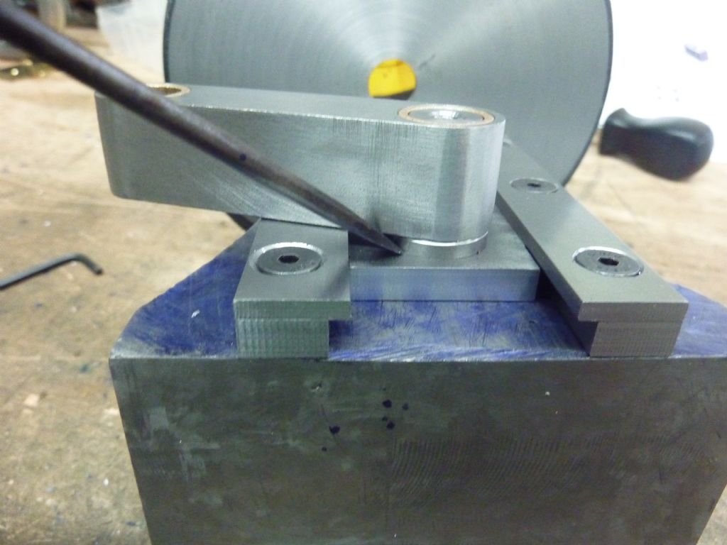

                                  Its been a while since I posted on here. I wasn't able to get anything done until recently as I had the dreaded Covid over Christmas. I felt so unwell and I have only recently felt well enough to get back into the workshop.
                                  So I got the connecting rod finished. It wasn't difficult I just drilled and reamed the holes to size and then pushed the bearings in using the vice. I roughly shaped the ends in the milling vice using a pin through the hole and then finished by filing.
                                  Here it is fitted to the rest of the machine. It's very important that the six screws are countersunk below the level of the surface, there is virtually no clearance of this crank over them.
                                  The flange on this pin has to be made accurately or even better slightly thicker. If you get this wrong you'll have to make it again or fit a washer. Funny thing is it's not given on the drawings you have to do the maths to get the size which to me seems a bit odd for such an important dimension.

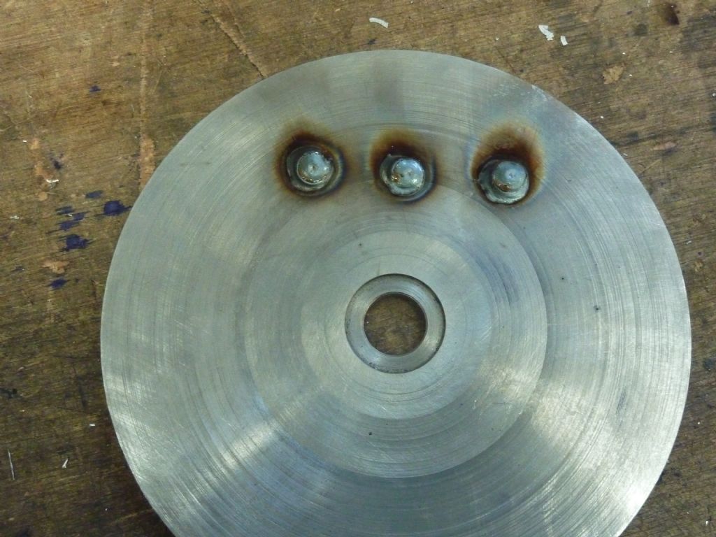

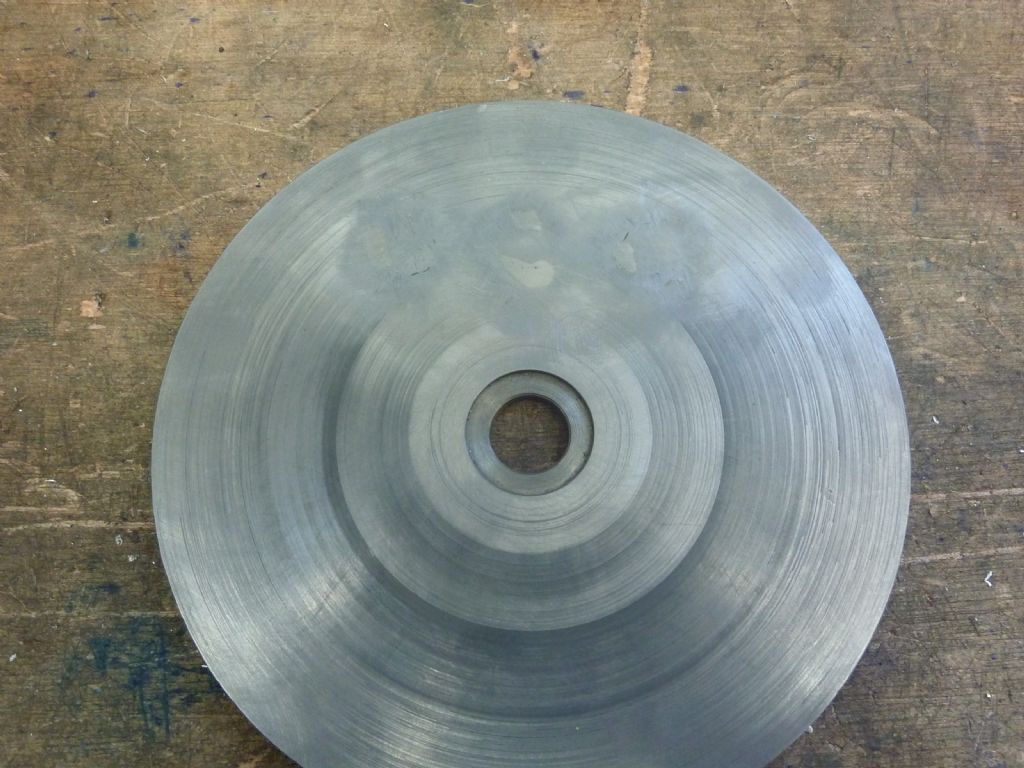

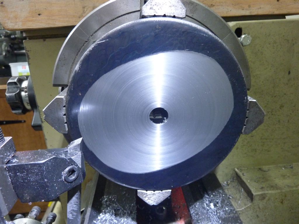

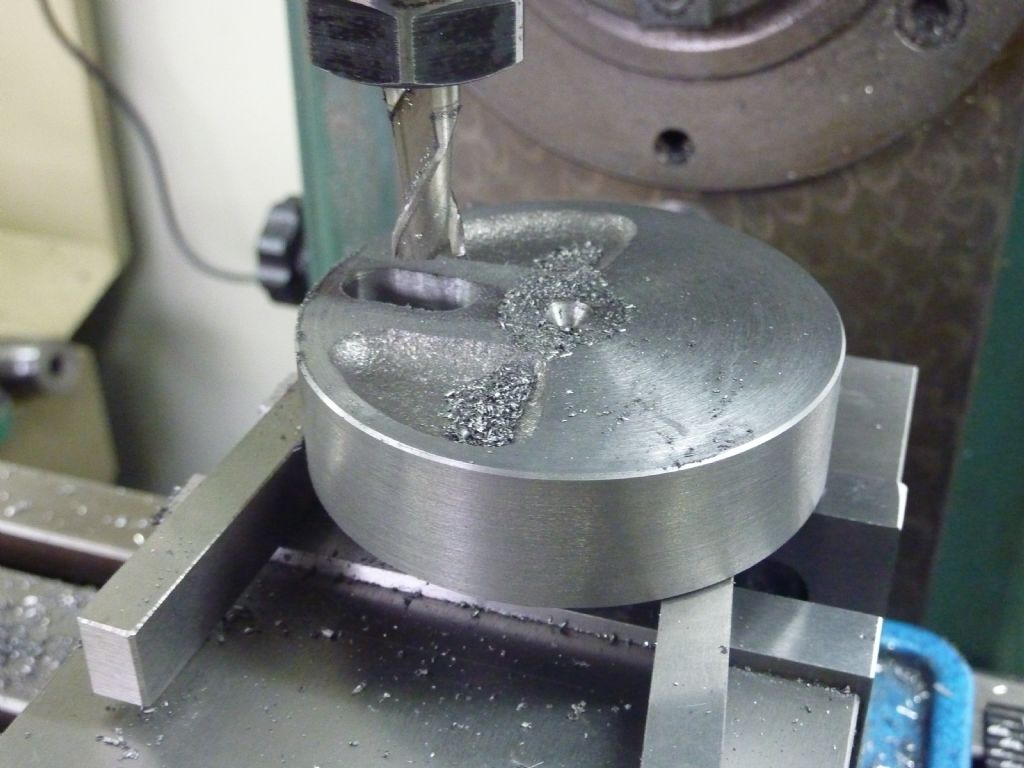

                                    It was Wife's turn to teach the kids so I sloped off for a few hours. I got the flywheel made by fitting it onto the centre shaft then used that in the lathe to turn the flywheel to size. It needs a square ended slot through it for the drive pin. I drilled out most of the slot then just finished it off with a slot drill. It went nicely as it's a cast iron flywheel.

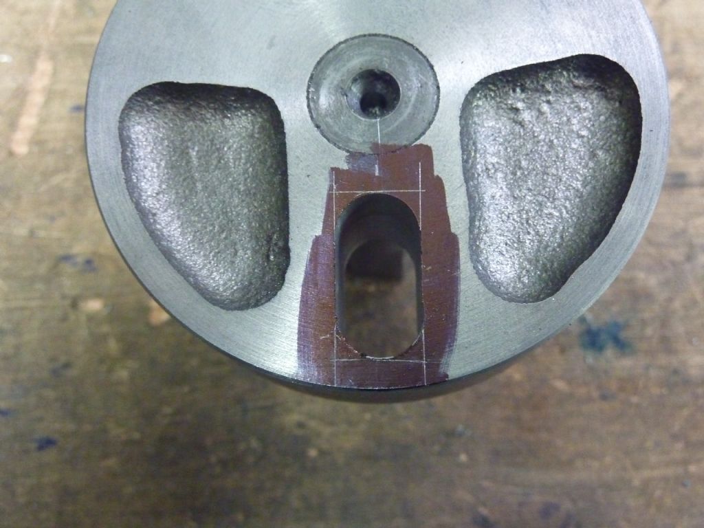

                                    This is exactly the sort of reason why I want a filing machine. The slot is supposed to have square ends and I hate doing this sort of job.

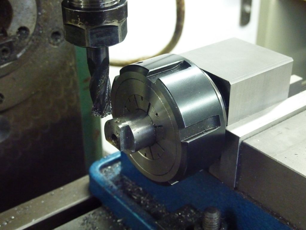

                                    I used a Stevenson's Block to cut a square on the end of the drive pin. it was dead easy with this great little tool.
                                    I then milled six flats on the end of the drive rod again dead easy with a Stevenson's Block from Arc. However this turned out to be a less accurate item than I had hoped. The flats weren't all the same size which was annoying. It wasn't a lot but it was enough to be visible.

                                      A ‘lever bolt’ (just ‘goggle’ it for lots of examples) might be a better alternative for that clamping screw for holding the swivel. Not bench made but reasonably cheap and effective. Mostly metric, mind. I change the bolt with a stud (with metric thread on one end and thread required on t’other).

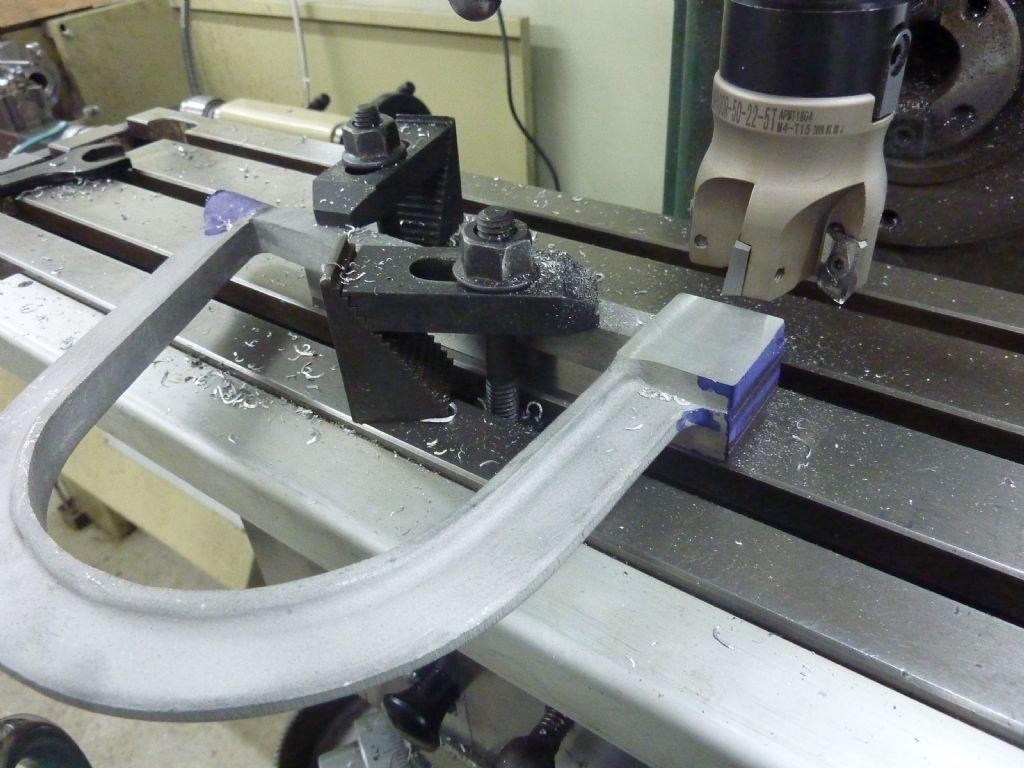

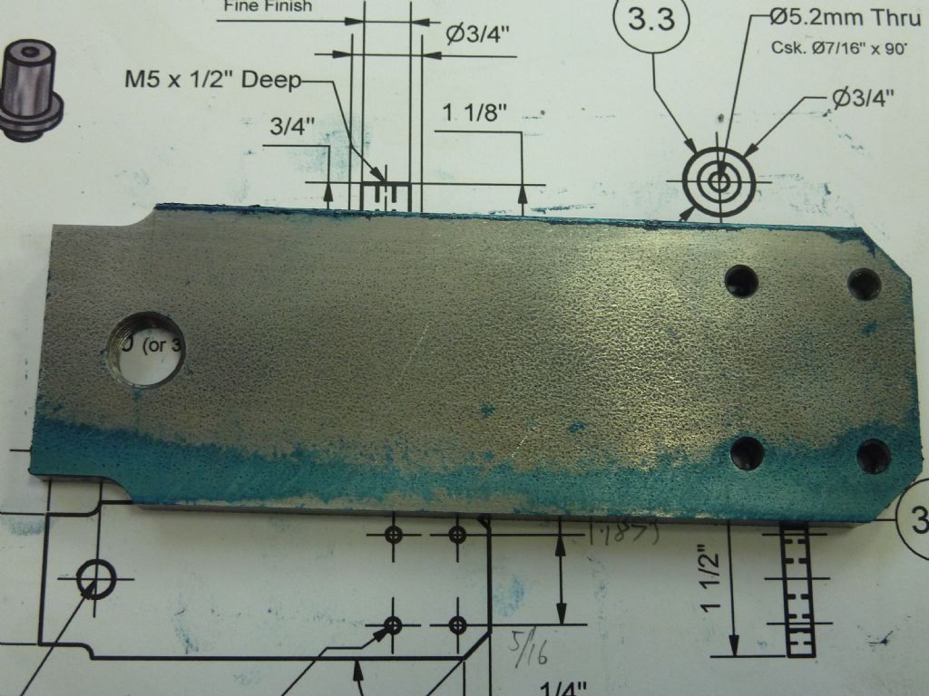

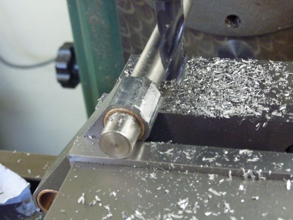

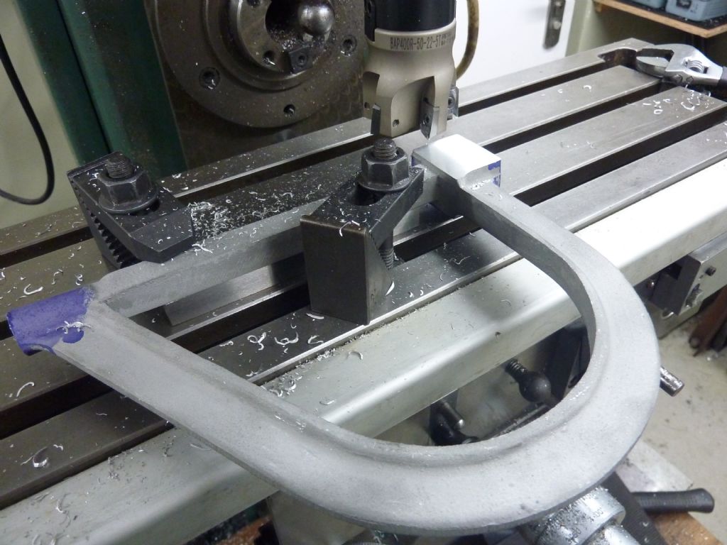

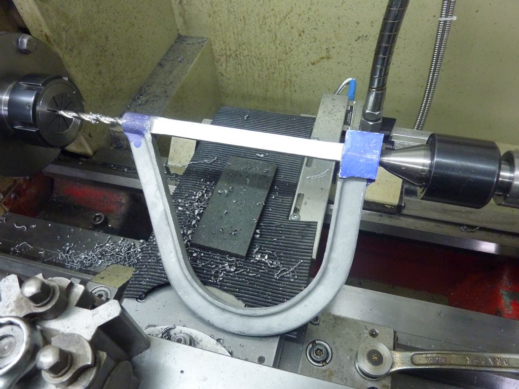

                                        I managed to do what I thought was going to be the hardest part of this build which for me was the aluminium bow shaped casting.
                                        I set it up as flat and level as I could and then machined a reference surface along the long centre portion. I could then flip it over onto a parallel to get the important end done.
                                        One job I wasn't looking forward to was drilling a hole through both ends because they need to line up. I followed the instructions that tell you to centre pop each end then drill it on the lathe like this.
                                        p1040942.jpgYou then just flip it around to do the other end. It worked reasonably well but it is a little bit out. I don't think it would matter though for sawing and filing.
                                        I finally got the bow fitted to the machine and couldn't believe there was a mistake. My hole I had drilled was 1/8th of an inch off centre but I knew the problem wasn't with the bow.
                                        The problem was I didn't drill the holes in the table mounting bracket in the correct place. I didn't read the drawing correctly the 7/16th is not from the edge of the part. D'oh! Lucky I've got a MIG welder.
                                        #523150
                                        Buffer
                                          @buffer
                                          I got the holes MIG welded up and then I milled the mess flat to the table. I think it looks worse in the photo than it actually is. So with the holes re drilled it all goes together nicely. It wont be long now before I can give it a go.
