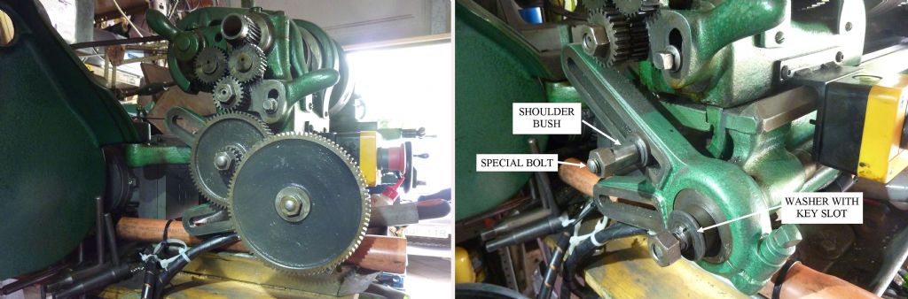

                                      Paul Lousick
                                        @paullousick59116
                                        Hi Jp,
                                        The idler gear is a special gear with 2 sets of teeth on the one gear. 72 teeth and 18 teeth.
                                        You also need a spacer washer with a keyway to go onto the lead screw shaft and fit over the key.
                                        Paul.

                                            #179468
                                            Versaboss
                                              @versaboss
                                              Sorry to appear a bit pedantic here, but the double gear on Paul L.'s picture (left) is not an idler gear!
                                              An idler gear does nothing to the ratio between two shafts, it is just idling. But this gear pair does reduce the speed from the spindle to the leadscrew. I was wondering about that when I first saw the pile of change gears in one of the first pictures. What I suppose (I admit I know nothing about South Bend lathes) is that there is something missing on that empty stud. The 'something' should enable to mount two gears in such a manner that they can rotate freely on that stud, but be coupled together firmly. That's how it is done on my Leinen lathe, with the aid of a key in that case.
                                              Regards, HansR.

                                              Paul Lousick
                                                @paullousick59116
                                                Hi JP,
                                                The gear is not a single idler gear. It is a reduction gear and was available in different ratios. Search under Southbend and also Hercus lathes. If you cannot find one in the UK, they are available in Australia.
                                                I just did a search and found a 72/18 tooth compound gear for $69. (approx ₤40) at Australian Metalworking Hobbyist. Other ratios are also available. (Probably cost that much in postage.)
                                                http://australianmetalworkinghobbyist.com/store/index.php?route=common/home
                                                The spacer washer on my lathe is about 1/8" thick. You could easily make your own if it is required.
                                                Paul.

                                                #179485
                                                JP Santos
                                                  @jpsantos46123
                                                  that's it!! Compund gear!!!
                                                  I've found a couple on ebay UK!! the original one is 72/18 and the ones I found are not the same but doesnt matter.
                                                  I just want it to connect to the lead screw so I can have the power longitudinal feed…..
                                                  I can then adjust the longitudinal feed speed by changing the load of gears I already have… I think that will work?
                                                  http://www.ebay.co.uk/itm/BOXFORD-LATHE-COMPOUND-GEAR-18-54-TEETH-LATHES-MILLING-DRILL-ENGINEERING-TOOLS-/191507744210?pt=LH_DefaultDomain_3&hash=item2c96c045d2
                                                  http://www.ebay.co.uk/itm/54-18-Tooth-Compound-Change-Gear-For-Boxford-Lathe-With-Bush-Bolt-Assembly-/121562745282?pt=UK_Home_Garden_PowerTools_SM&hash=item1c4db449c2
