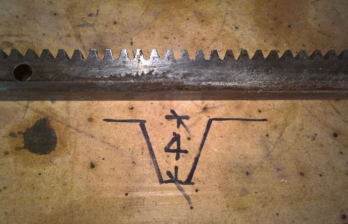

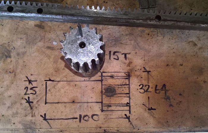

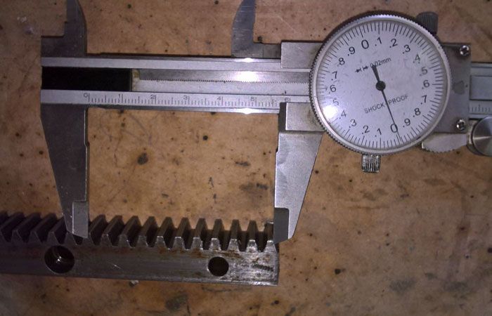

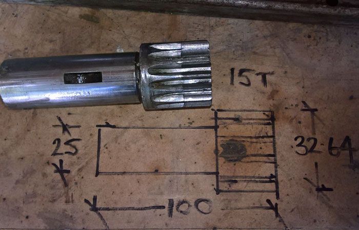

                          forum6.jpgforum4.jpgforum3.jpgforum2.jpgHere are some images and sizes, as you can see I have a mill but no indexing head atm.forum1.jpg

                          Brian Wood
                            @brianwood45127
                            Hello Philip,
                            Working from the picture of the rack, I made that to be 14 DP
                            Regards

                            #411727
                            Anonymous
                              The results for the rack definitely seem to indicate 14DP. If we assume the total tooth depth is 2.157 divided by the DP that gives 0.1541" which is 3.91mm, close to 4mm. it's difficult to tell what the caliper reading is on the rack, and the left hand jaw isn't lined up properly. If we assume 14DP that gives a circular pitch of 0.2244", times 10 gives 2.244" or 57.0mm. That's close to the value from the picture but not exact. I suspect the misplaced left jaw will account for most of the error.
                              Having said that the measured OD for a 14DP 15 tooth pinion simply isn't "correct". It could be a measurement issue, or the pinion is slightly non-standard. With an odd number of teeth it's not easy to measure across the gear teeth. Presumably the quoted OD was measured over the uncut part?
                              The good news is that it would be simple to cut the pinion using an involute cutter. A 14DP with a PA of 14.5° is readily available from RDG, although in my experience their cutters can have the wobbles.
                              The pinion doesn't seem to be that worn, not sure I'd bother replacing it at this stage, if it works.

                                Pete Rimmer
                                  @peterimmer30576
                                  The numbers don't stack up because of the low tooth count of the pinion. It's normal to increase the diameter of low count gears to prevent undercut and make the tooth stronger. According to Machinery's handbook (30th edition, page 2162, table 8) a 14DP 15 tooth pinion should be increased by 0.07569" (or 76 thou). If you subtract that 76 thou from the measured diameter of the pinion in question the numbers work out very close indeed for 14DP (14.06 actually).

                                  Philip Sewell
                                    @philipsewell33761
                                    Apologies Andrew the caliper reads 57mm, it is lined up as best as I could but being a tapered edge there's a bit of guess work but it's close (it's the camera angle making it look off position).
                                    The same with the diameter on the gear, it's a bit chewed up so again the measurement might be slightly out, yes I measured the uncut part.
                                    The pinion did work but the teeth are almost at a point. As I have the saddle off the machine I thought it would be a good idea to replace it if I can. Both the cross slide and compound lead screws are very worn. I have replaced the worn screw on the cross slide as it was a standard size, the compound apparently isn't. I was quoted £150 + vat for a one off so will have a go at making one when the lathe is back together.

                                              #411838
                                              DC31k
                                                @dc31k
                                                To the OP. It looks like only the inboard side of the pinion is worn. Use the existing teeth as a pattern, File out the incomplete teeth on the outboard end, cut it off, rotate 180 degrees and glue it back on.
                                                Given that your lathe was made to imperial dimensions, it might be wise to invest in a set of dial calipers of the same language.
