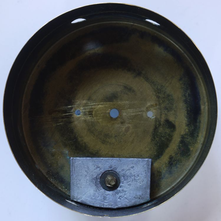

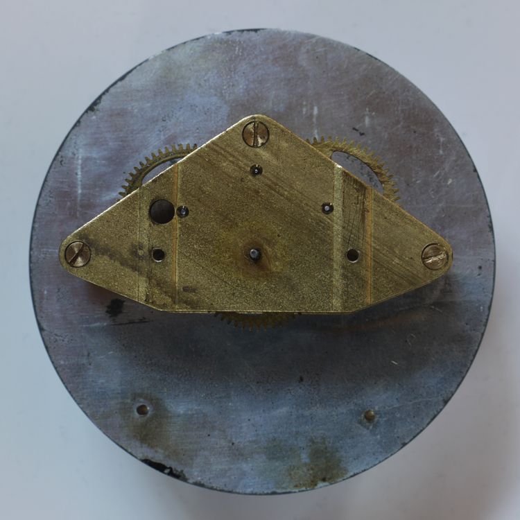

              #335723
                Fiona,
                With apologies for the delay
                [ a streaming cold is not conducive to photography of clocks ]
                You may have already got there, but; for the record here are photos showing the two screws that hold the movement and front plate; plus one 'nut & bolt' that holds the weight.

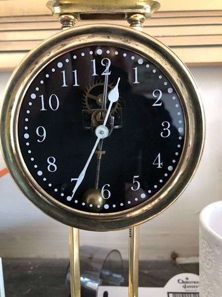

                            #337797
                            Ian Parkin
                              @ianparkin39383
                              3f12495d-b1b7-4a5a-af8d-a89ca5b2cfc3.jpegMy newest clock finished now with new face
