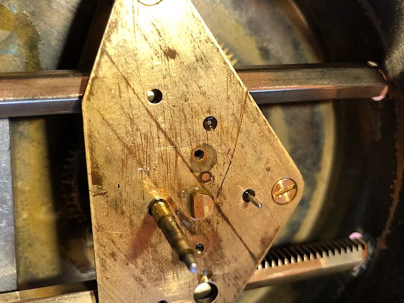

        This is the back plate before the escapement goes on

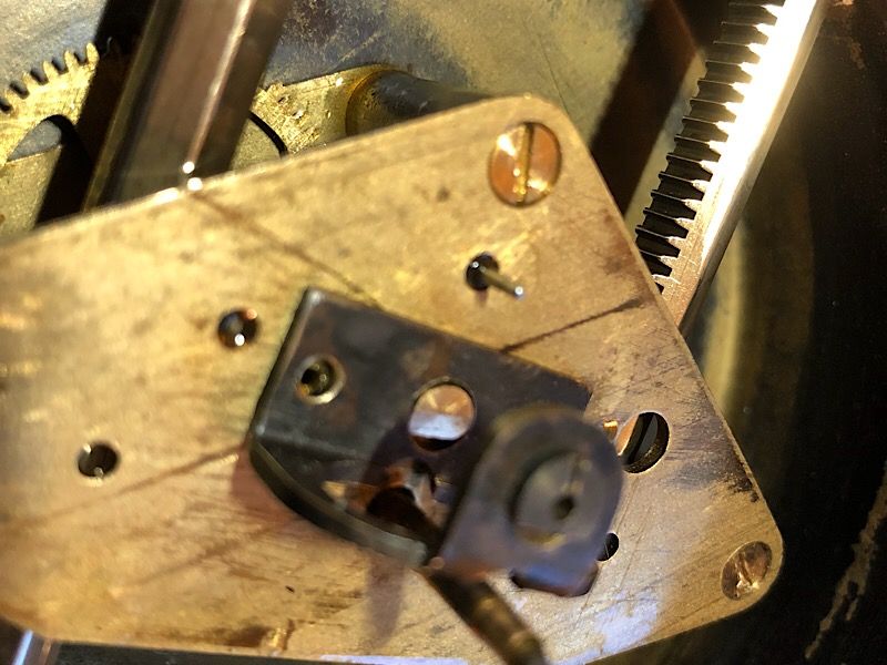

        There’s a little stub chamfered with a chord cut off that the pivot bracket goes on like this
        This is fastened on with a couple of screws

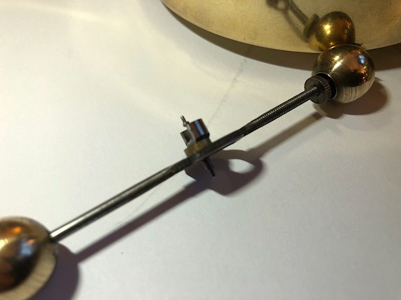

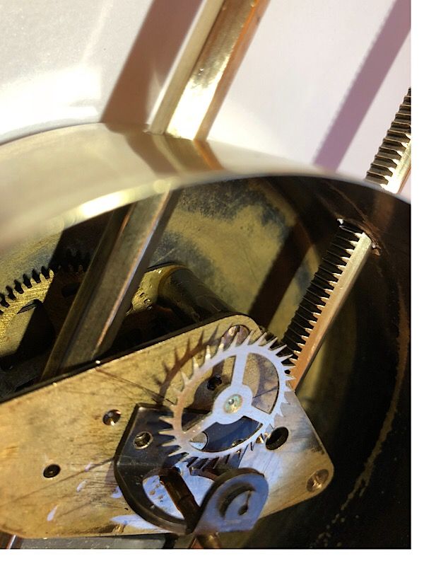

          Then the pendulum fits on and the escapement wheel like this a2889acf-c47e-4c1a-b3cd-4d940a075264.jpeg
          The pendulum ? It has brass balls at each end the top end is fixed the bottom is threaded where as a start does it go if i suspend it on its pivots how much biased towards the bottom should it be ?
          The part in the middle of the pendulum (pallets?)
          Is the idea that this is absolutely at 90 degrees to the shaft…it didn’t look it when i started i can grasp it with pliers and move it so it is at an angle. When the pendulum is installed it wont self start if i help it it runs for 10 seconds slowing al the time until it stops..the screws that hold the pivot allow a slight engagement adjustment in or out of mesh..very slight.
          Is the idea that the escapement wheel kicks the pendulum every stroke?
          Can anyone offer any advice on setting this up to a beginner in clocks?

            Ian,
            Looking at all those file-marks on the plate; I would suspect that this one has suffered some tinkering.
            I suggest you check all the pivot holes for alignment, and that the arbors all move freely.

              I dont think they are file marks..its a very cheaply made clock i would imagine and i would say its had little tinkering with it in the last 100 years.
              If i remove the escapement wheel the clock travels nicely down the column in about 30 seconds

                    When the pendulum is swinging under the designed load, does it beat properly – ie is the time between each tic and toc exactly the same?
                    The half-round piece on the pendulum is the critical bit, along with the escape wheel itself. If the ticking is irregular but the same each time the scape wheel turns, then one or more teeth may be out of position. If the tic and the toc are different lengths, ie tic … toc tic … toc, then the pendulum is not set correctly in relation to the half-circle. From the photo it seems nearly right but that may not be enough. It may be that one arm of the pendulum is slightly bent.
                    There is oil on the various bits, especially the scape teeth, isn't there?

                                  Still not got anywhere with it
                                  I’m sure the gear train is ok it travels down the rack now in about 10 seconds
                                  If i instal the escapement wheel it takes the lightest touch to stop it
                                  If i then install the pendulum it only runs for perhaps 5-10 seconds I’ve tried adjusting the angle of the pallets and the bottom ball at all levels

                                    I would ( if possible ) adjust the top ball rather than the bottom one. It's a compound pendulum and shouldn't need a lot of adjustment.
                                    I think I would start with the balls about the same distance apart and concentrate on the angle and depth of the pallets. Once you get it going, then is the time to start altering the pendulum length

                                      I’ve printed off the patent description and set the pallets as described but the escapement wheel just doesn’t seem to be giving an impulse to the pendulum.If i press down hard on the top it seems to work better but still not like the one in the video link and how i remember my old clock working
                                      If i remove the escapement wheel it descends nicely and smoothly…. with it back on and the pendulum removed a strip of paper 70 gsm 6mm wide held 40mm away will stop the wheel…there’s so little power …surely it should bend that slip of paper
                                      What oil should i use to lube everything ?..though the patent mentions lubrication isn’t important
