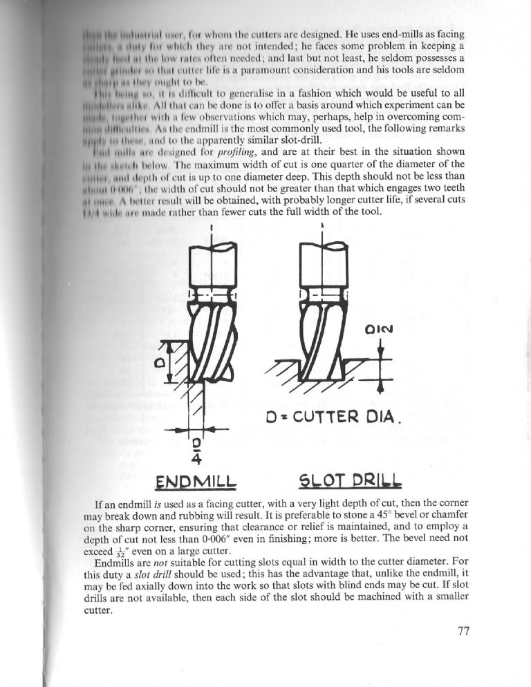

          Some info for you, FWIW, sorry not very clear but readable; It will give you the general set up for depths / widths of cut etc. Aluminium can differ in content, some are 'soft' others 'hard' so surface speed differs & is adjusted accordingly but if you are above 800+ rpm you'll be in the ball park. Air mist blast coolant / WD40 are the better methods of cooling especially if you have 'soft' aluminium material, helps stop it 'sticking' to the teeth tips.
          George.
