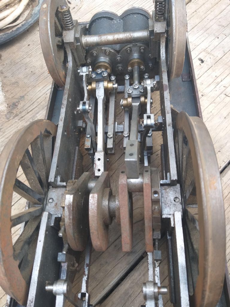

      Hello everyone,
      apart from my introductory post a few days ago this is my first post here and asking about my 2-2-2 chassis is actually one of the prime reasons for joining.
      The reason behind my questions
      I wish to get it operational as a rolling chassis so I need to make some missing parts. I assume it a UK design and that I could find some drawings for it and possibly some advice on the best method to make the missing parts.
      Reasons for not making a boiler is I just wish to have it 'run'':-
      1. on low pressure compressed air to use in STEM classes for Primary Schools I visit. I will write more on this another time.
      2. personally at home to use on compressed air at a pressure comparable to what would have been its operating steam pressure.
      Background
      So I have a 2-2-2. Missing the Conrod Big end + connections to the cranks and the main axle spring blocks.
      I got it from a Scrap Metal Yard where it was there along with a lot of other engines (some complete).
      Yard owner said a young girl drove a car in with trailer, said ''this junk was from her Granddads house", and she wanted money for it.
      I asked what they paid pretending to be curious more than interested. Indian/Pakistan guy worker said scrap metal value, of course, nothing more !" Grudgingly she accepted it.
      I got this engine, less the boiler as copper scrap was paying serious money so they wanted to keep it. I offered double scrap value, but guy said I was lucky to get the metal chassis as their rule was NOTHING leaves yard except in the BIG Bins.

      I have a limited number of old back issues of Model Engineer from the 1940's but when I looked at them 6 years ago I did not see any hint of this engine or one similar.
      I will try and post some images that I have stored on the site IMGUR dot come
      https://imgur.com/a/yL35SoO
      Hopefully they show ok here?
      (EDITED here and removed the 4 image links as I found out about the Album function. and I have posted one image per post following)
      I trust someone here can assist me.
      Stay safe and keep well in these trying Covid-19 times
      respectfully
      David Broadbent
      Melbourne
      Australia

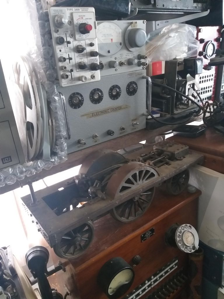

        Saved it from a Scrap Metal Yard in Melbourne Australia

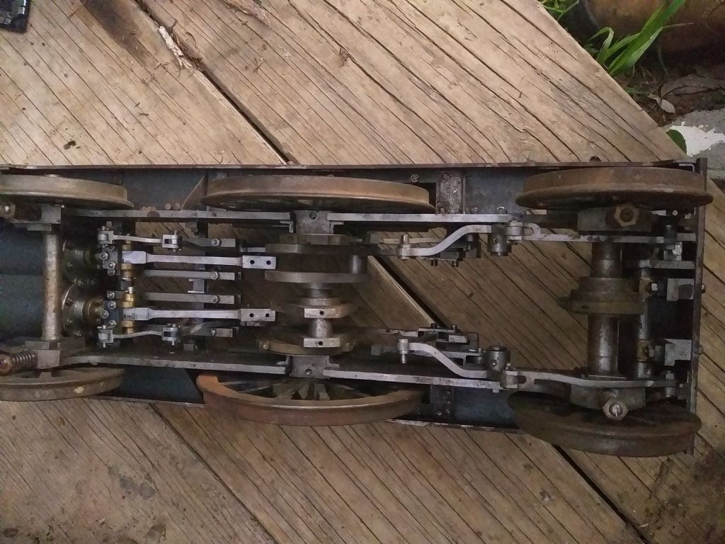

                    I think it might assist your search if you let us know the gauge of the chassis.
                    Then, for instance, pages such as or similar in intent to:
                    http://www.n25ga.org/Designs/Designs%20Index.htm
                    could be greatly insightful.
                    You could try '2-2-2 model locomotive' in Google and look at images.
                    Otherwise, try and find a list of model locomotive designers (LBSC, Martin Errors, etc.) and if any of them did a 2-2-2 design.

                      The only engine I could think of was Jenny Lind in 3 1/2" by LBSC. Even if it's not that the drawings and castings from Reeves (no connection) may be of use.

                        Hi David, as DC31k has said, knowing the gauge would help. LBSC's Grosvenor is a possible candidate, which is a 3 1/2" gauge, but I don't know where you may find any plans.

                          Hi Brian H, I looked at Jenny Lind, but dismissed it because her frames for the leading and trailing wheels are on the outside. But as you say, the castings etc. for that could have been used.

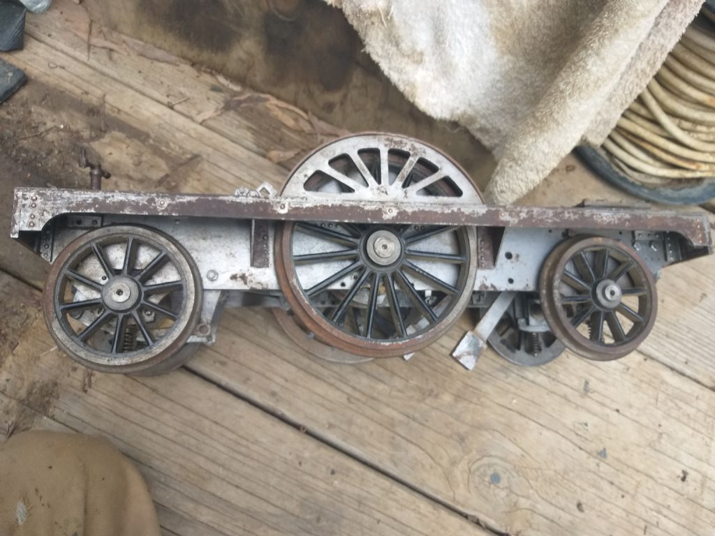

                            Thank you all for answering so far.
                            I apologize for missing the dimensions as I was focused on trying to add photos in the same way as I do on the Vintage Computer Forum but found you have to add them to an album here first. Plus with flaky Mobile Internet due to the heavy rain all day I was trying to get the text worded clearly.
                            10.47pm and I just jumped out of bed threw on 4 layers inc wet weather gear over PJ'S, dashed to my workshop, measured and now back in the warm house.
                            Its a 5" Gauge engine.
                            all the next dimensions are approx just done by eye with an old timber ruler.
                            Main Drive wheel is close enough to 6": diameter
                            Crank throw is about 1": so about 2":"piston travel
                            Lead and trail wheels are zbout 3.75" dia
                            Frame is about 20.5" long by about 7.25" wide
