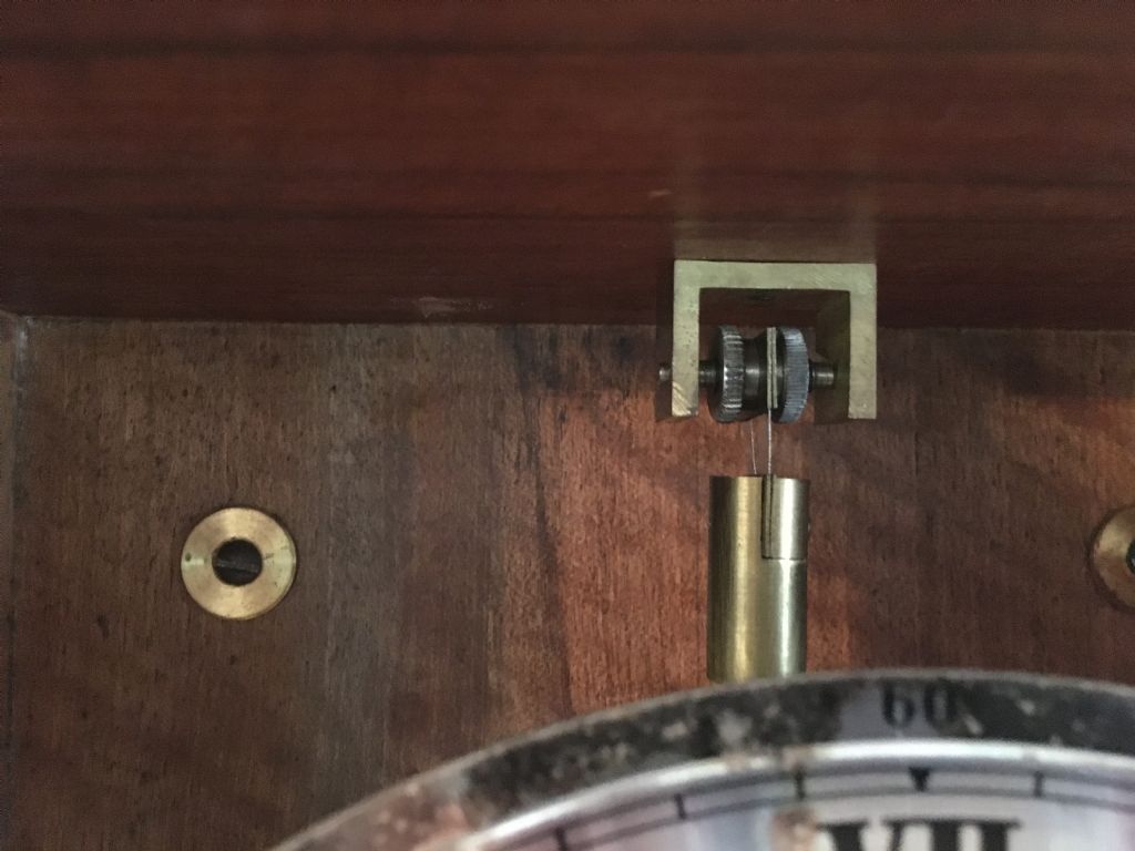

      I inherited an electromagnetic clock from my Grandfather in the mid 2000s when his wife died. The clock had not worked for ~15 years and had suffered in transit to South Africa. I replaced the pendulum suspension and with new batteries it ran intermittently for a year or two. It hasn't worked for the last 10 years and I really want to get it running again.

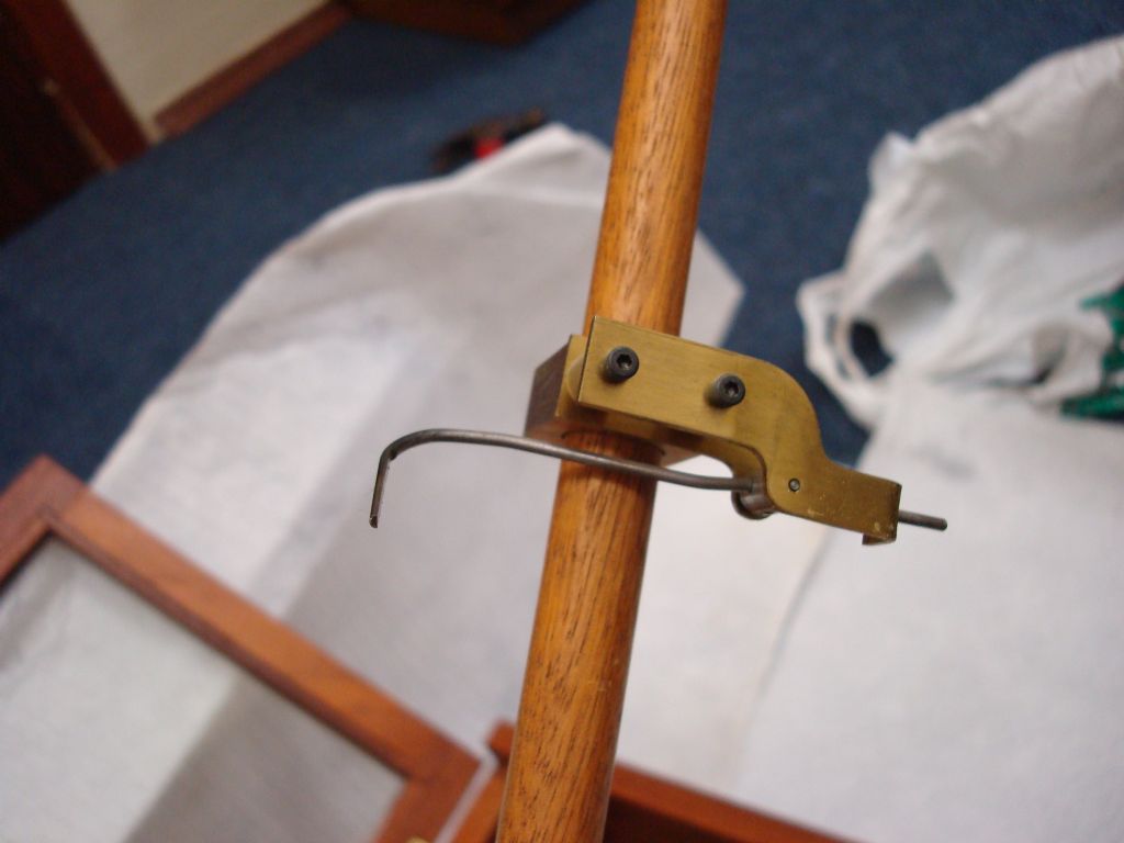

      The attached photographs show the Hipp type toggle which I believe is a "Scott Intermittent contact(?) design. My grandfather built the clock in the early 1980s, and was a Model Engineer fan, so I suspect it may have been to one of the magazines designs or a partial kit. I am looking for some documentation and / or drawings which could help get it set up correctly.

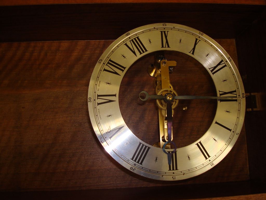

      I'll add some photographs of the full clock later today.

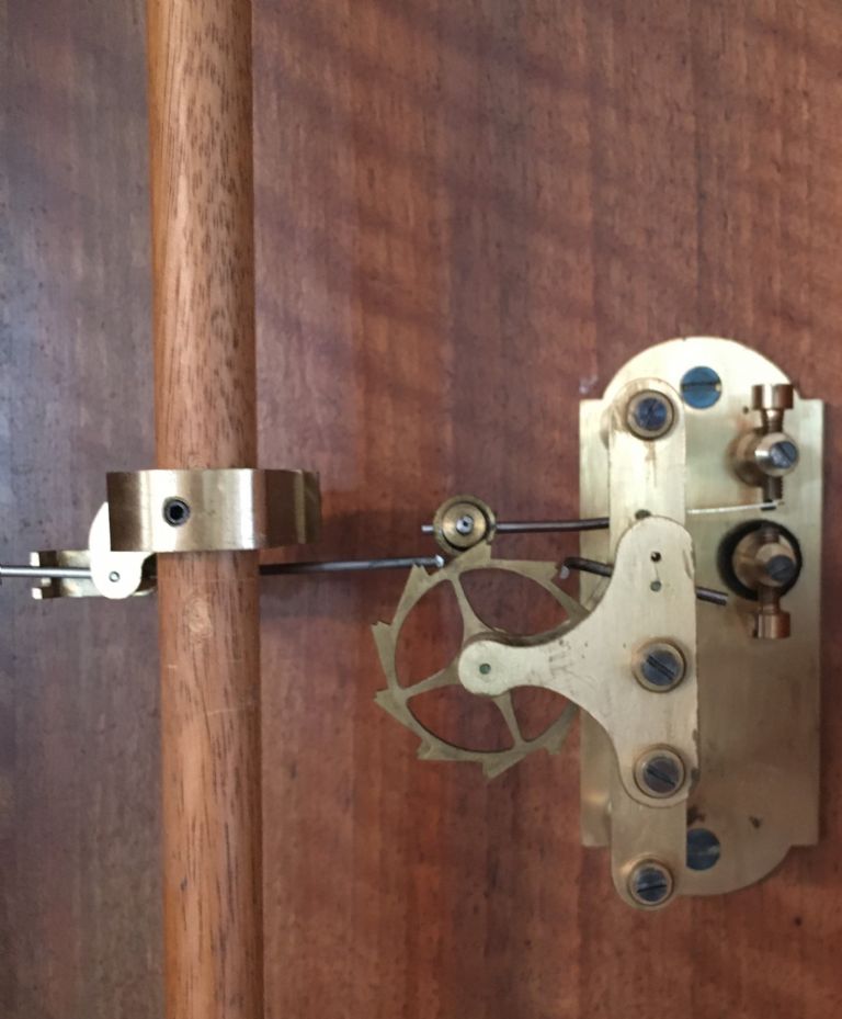

                Thank you, I had seen the link you suggest and an extended version of the same document as well. I hope to read through them over the weekend. I am not experienced with the terminology, but recognise that the design is not the traditional Hipp toggle design. I struggled to identify the correct description of the mechanism on the clock I have.
                The image below is the mechanism for switching on the electromagnet. (Correctly orientated this time). I hope that helps.
                Chris
                hipp type toggle (2).jpg .

                  For clarity … here is a good description of the Hipp Toggle : **LINK**
                  http://www.hvtesla.com/masters/po36_toggle.html
                  The normal Scott arrangement perhaps has more in common with the Synchronome, and the Gents’ Pul-syn-etic
                  … different details, but the same underlying principle.
                  Westbury seems to have devised a hybrid
                  Edited By Michael Gilligan on 04/10/2019 16:25:15
                  #431849
                    My apologies, Chris … The Scott arrangement is conceptually closer to Hipp’s toggle than I remembered blush
                    This is a nice summary description:
                    [quote]
                    Herbert Scott (1865-1943) was born in Bradford, Yorkshire, England. In 1902 he secured a patent for the mechanism used in this clock. A variation on Hipp's toggle, there are V notches at the tips of all escape wheel teeth, and a pivoted, L shaped trailer at the top of the pendulum rod. Following impulse, the trailer gathers the escape wheel teeth one at a time, thereby steadily advancing the hands. The pendulum amplitude eventually falls to a point where the trailer will no longer gather another tooth, and comes to rest in the V notch at a tooth tip. A projection on the trailer now is in line with the contact, and closes the circuit, thereby energizing the magnet, and providing impulse to the pendulum.
