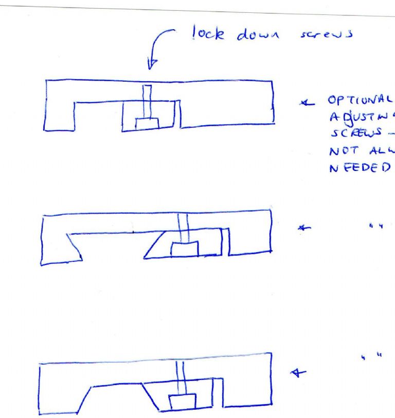

        Following my (successful, to me) centre height increasing experiment I am now thinking about making a more engineered solution.
        What I don't know is a reliable way of machining opposite sides of a block whilst ensuring both faces and features are exactly parallel to each other.
        The lathe in question is a Boxford, and the headstock locates on one prismatic and one flat shear. The height of the flat face has to be just right relative to the triangular groove if it is to sit properly. A method of machining male and female versions using only/mainly a vertical mill has defeated me so far.
        On the lash-up I showed on this thread,
        **LINK**  (its quite safe, its only a forum topic)
        I used a pair of standard Vee blocks and a length of ground bar. After machining the face of a 10.5" diameter disk I could not see daylight at any point across the face with ground straight edge so as crude as the rasing method was there was no sacrifice of accuracy.
        I was thinking of using aluminium for the headstock block, it will never see any wear so I cannot forsee it being a problem. Raising the tailstock can be done with a spacer plate interposed between the upper and lower castings.
        Any thoughts anyone?

                                Cut from solid / test pieces which are short replicas of male and female V's / (Or) one/two roller test pieces ..
                                Reference edge / reference plane .
                                Fabricated construction / loose pieces / gib strips / gib blocks / adjustable features .
                                Only one side of each V has to be precision / mate one + gib other .
                                MikeW

                                  Must admit I had not thought of that, it certainly reduces the precision require to make the blocks, Now I'm thinking, no gib strips, but still have the screws to push the faces into contact, then inject an epoxy of some type into the gap to make the whole thing into a solid entity.
                                  Overall I have high regard for Boxfords engineering and design, but one thing that does not impress me is the really marginal headstock to bed fixings. There are just two 3/8" Whit bolts with seriously restricted head access that are screwed upwards into the head casting I have never needed to get to the ones on my lathe but I have been told that its only possible to loosen/tighten them with the aid of specially cranked spanners.

                                      MICHAEL WILLIAMS
                                        @michaelwilliams41215
                                        Block gibs
